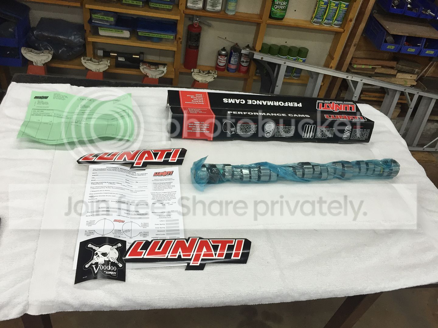

The Lunati custom-grind cam was in one of the boxes:

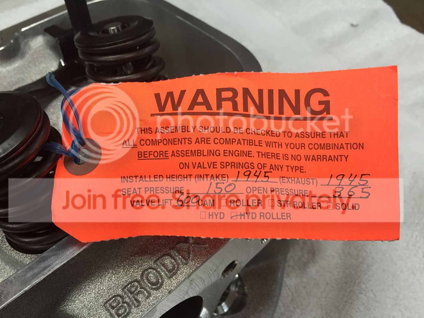

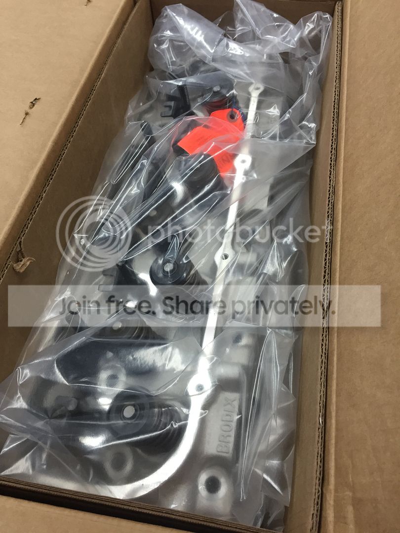

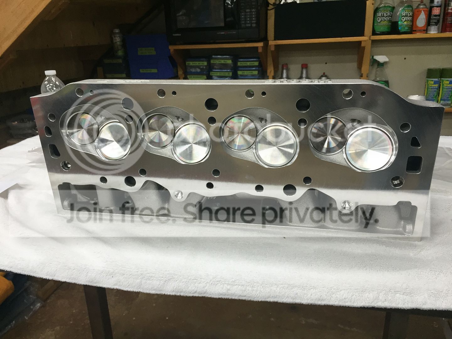

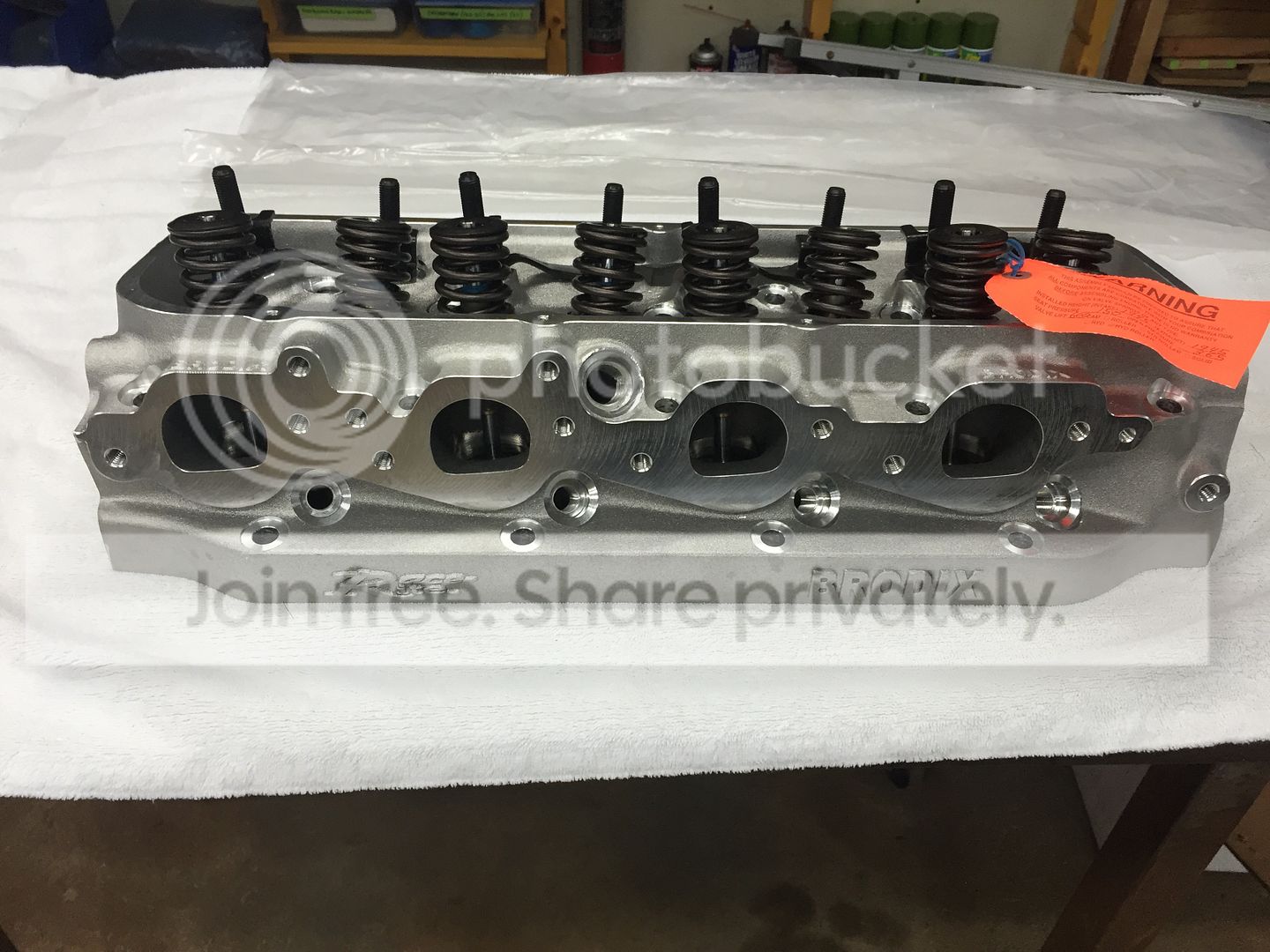

And those Brodix boxes that seemed SO heavy with a broken arm, actually didn't seem all that bad last night when I finally cut them open:
I'll probably still check everything myself, but this tag seems to indicate that .575" lift on my cam will be just fine with the valvetrain on these heads.

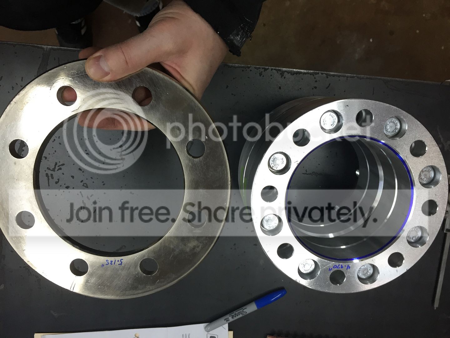

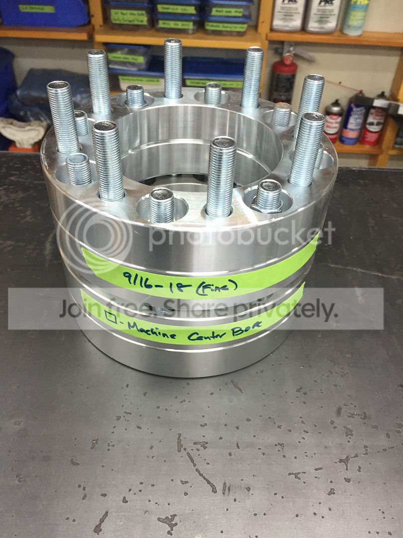

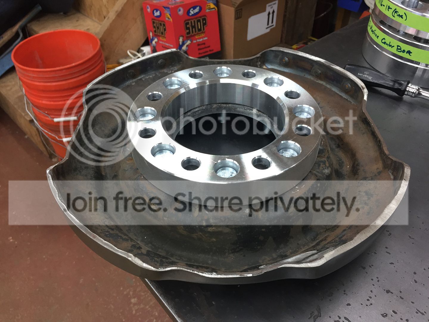

I also have a complete set of 4 aluminum wheel spacers (1.25") that will be used for the steel wheels & hubcaps project... unfortunately the centerbore is just a tad too small, so I'll have to get them machined larger before they will work correctly. "Custom is custom".... I recall someone used to always say that.

Greg, I have a couple of questions about those heads. Most aftermarket heads have a raised exhaust port (do those) and if they do I would highly suggest you install them on the block and recheck your header fitment. Second, those exhaust ports don't look like the factory ports so are your header pipes going to fit correctly? Last but not least, are those square or large oval port heads?
I thought I remembered you buying some new ARP head bolts? Make sure the heads don't require longer bolts as some aftermarket heads do require longer bolts. Also make sure you check for proper pushrod length as swapping heads can easily change the required length of pushrod as well as the installed height of the valves can cause different length pushrods to be needed.

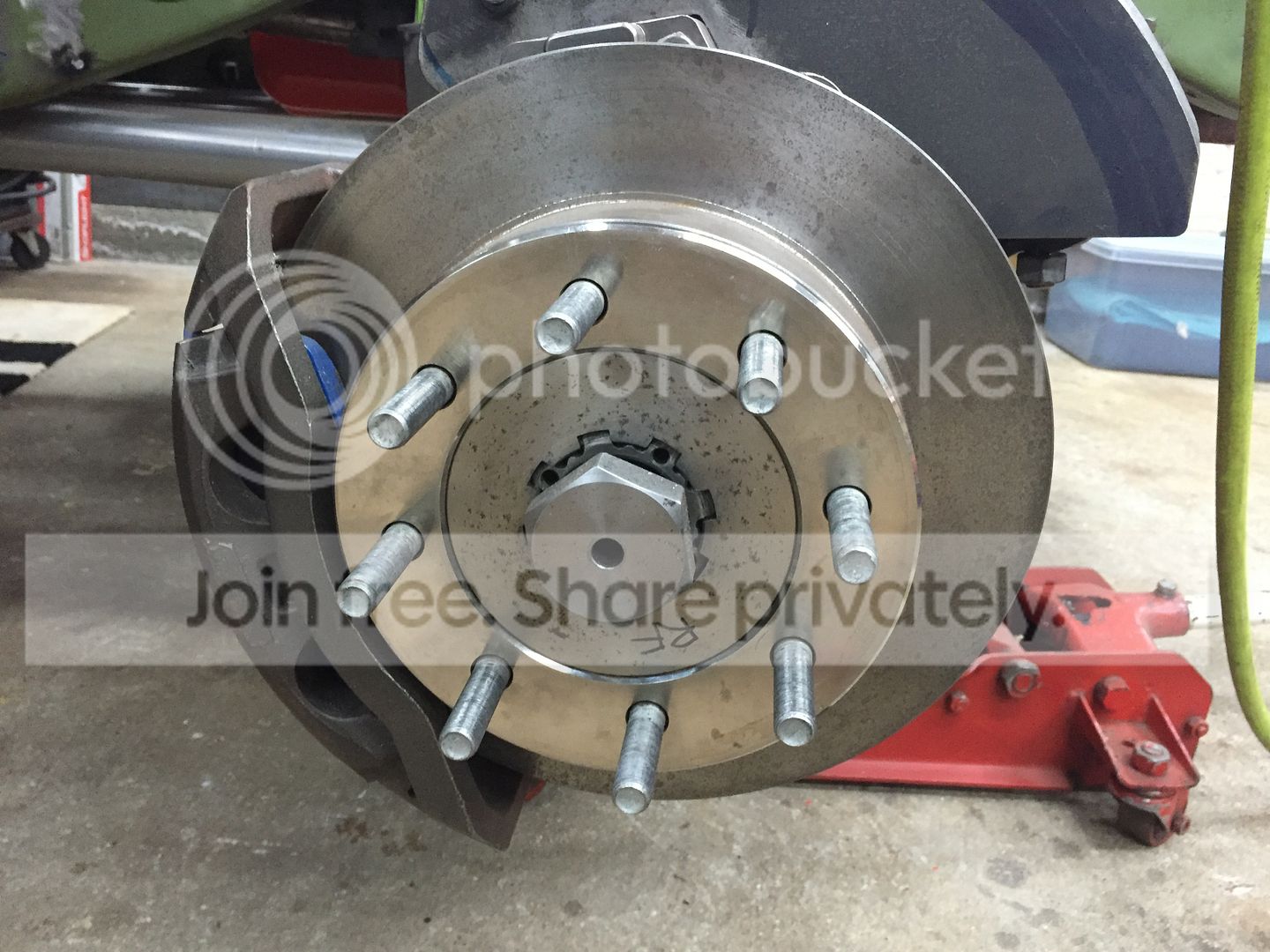

This just happens to be the exact dimensions of the new spacers which makes for one less problem to solve later on!I am one of the few people on the CK5 who doesn't want a choppy idle and loud exhaust.![]()
Greg I may have missed it but are those adapters hub centric or do you just need a bit more clearance to get them on the hubs?
