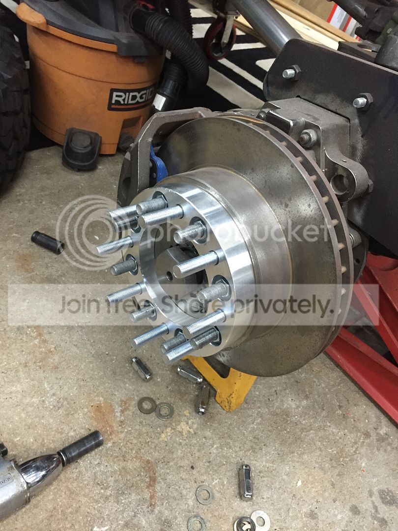

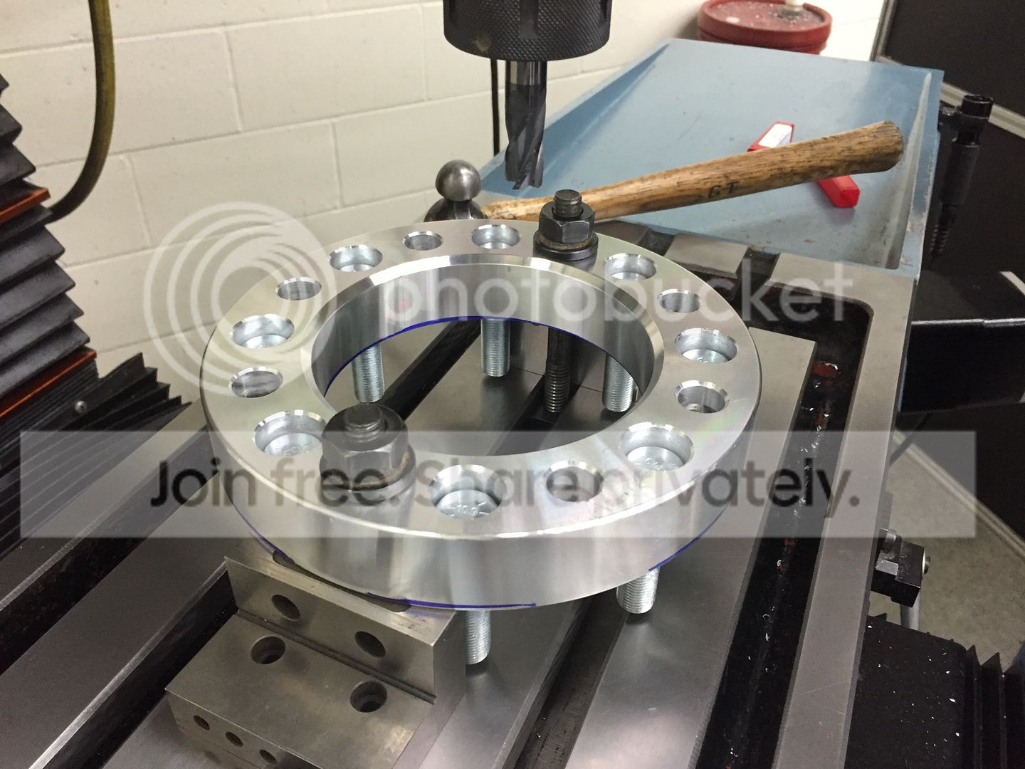

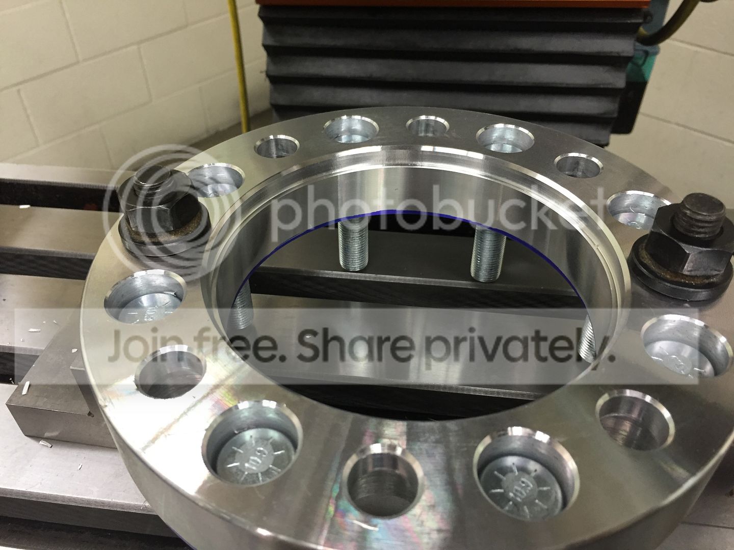

This week I also got some CNC time with a buddy of mine, and he helped me to open up the center bore to 5.125" on some wheel spacers that I needed for my Steel Wheels & Hubcaps project.
BEFORE:
4.970" bore....
DURING:
AFTER:
INSTALLED: :saweet:
-G
Those rings look a little familiar
Are they so you don't have to press out studs for rotor replacement? Thats why I machined the rings I made a long time ago. They look identical.
Rob, these just bolt onto the existing studs that are part of the eXaXt 8-Lug conversions I purchased.
For a rotor swap:
1. Disconnect the CTIS airline from the tire valve
2. Unbolt the wheel/tire
3. Unbolt the 1.25" adapter and remove more CTIS airlines
4. Unbolt the caliper and hang with bungee cord off to the side
5. Remove brake rotor....
Easy-peazy!! :haha:

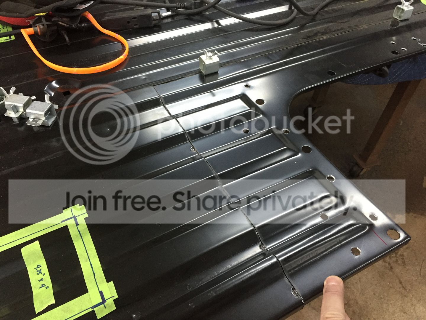

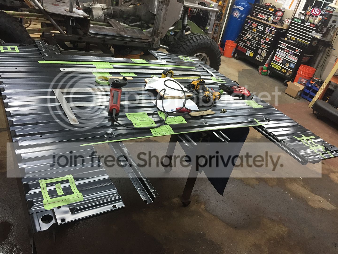

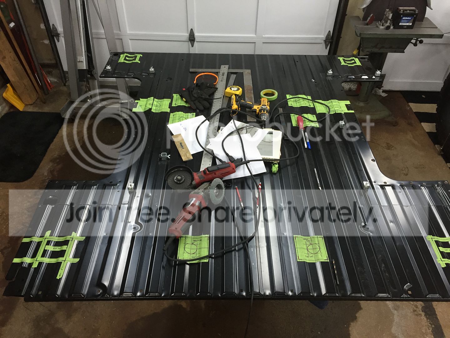

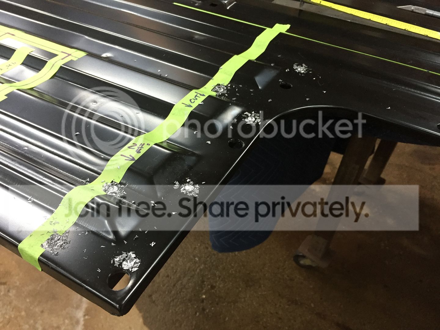

I've been looking at it for a few days....measuring a lot, and double-checking my work. But last night I had to just dig in and start carving up that new bedfloor or this project will never move forward.
Start by carefully drilling out about 50 spotwelds....
Then break out the 4-1/2" angle grinder and load it up with a fresh Walter disc. Cut slowly, and try not to breathe... and keep those cuts STRAIGHT!!!
After about 30 minutes of slow, deliberate work this is reward:

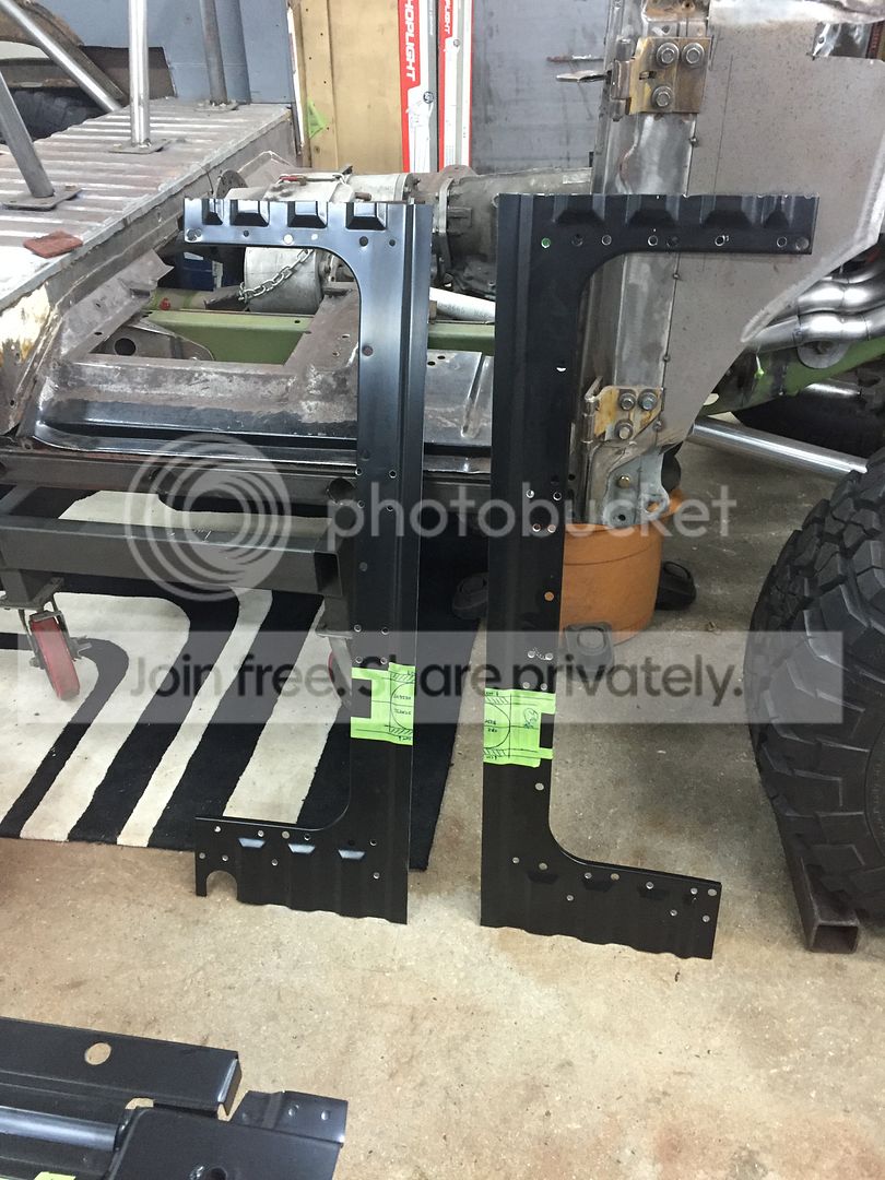

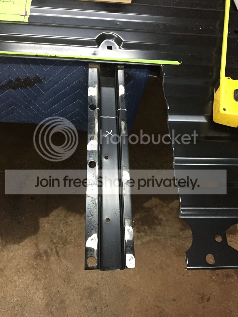

You can see the "offset" that was planned into those wheeltub cuts. There's an extra 3.5" of material on one side vs. the other... and that's what allows me to simply "flip" the part to the opposite side of the bedfloor as a perfect patch without doing a bunch of other filler-panel work (which would have been required if I just did a symmetrical cut on both sides of the wheeltub). The panels lifted off cleanly, and the only thing stopping them from dropping right back down into place was a rear cross-sill that was now inside the wheeltub instead of beside it.
Cut that back to match the other two cross-sills and then dropped the panels back into their new homes. The end result was just as I expected:
All of the convoluted sections lined up nicely and the gaps all the way around the patches were nice and even. It should be a simple matter to start tacking these back in place and the end-result should be just about impossible to notice.

Yep, now that I've got the parts flipped I can work on the last two cage mount points. There is a diagonal bar that runs from the horizontal bedside tube down to the top of the rockslider support. It sits just forward of the wheeltubs on both sides (now that they've been shifted!) so I can come up with a set of mounting plates for them.
As you've probably guessed, I need to go back into my rear cage and Sawzall a total of 6 tubes that were direct-welded to the frame / or rockslider areas. Otherwise, the cage won't come out, and I'll never get this new floor to drop down into position. :D
