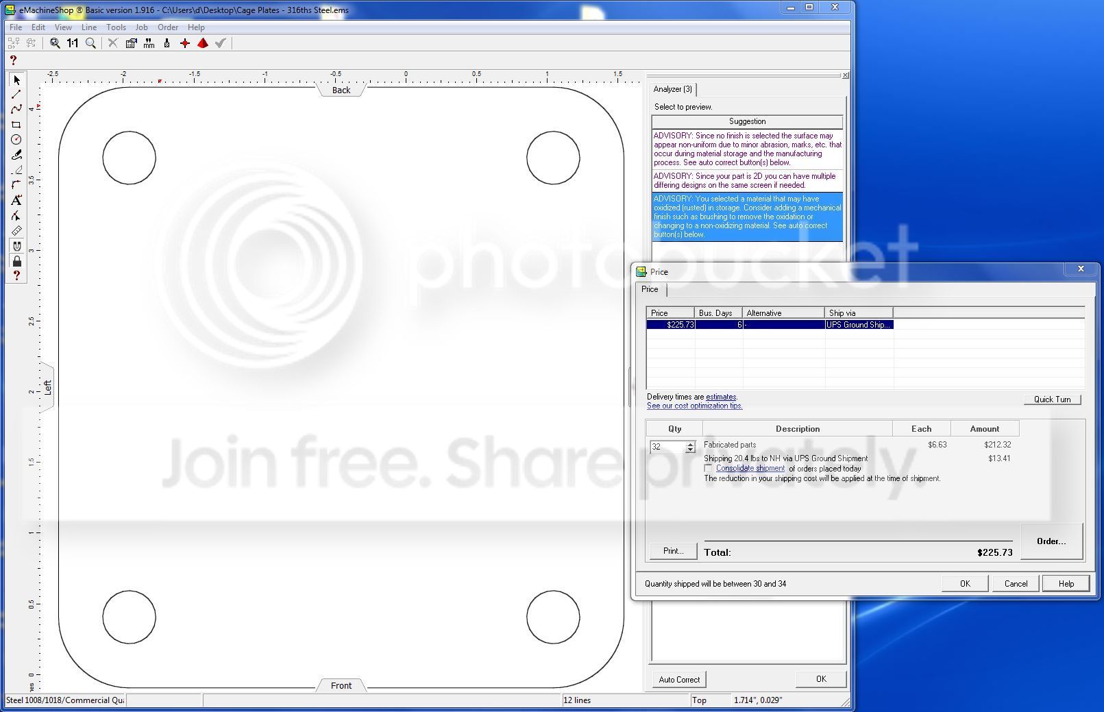

I'm trying to avoid plasma-cut parts because the through-holes tend to be poorly rendered and the edges aren't perfectly vertical...that's why I was leaning toward a waterjet or laser-cut part.
I checked out eMachineShop.com just for fun and downloaded their CAD software:
Pretty impressive pricing (per part) and quick turnaround time. I've never heard of anyone using them for parts, or what sort of quality the work really is.

I've got steel laser cut before and just made the holes a little undersized and I then drilled them out to get nicer holes. The laser cut holes make for easy pilot holes for a regular drill bit. The outside edges aren't helped by that but it's an option for you.
The water jet will get you what you need. The holes may require a drill to be sent through them. It's common for a water jet to start hole cuts just inside the hole and taper out to the desired diamter. It might be fine but possibly have a tie ridge in there.
Water jet time is usually $100 an hour as a loose frame of reference.
Ruffstuff and wfo don't have waterjets. I wouldn't think diy would either as they're very expensive and require a shit load of maintenance. Having worked on a top notch one it's roughly 4 hours of maintenance every 30 to 40 hours of run time if you're lucky.
Anyways you'll be happy with the outcome of the jet. Far superior finish than plasma. You can count on +/- .005".

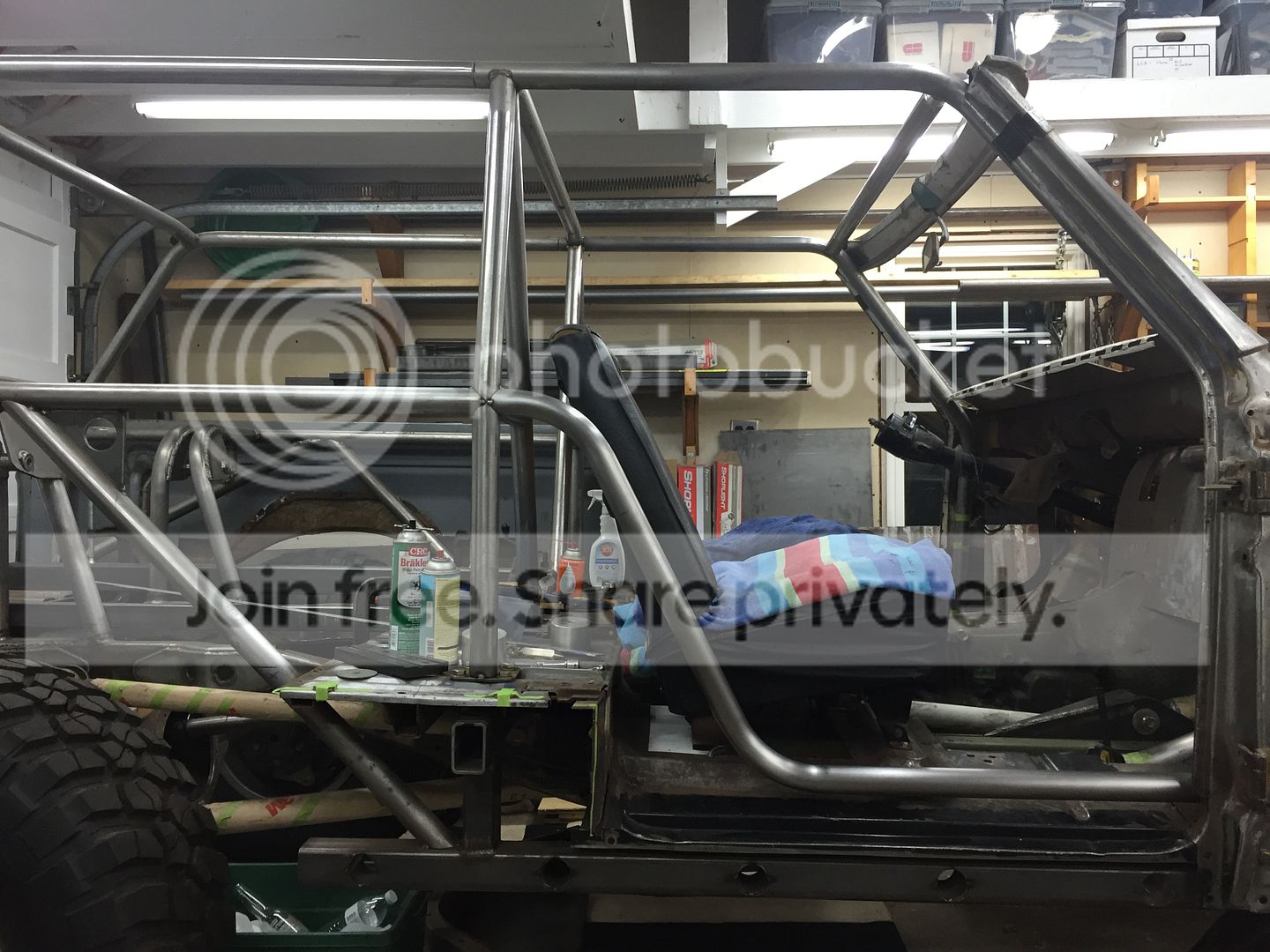

The ultimate strategy is to reuse the stock seats that came with the Blazer, but to completely rebuild them internally as a suspension seat using either MasterCraft or PRP's help to get that done. Not sure if they are willing to build their webbing into an OEM seat, or if I'll need to just buy a set of their seats and cut them all apart to get the stuff I need? :thinking: Either way, I want the external appearance to be "stock". I'd been thinking about adding some door bars for a while as a way to stiffen up the area between the A-pillar and B-pillars, and to give me a simpler way to create tubular seat mounts underneath. Putting the original seats back in let me see the exact fit, seatback angle, etc and would allow me to plan for a door bar that would follow some of those "lines" visually so that they whole design seemed intentional. :waytogo:
Quick templating of the idea with framing square and 3M Green Tape:

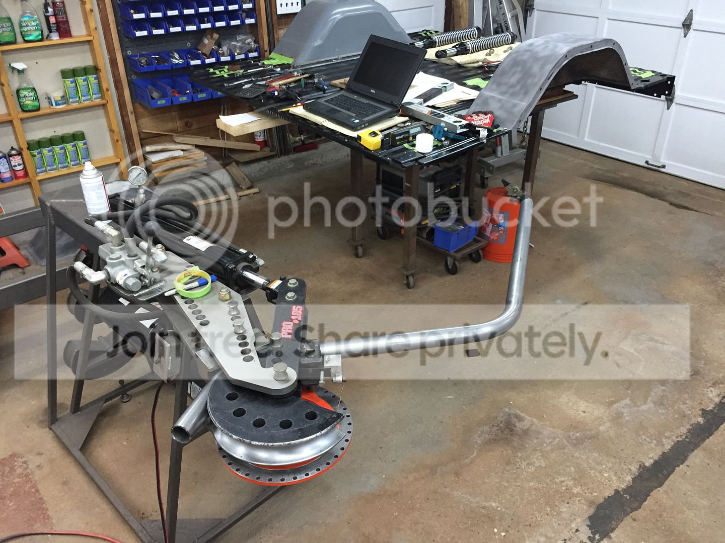

Remember this thing? It's been a while since it's seen the light of day... been hiding under a tarp for most of the winter:

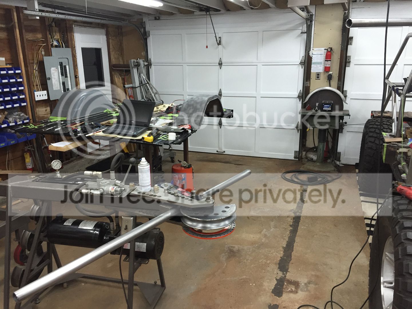

Transferred the measurements into BendTech PRO (which almost feels like cheating!) and cut a perfect cut sheet and bend schedule for the part....

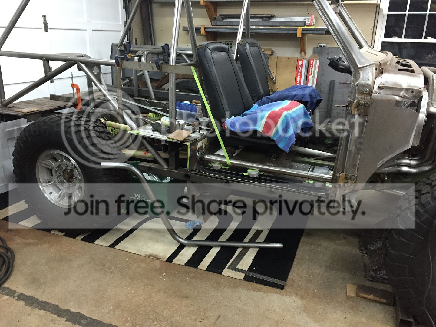

The Before (mock-up) VS. After (64" DOM Tube with two 63* offset bends):

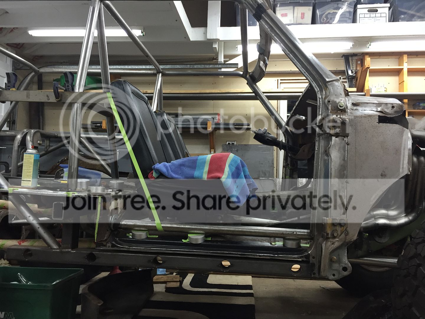

Notching was a little tricky, because I wanted to get the upper fishmouth right at the end of the bend. There was no simple way to clamp the part into my notcher but I eventually prevailed. The lower A-pillar notch was simpler since I had a long, straight section of tubing to work with and clamp for notching:

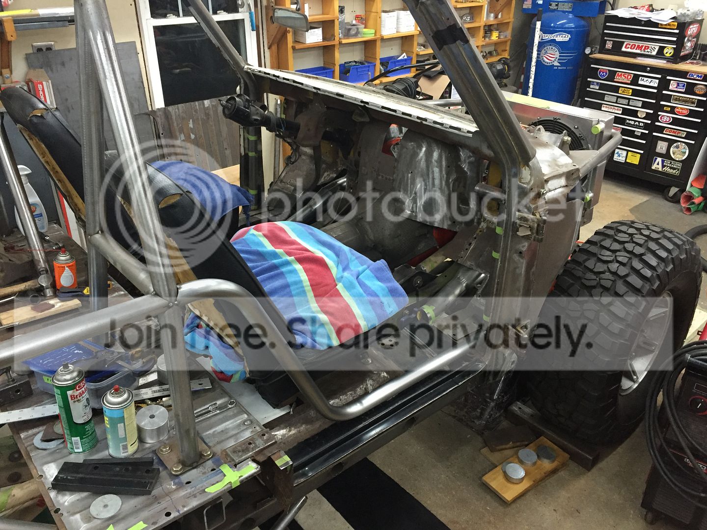

The final result is pretty sweet!! I set the tube up off the floor by 1" so that I could still get a cage plate (and small tubing stub) underneath it as well as carpeting when the time comes. It's a good height for catching debris (water bottles, etc) that might fall onto the floor during wheeling.... so it doesn't just roll right out the door opening when I'm running doorless. :waygoto:
