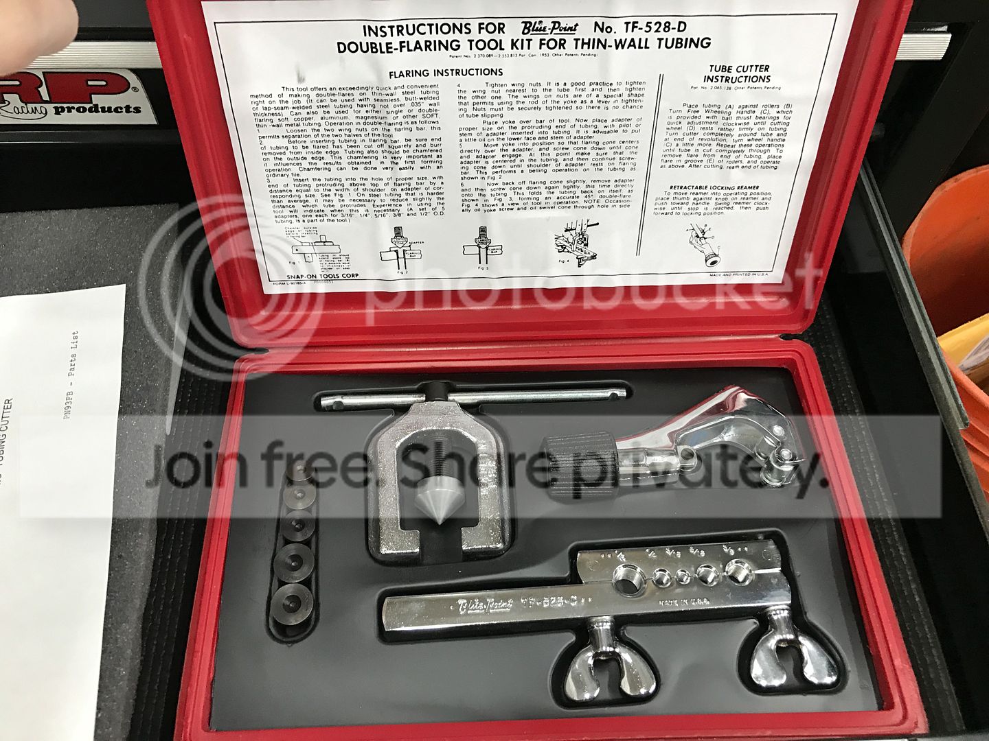

I have a flaring set that I bought many years ago from Snap-On, but honestly I don't know how well it works for the kinds of flares I will be doing:

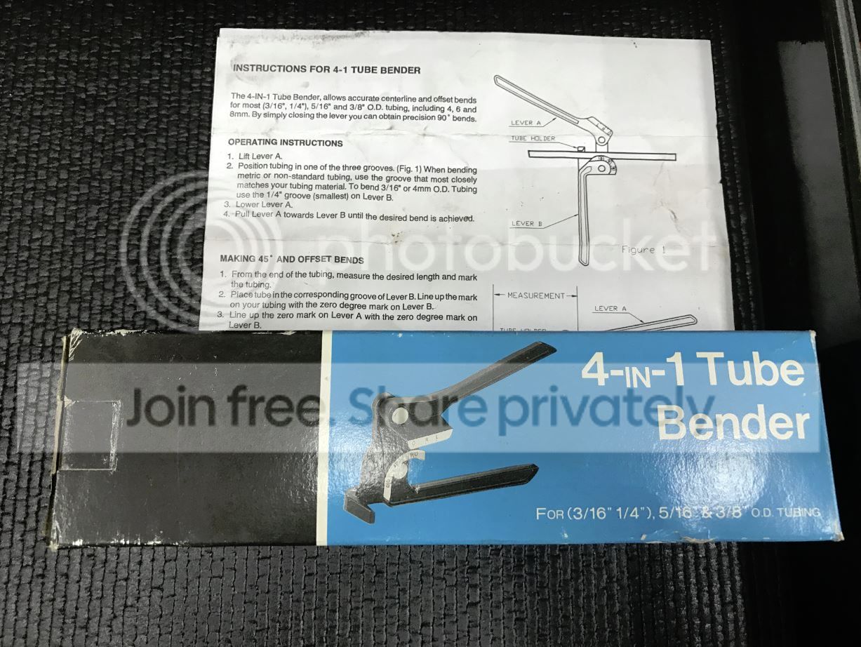

I also bought a tubing bender way back then, which looks to be very "Light Duty" and I'm not sure I'd trust it to do a quality job. I need to research and find something more appropriate:

I may be able to get away with my current flaring kit, but I may want to get something different depending on the fittings and materials I use (unknown unknowns)
Will also need things like Aluminum "soft jaws" for my bench vice for holding fittings, Aluminum wrench set, new tube bender, etc. To get quality bends and fitments of the hose ends.

Greg, the flaring tool you have should do the trick just fine. I would use all Earls hose and fittings, they have the black hose you want and you can get fitting in either aluminum or steel as well. I would also suggest you run 1/2" fuel feed line and if using a return system I would then run a 3/8" return line. I have bent stainless line before and it's not as bad as people make it out to be. The bender you have should also work. Keep in mind another "trick" is to use V pulleys of different sizes to help you make bends as well if needed.

I have had that same Snap On flare kit forever and it works great for AN stuff. The Fragola stuff is nice too, fwiw they have a pretty good selection of black fittings.
