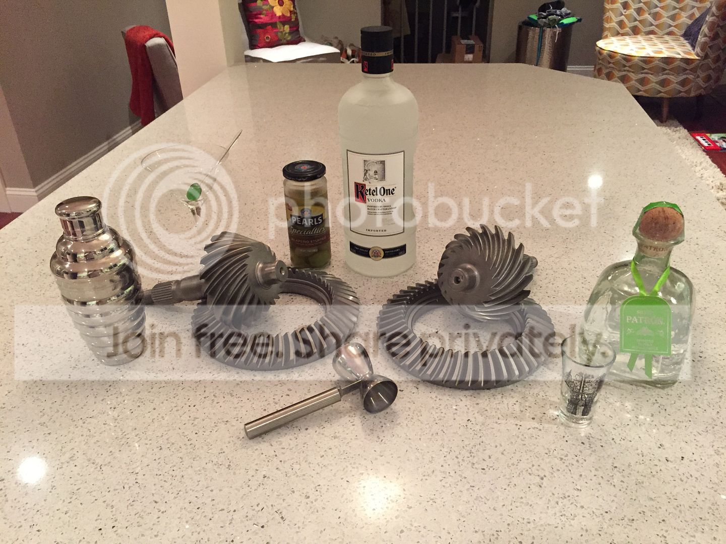

In any case (pun intended).... the parts have already shipped from Strange and I should have some cool new photos to share early next week!!! :waytogo:

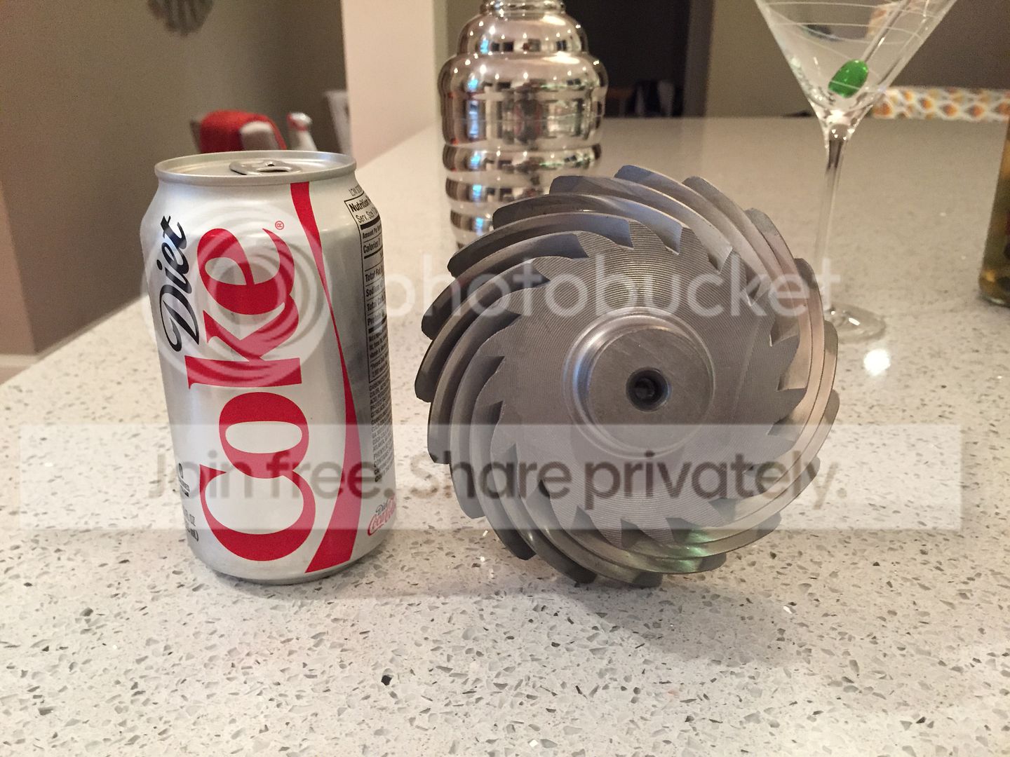

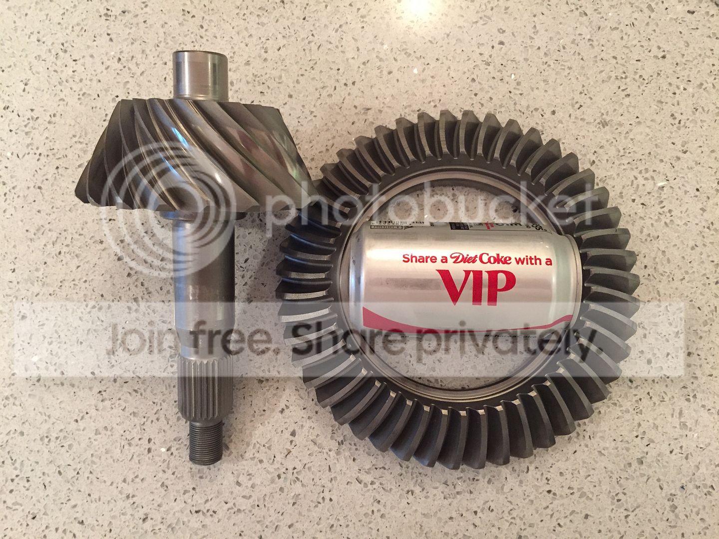

Dang that's a big ass pinion gear!
RIGHT???
It makes me smile to think about the GM 5.13 gearset and how tiny the pinion is by comparison..... I'll have identically deep gearing (actually just a tad deeper) with that enormous pinion adding loads of extra strength.
That's to say nothing about the fact that it actually has a bearing support on BOTH sides of it to help prevent deflection. :waytogo:
