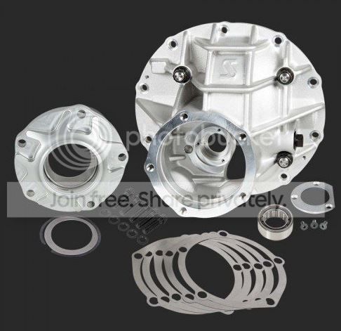

I can't really wait any longer, so it's time to spend some money and get more of the REAL parts into position so I can check clearances of the suspension / drivelines at all possible bump/droop combinations.
This is the one I'm gravitating towards:
STRANGE HD PRO ALUMINUM CASE KIT w/ 3.062" BORE (# P3200)
https://www.strangeengineering.net/...case-tapered-support-shims-tail-brg-ret.html/
This kit contains:
Bare Case: #N2300 (3.062" Bore)
Pinion Support: #N2322 (Tapered Bearing for 28-Spline)
Still Needs:
Install Completion Kit: #R3200ST (28-Spline)
https://www.strangeengineering.net/...th-28-spline-tapered-brg-pinion-support.html/
1350-Style Yoke: ??? Maybe this Chromoly one... :dunno:
https://www.strangeengineering.net/product/9-yoke-28-spline-1350-strange-chrome-moly.html/
And "Might As Well" throw in a cool set of HD Caps...
https://www.strangeengineering.net/product/hd-cap-kit-for-strange-1350-rear-end-yokes.html/
Seems like I'm pretty well on my way to getting the 3rd's built..... Final piece is a 31-Spline ARB.... or maybe that Yukon Air Locker that Shawn @supersize75k5 mentioned a few thousand posts ago....
