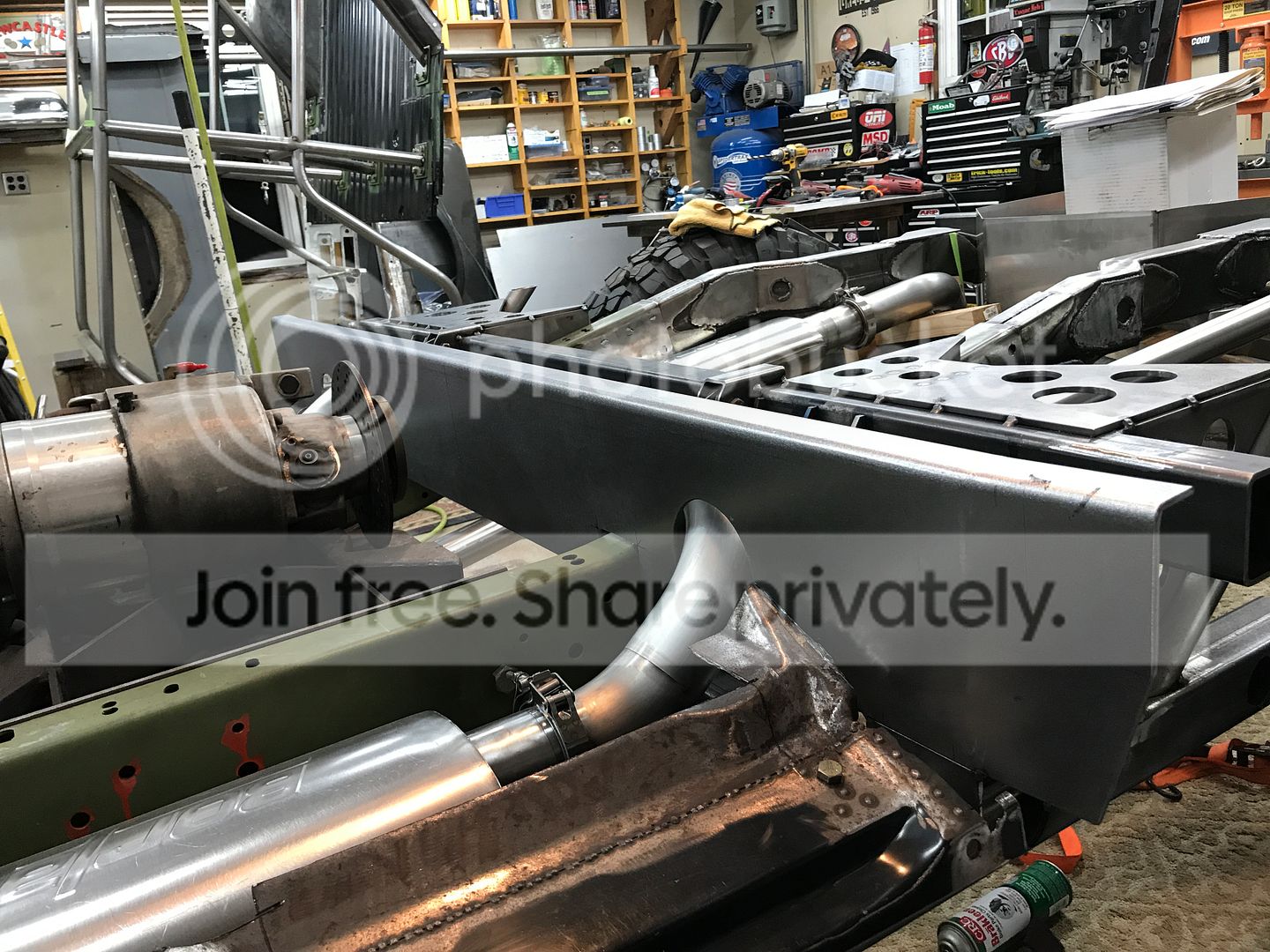

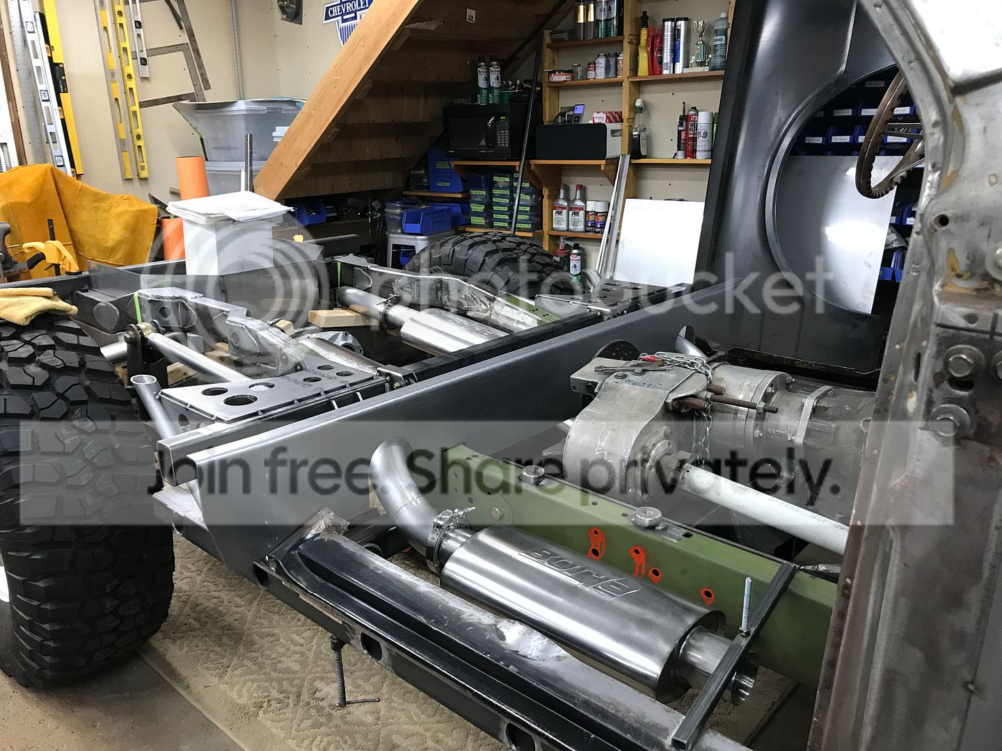

Dragged my Plasma Cutter out of the cobwebs and made a few curved cuts in the new step-up panel and cut a few frame clearance notches as well and it was time to drop it into place to see how it looked.
The result was very satisfying and really cleans up the look compared to the old, crusty part that had been there forever! :waytogo:
It was disturbing to discover that as the panel was lined-up with the established index marks, the door opening on the driver's side was a full 1/2" larger than the opening on the passenger side!!! :yikes: (you can see how the flange on the floor doesn't touch the step-up panel at all on this side)
HOLY DOOR GAPS BATMAN...
(perhaps I should have taken my own advice about bracing the doors, though I'm not sure exactly WHAT could have been braced since 95% of the area is completely missing!) :haha:

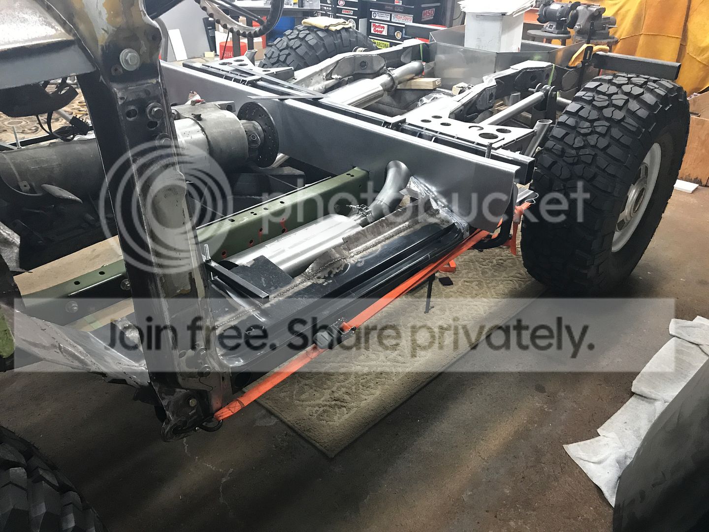

Fortunately, after some "quality time" spent pulling dimensions from side-to-side and comparing all the discrepancies it was clear that the problem was not particularly serious after all. The lower A-pillar had shifted out of position by roughly 1/4" and there were some measurement errors on the step-panel side as well.... nothing that a $2 ratchet strap couldn't fix...
"Door" gaps are now equal from side to side and nothing else appears tweaked. The door hings and header areas have identical angles on both sides, so there is no "twist" in the windshield frame / firewall structure.

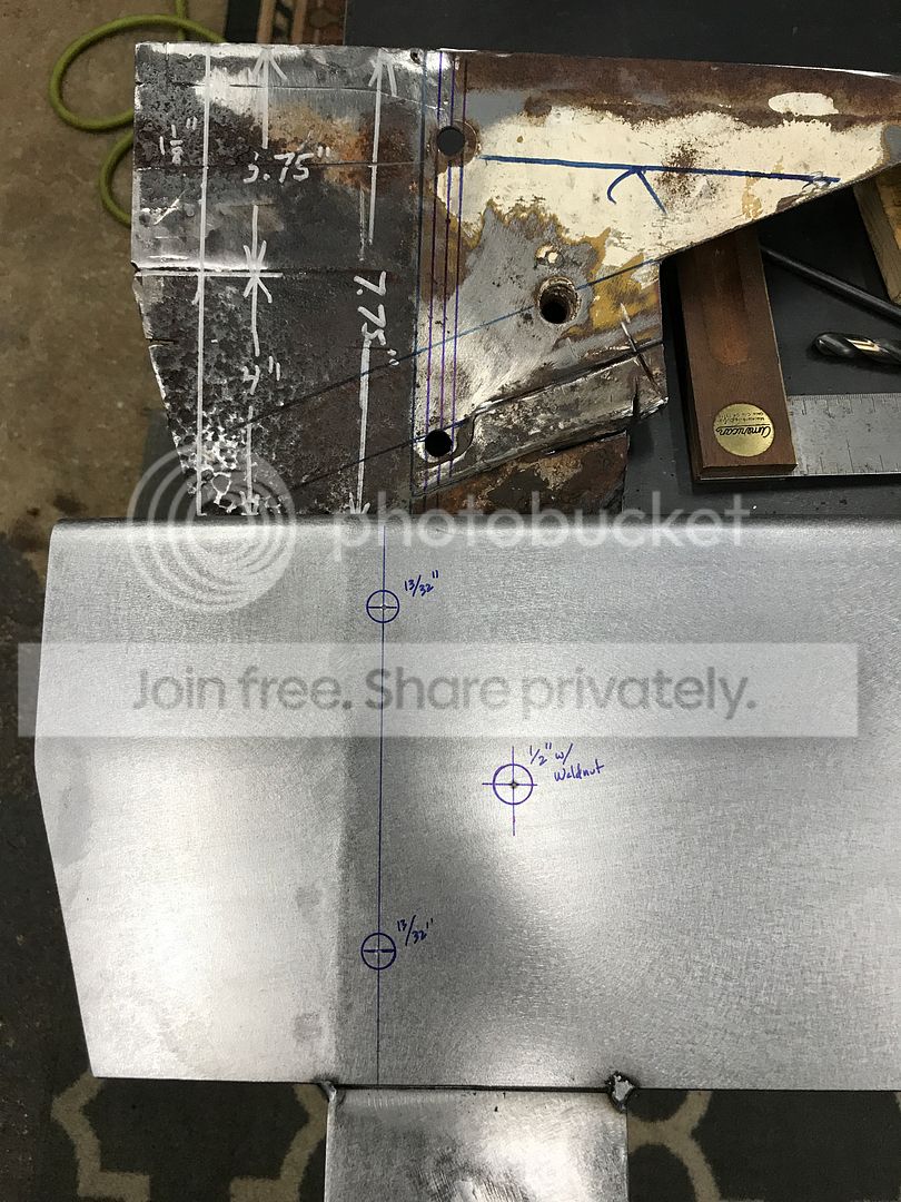

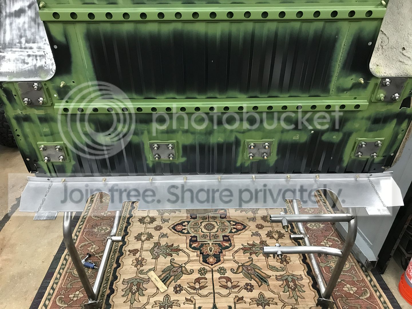

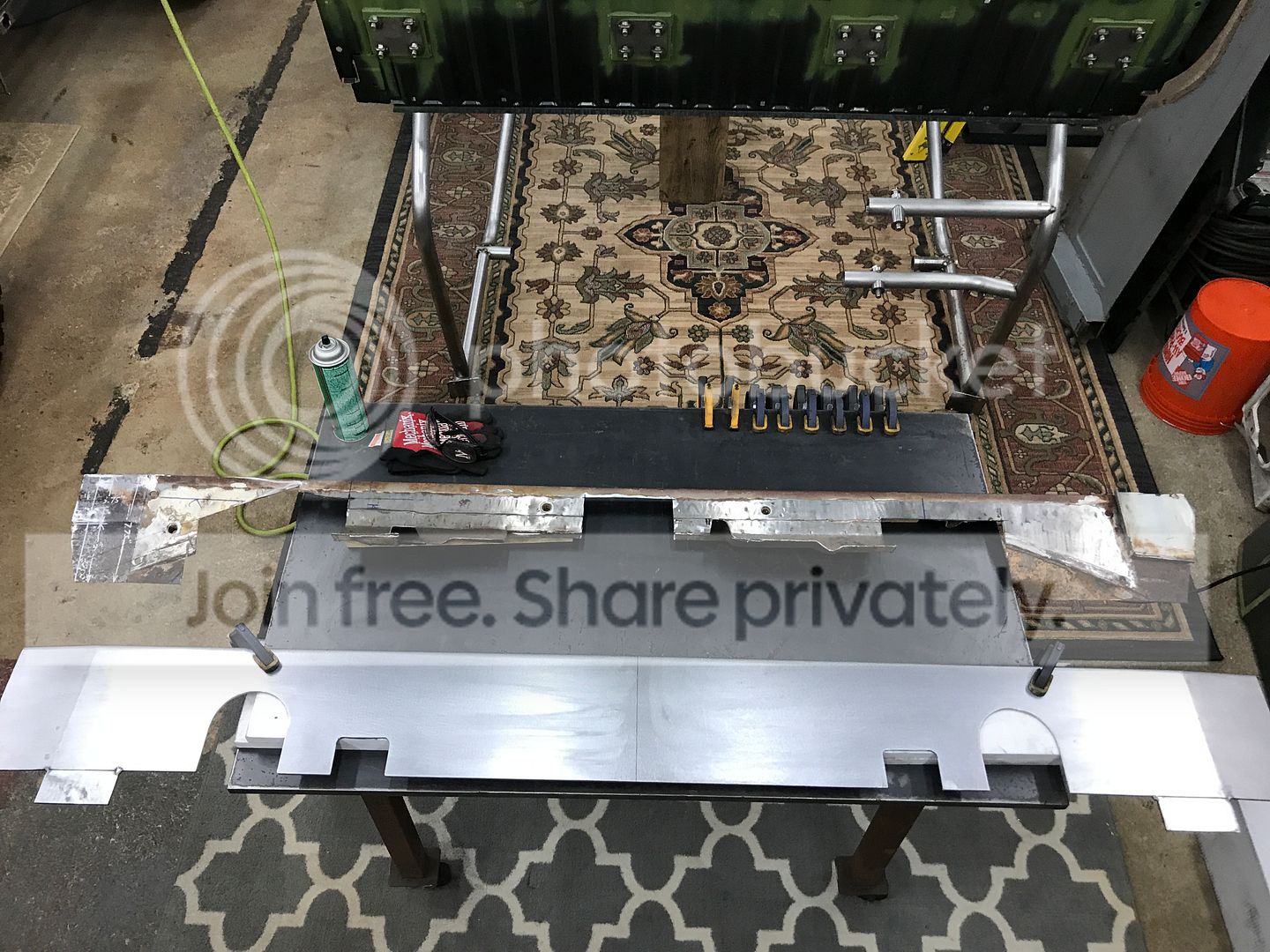

Slow and steady.....workin' the list and putting parts back together. The new step panel was carefully marked for all the through-holes (bedfloor mounts, seatbelt mounts, B-pillar through bolts)
Some details for the passenger side:

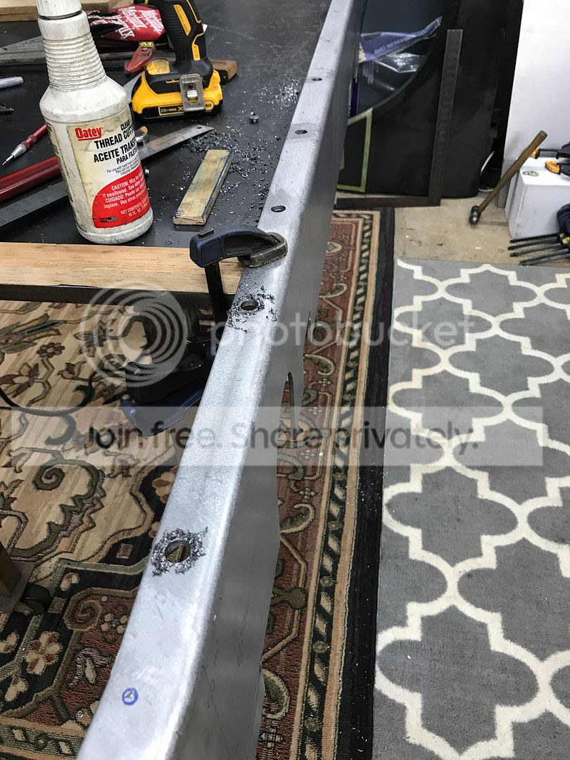

I was going to transfer the top flange mount dimensions from the original panel, but I figured it might just make more sense to mark the holes stamped in the reproduction panel instead:
It was pretty funny to consider that even from the factory, the holes were a full 1/2" diameter, but the carriage bolts themselves were only 5/16"-18 size. It's good to remind ourselves that GM wasn't building these trucks to a particularly tight set of tolerances. They were trucks, being built to do truck things.... and "close enough" was often good enough. :)
Once the top rail holes were all completed. It was joined to the bedfloor and fit beautifully. Couldn't bring myself to install 5/16" hardware, so I used 3/8" instead for a tighter fit.
