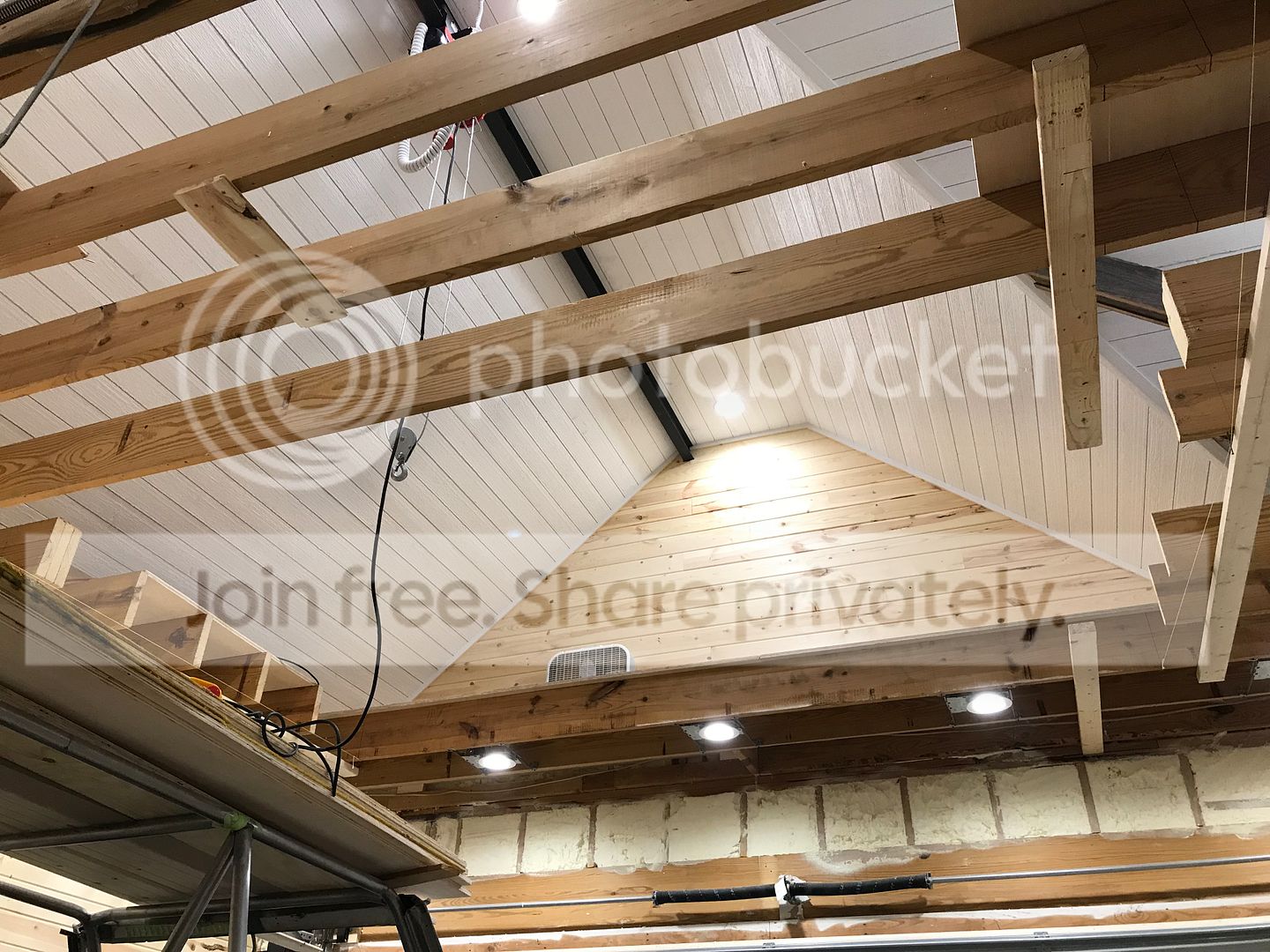

Yesterday marked a major inflection point in the project where it was finally time to cut-out the overhead joists and create a true vaulted ceiling over the 2-bay garage area.

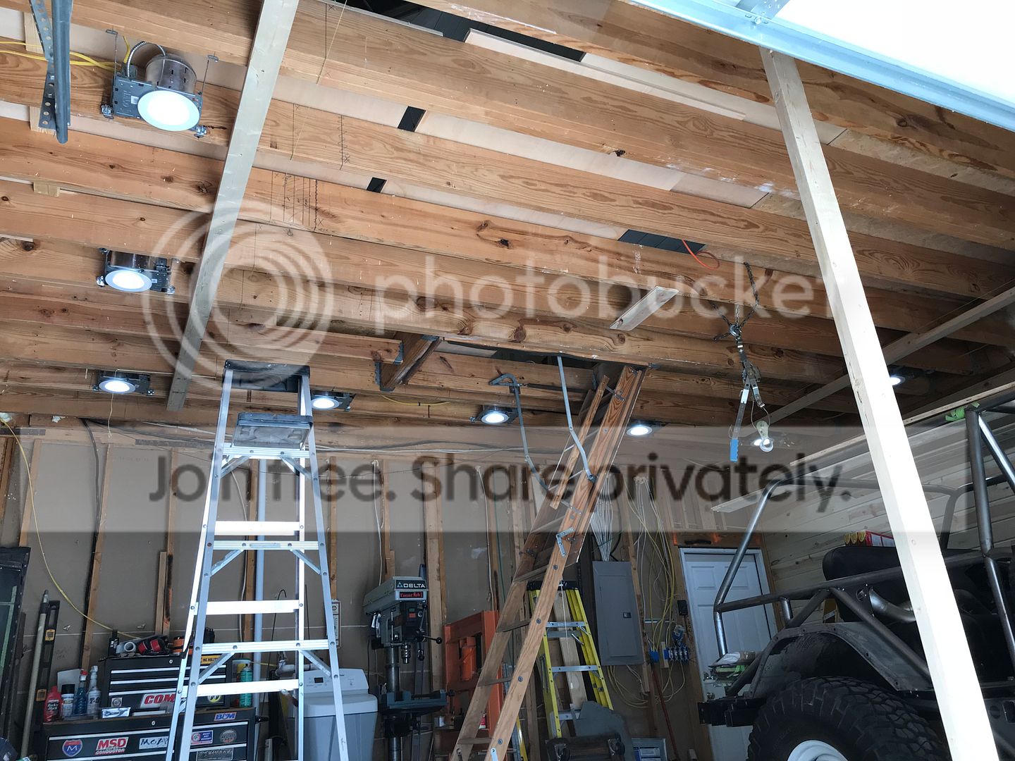

Morning "BEFORE" shot:

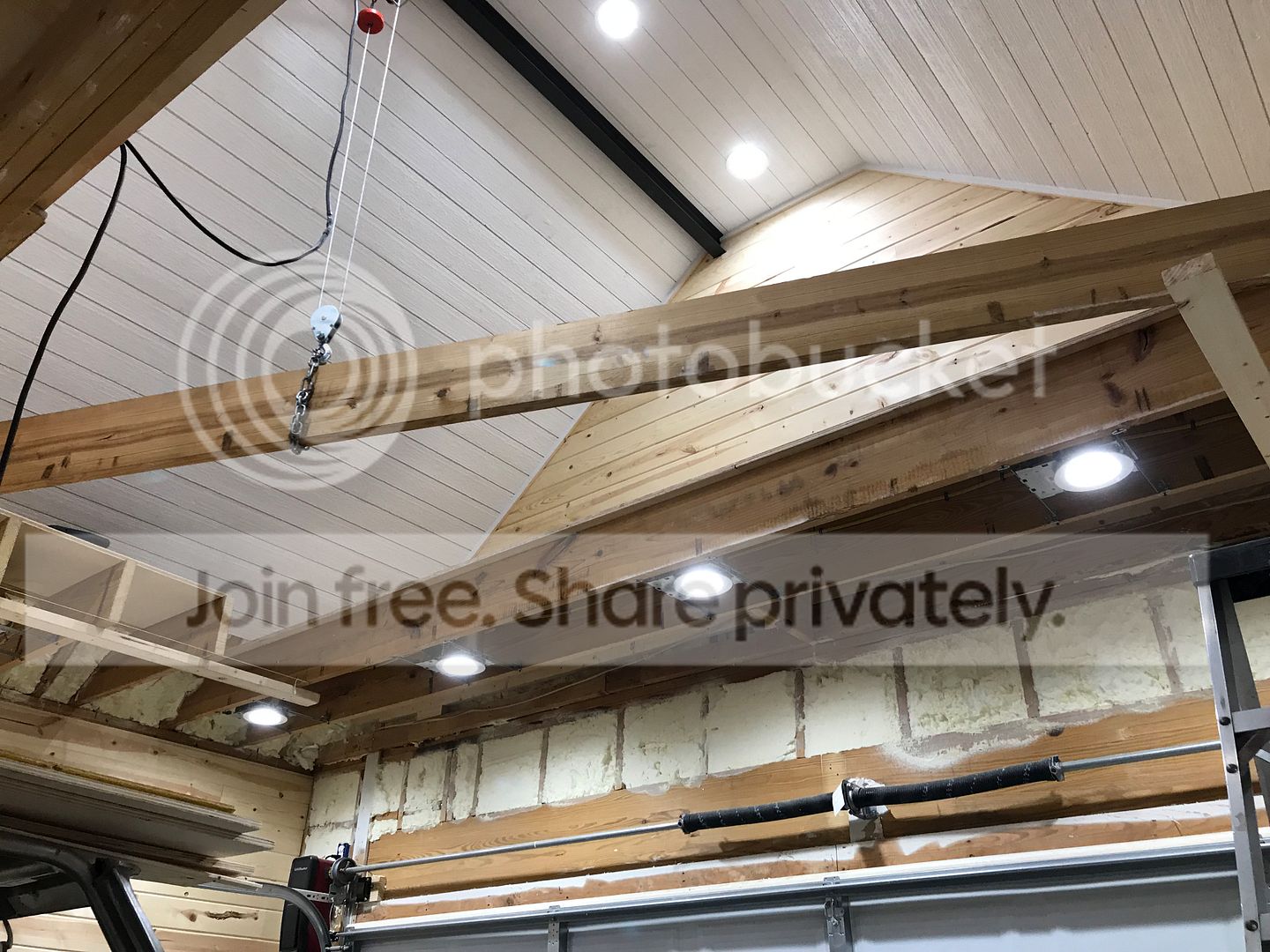

The new overhead hoist proved to be a Godsend... after marking the location for the cuts on either side, just hook up the hoist and put a little tension on the cable. Then make the end cuts.
Slightly off-center on the balance, but it was completely manageable to get the beams lowered safely...
Into the evening.... cutting beam after beam...
...and eventually had to take a break to remove the old rickety pull-down ladder. And by the time that was complete it was almost midnight.
So.... about 8 beams removed, and 1 to go! :waytogo: Then I can add the end-caps for all those cut stubs and put up the remaining plywood to create all the perimeter storage that is desperately needed. Getting rid of all those beams and plywood over the center of the space really lets the light spill down and brighten up with workshop.

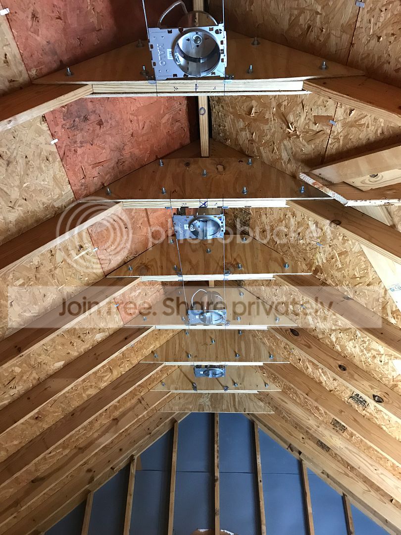

Anyway, this is what was done to secure the ridgebeam and create a strong upper cross-tie:
This was done prior to sprayfoam (obviously) so it's been a while...
-G
That makes sense. Was wondering because I did the same thing in my shop. But I was able to come down farther on the roof beams. I measured the ridge beam before I cut the ceiling open. Raised 1/4" when I cut it open. I guess I pulled to much between the walls when I shear panelled the trusses.
Yours not being trusses also helps.

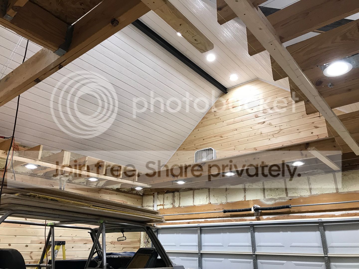

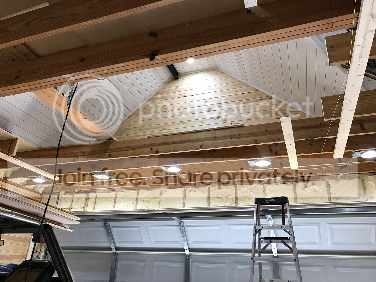

Really loving the open feel of the shop space now!!! Removed the final joist last night and can start capping all the ends and sistering up joists on either end of the opening... a bit of plywood sheathing and polyurethane in those upper areas and I'll be ready for a MASSIVE cleanup effort down below. Time to make this shop truly functional. :waytogo:
