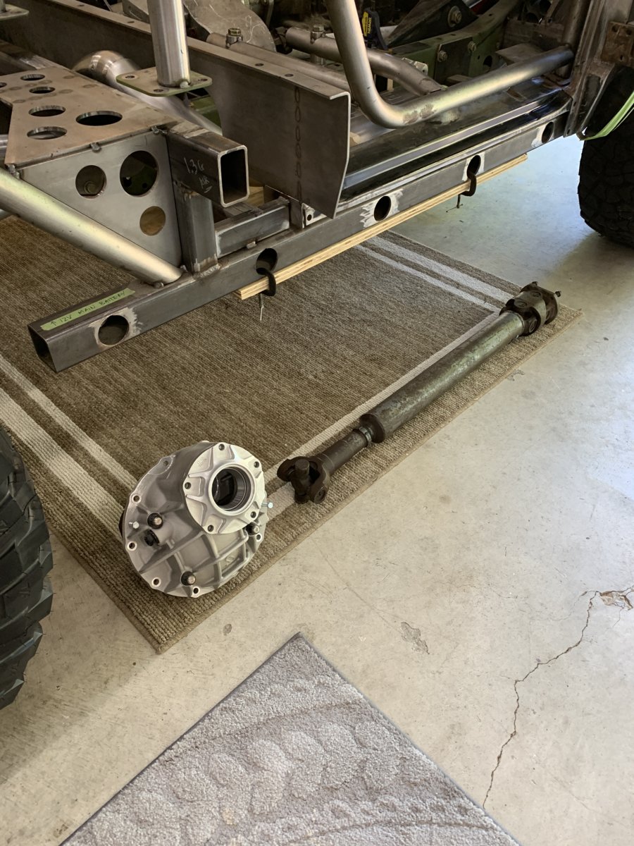

Simple goal was to install the Strange 3rd Member and rear driveshaft to determine clearances with the suspension at full-compression.
full
The first obvious issue was that there was no hole for the driveshaft to pass through the "step-up" panel area. After the final installation of the dual exhaust, it seemed like a good idea to open up the areas around those 3" tubes as well.... there's no real value in keeping everything super tight, as it's only going to trap heat anyway. After careful measurements, the hole center was determined and the trusty HyperTherm was powered up (for the first time in YEARS!) to make quick work of things.
(There are a couple of Blue Sharpies in this photo... for those of you who like that kind of thing...) :)
full

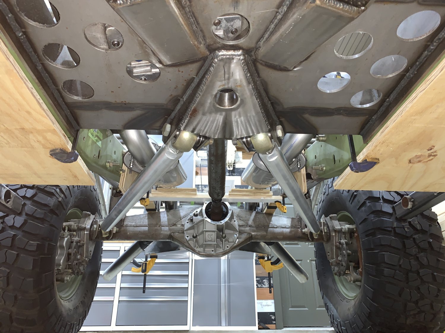

After several mock ups, the driveshaft was in place through the new passthrough hole, but the crossmember did not allow the other end of the driveshaft to swing all the way up into position. (This is the kind of thing you'd NEVER notice at normal ride height and would be a disaster on the first big landing!). This one was a bit trickier with the plasma cutter since the new exhaust was so close to the cutting area, so the heavy welding blanket was used to protect those nice finishes during the cutting process.
full
By midnight, and after at least a dozen installations.... the driveshaft was in place! (see photo below) Astute viewers will notice that the pinion support was removed to allow the driveshaft to fit. It's clear that the old driveline setup (396/TH350/NP205... and factory setback) put the output substantially further forward because the old driveshaft is WAY too long for this application now! :haha: This is a High-Angle Driveline CV shaft with integral parking brakes setup. It was pretty expensive (even back in 2003) and probably has less than 4000 total miles on it. So it's definitely going to get cleaned up, shortened and reused. Probably the simplest way will be to carefully cut the weld at the top of the tube just before it goes into the CV. A lathe would make that easy... but if the two parts can be separated with a cutoff wheel, maybe there is a local shop that can clean up the CV to give it a new factory surface to reassemble into a shortened main tube? :thinking: It would obviously need to be re-balanced but it seems like almost any decent driveline shop should be able to handle that part. Seems silly to ship this all the way to CA just to have Jesse take care of it.
@blazinzuk (Photo just for you. 100% Homer Bucket Free)
full
So the driveshaft is in, but now that it is... the idea of running a long, narrow 2 Gallon air tank between the mufflers is CLEARLY not going to work. There just isn't any clearance above the driveshaft at full-compression. Everything looks a lot easier when you build at "ride height". :dunno:
Moving the air tank (and probably using two small 1 gallon units) will probably put them in the rearmost corners on either side of the fuel tank... which was supposed to be the location for the Viair compressors... it's a real game of musical chairs right now, but ultimately it will get sorted out.

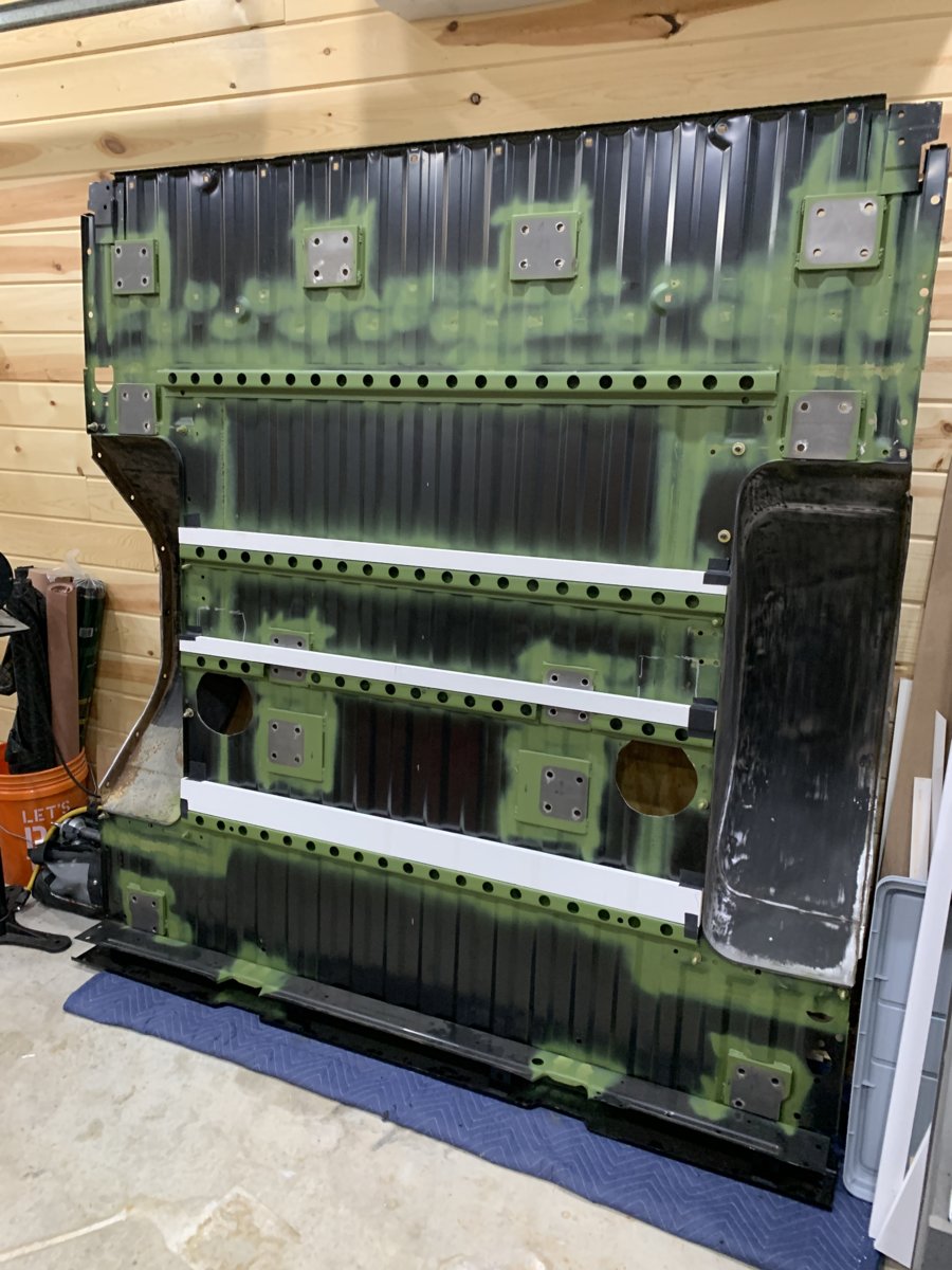

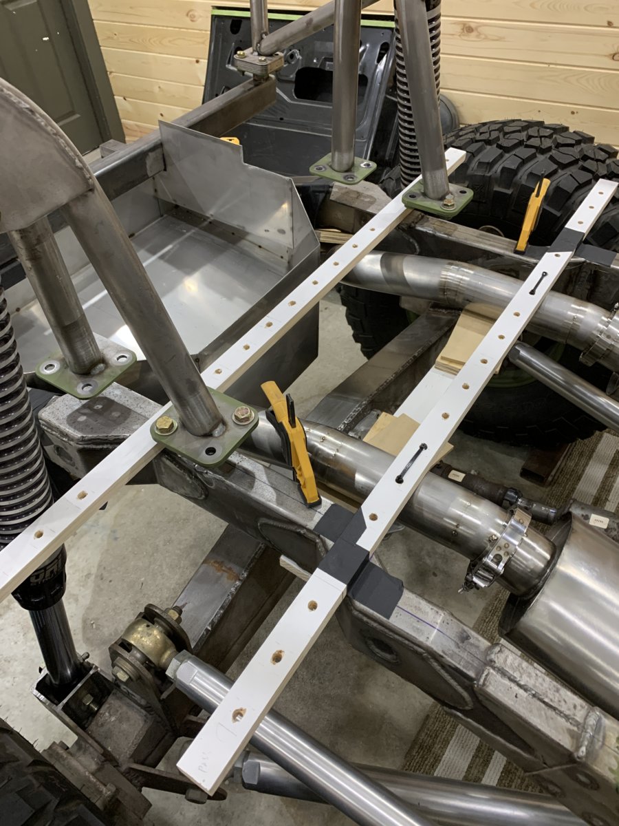

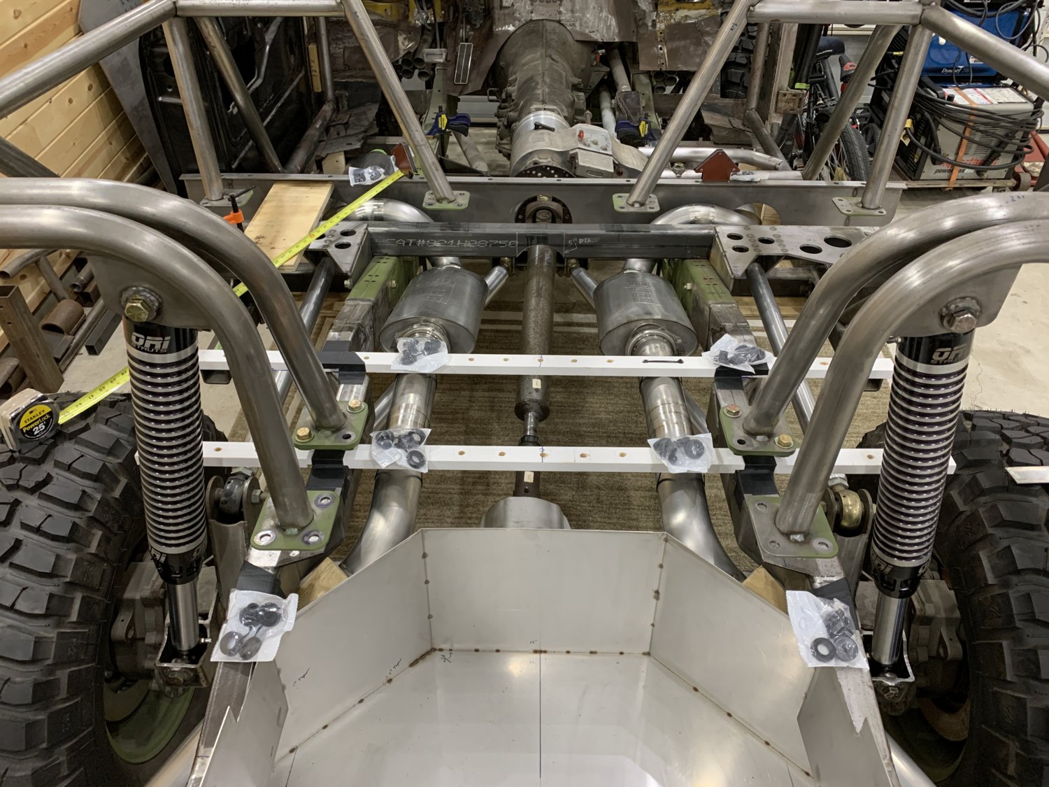

To hang the mufflers, it seemed that the "speedhole" areas in the original bedfloor would make for great anchor points for bushings and brackets. If only there were some way to identify where those would land relative to the frame, and WITHOUT reinstalling the entire bedfloor again.... :thinking:
Ultimately, the idea was this:
full
Make 49" strips of wood and transfer all of the hole positions to them. Then carefully drop them in place at the correct intervals on the frame. The idea is to weld-in a threaded washer in the holes that are closest (and most useful) for hangers...then a small segment of threaded rod creates a drop-hanger for the bushing to attach.
You can see how those holes work in this photo...
full
For now, the mufflers are just cinched-up with zipties but the plan looks like a workable one.
