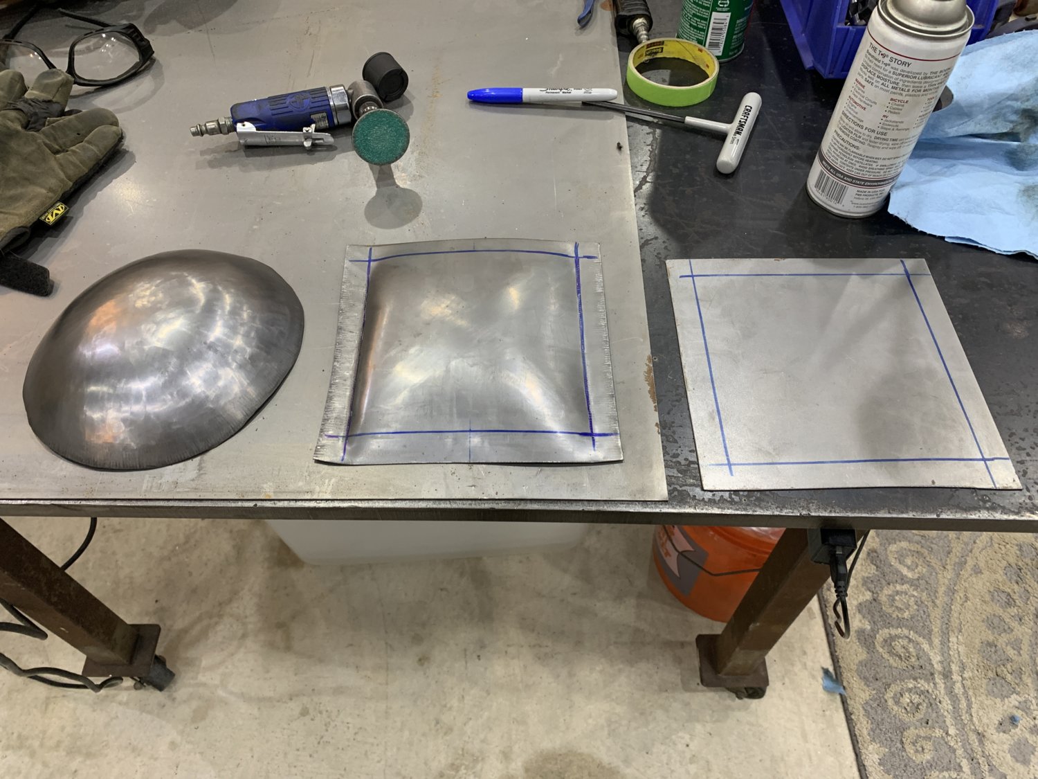

Small things made a difference.... Love having fresh, sharp blue markers and lots of them!!

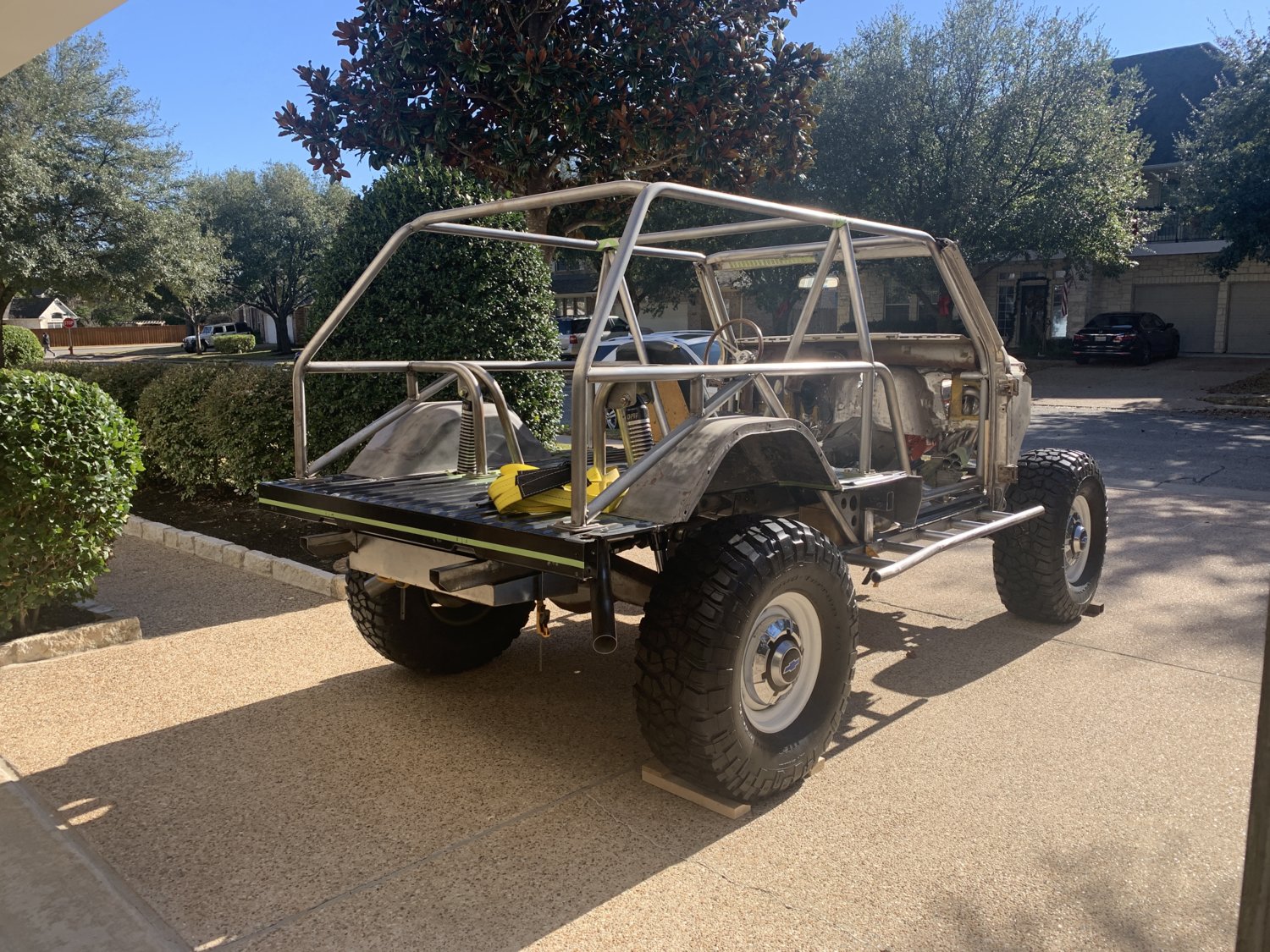

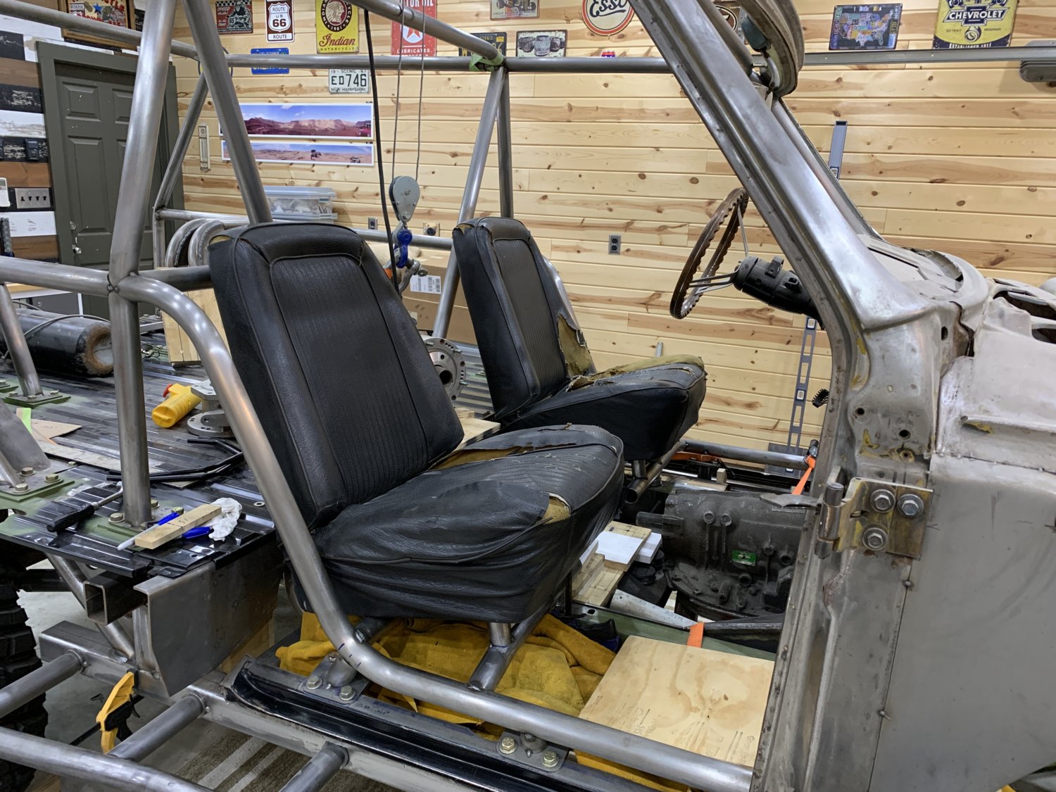

Seat track installation was completed a couple of days ago. Both the driver and passenger seats fit great... good height, setback and angle!

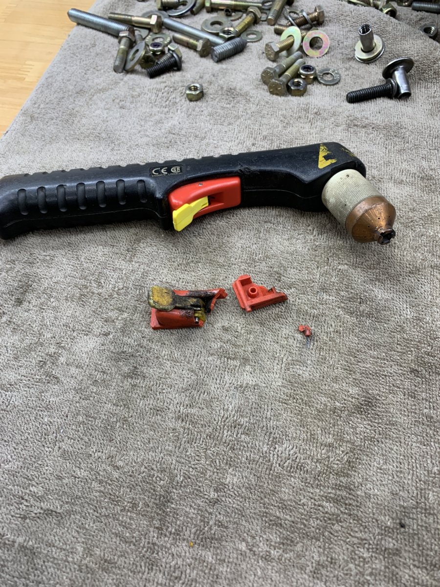

The plasma is rarely used, but the other day when it was actually needed the switch broke in half... fortunately, Hypertherm has great repair parts inventory and a new trigger was swapped in. Ready for another 20 years!

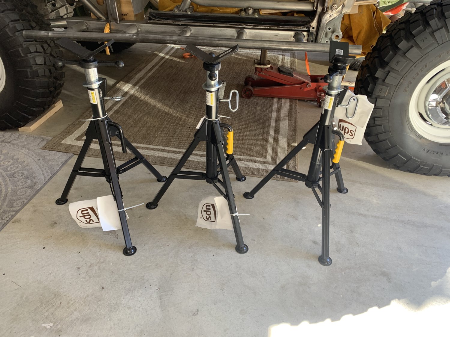

@K30Blazer (James Merrick) is always raving about these TALL jackstands (29" - 49" adjustment) so I tried to pick up a set of 4. Got 3 so far!!! LOL... it's a start.

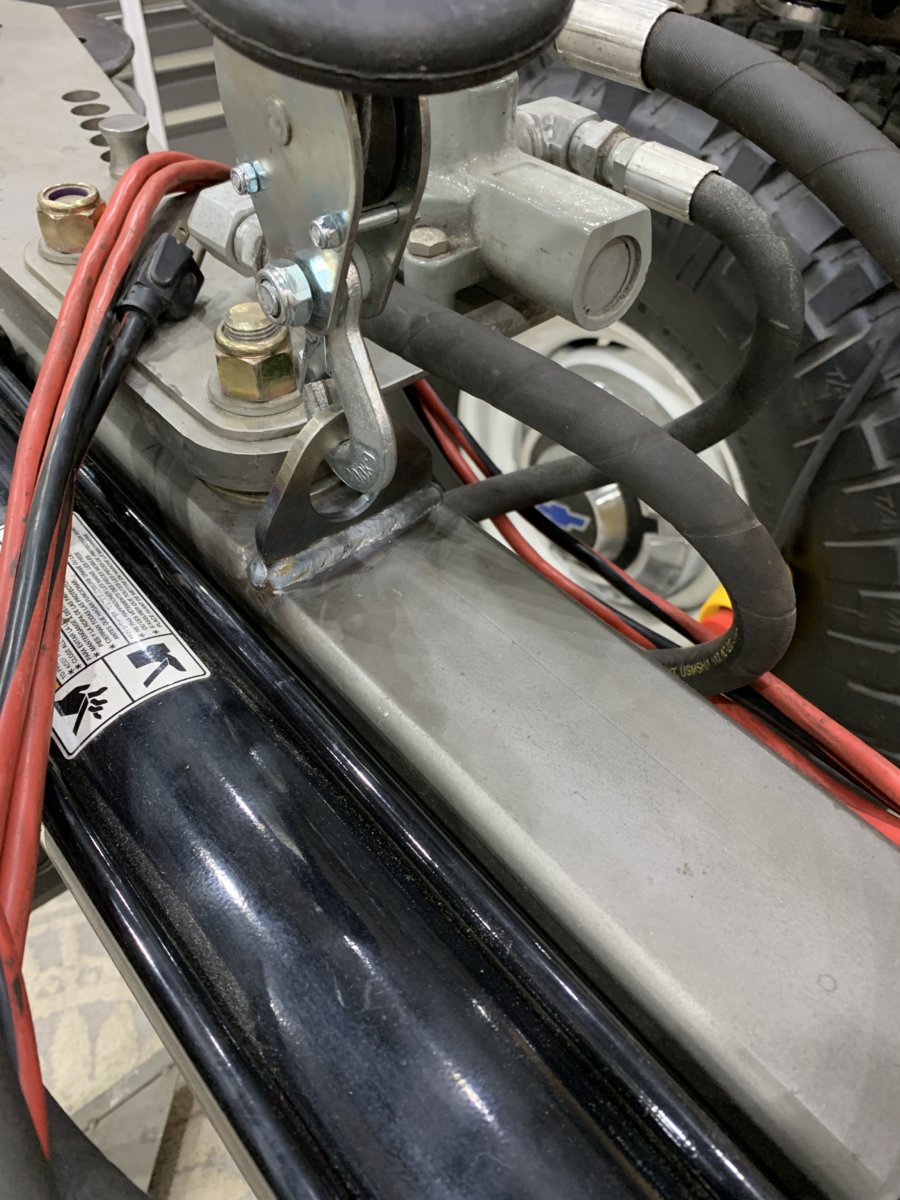

The tubing bender came down from the mezzanine briefly to bend a single tube for the seattrack project, but wasn't really "optimized" for hoisting (chains, bolts and ratchet-straps). Now it's got a nice beefy clevis welded at the exact balance-point necessary for a simple and safe lift into the rafters (or down to the workshop floor) whenever it's needed. That convenience can not be overstated....

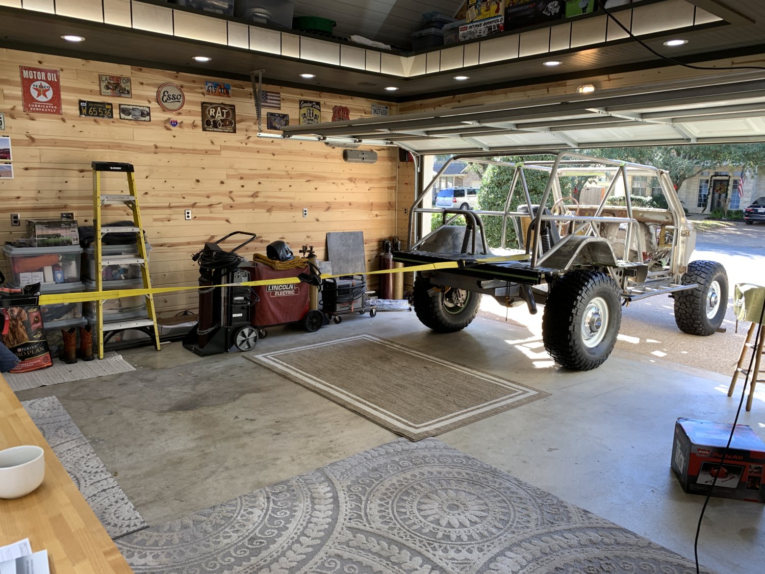

The importance of reclaiming that floorspace is to make room for a couple of new purchases that have been waiting for a long time.... and now feels like the right time to finally pull the trigger on an English Wheel

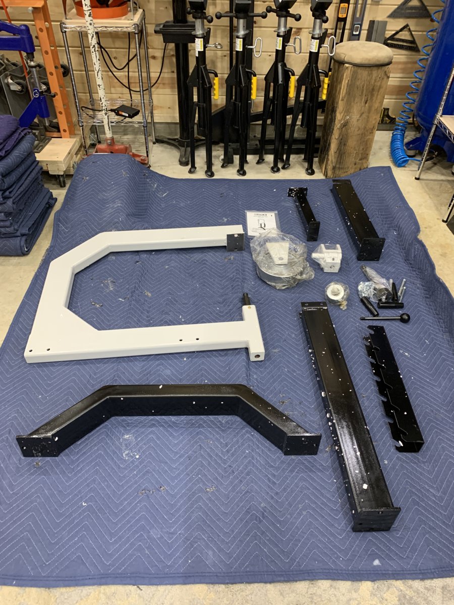

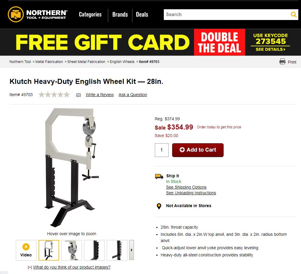

From the research, there seem to be a LOT of vendors selling the same exact model rebranded (as shown below)..... Baleigh, Dayton, Klutch & Woodward Fab all offer a 28" version like this one... same welded C-frame design, same base.. same die sets at prices from $400 - $1000+ Seems silly to spend extra money on a "brand name" here... since they are probably all built in the same Chinese factory. When you get into the really expensive $2500+ units there are more obvious differences, but that seems excessive in both cost, size and floor space.

Anyway, the English Wheel is the simpler decision... it's basically cheapest price, locally available for pickup (if possible) and done.
EDIT:

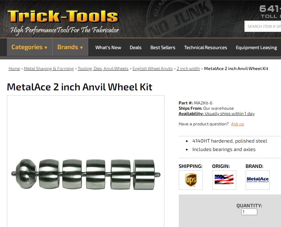

Almost... Ordered the Klutch English Wheel this morning from NorthernTool. Will pick up at the local store in Austin in about 7 days. Unfortunately, the extra anvil set (since the english wheel only comes with the upper wheel and a single lower anvil) is backordered until the end of January.
Not sure if this is going to work, but found a nice set of hardened MetalAce lower 2" anvils that can ship immediately. As you might expect... the anvils actually cost MORE than the tool itself!!!
The shafts on these may fit the holder...they may not. But once everything arrives it will be obvious what needs to be done to adapt them. MetalAce makes a LOT of add-on anvils... so it will be great if they turn out to be interchangeable. :waytogo: The finish quality and hardness also appears to be substantially better than the typical cheap sets out there.

Too many "moving" parts for my liking on those jack stands.
I can understand liking to be able to collapse them into a more sizable storage space but my life is more valuable than the extra space saved.
Crap. and one is missing the yellow grip!
Yep! That's not a great observation for a guy like me to make either.... OCD and all that.
The 4th jackstand is still in San Antonio (allegedly) where the other 3 were several days ago.... they all arrived together initially.
This model is now on backorder, so who knows what it's going to take to get a 4th one delivered.... or to get the manufacturer to ship me a yellow rubber grip to replace the one that's missing.

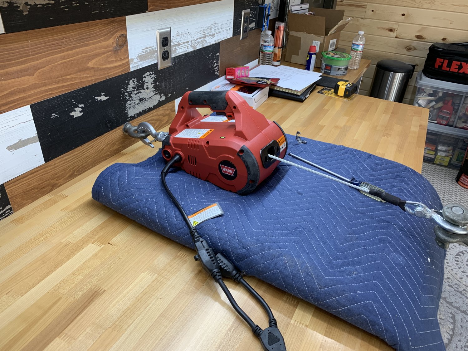

One of the items on my Christmas list this year was a simple WARN PullzAll so that the K5 could be safely rolled out into the driveway whenever the weather was nice.

The only disappointment (and a minor one) is that the PullzAll only has a 15-foot long cable... so once the truck got about halfway out the door, straps needed to be added in-line to get the truck fully out onto the driveway.

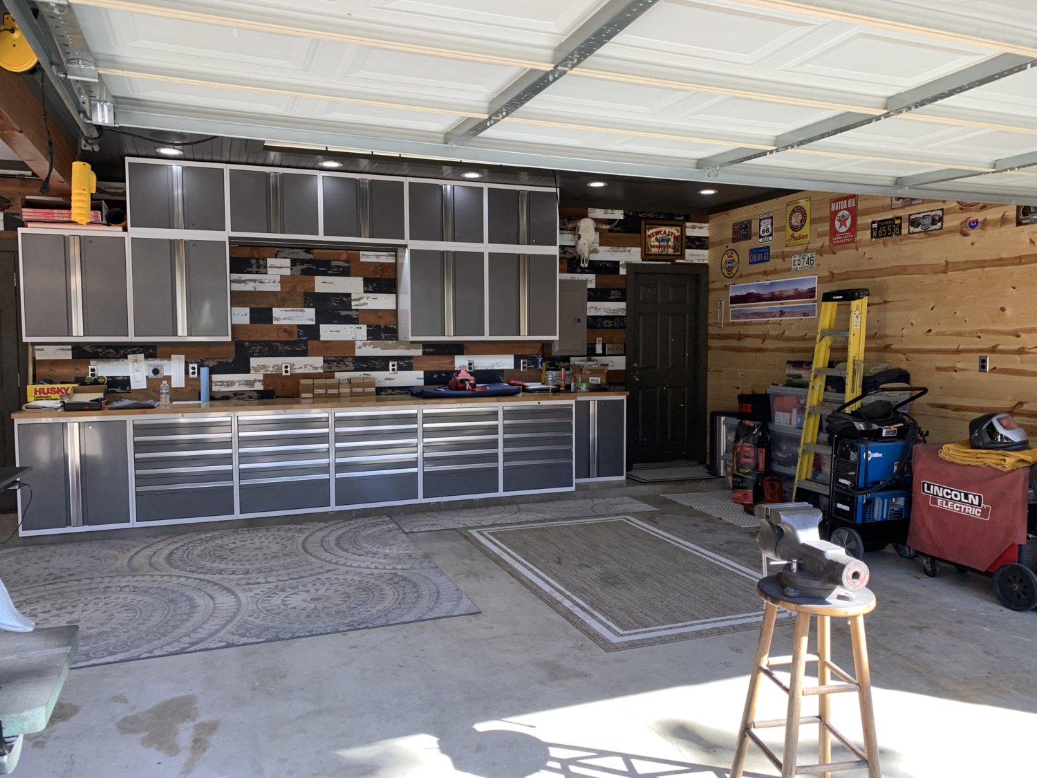

With the truck out of the way... it was easy to get my leaf blower started up and do a nice thorough cleaning of the garage space. Having cabinet doors instead of open shelves makes this possible and the overall look as much more "clutter free"...
full
It's almost impossible to express how great it feels to be able to work in the sunshine a few days after Christmas in shorts and a t-shirt. This was one of my only "Garage Days" of the entire vacation but it was incredibly therapeutic. Spent the day revising the passenger side seat mount since it was interfering with the Atlas case (which is mounted about 6" higher than a typical installation). Threw a few old designs in the tuition pile and eventually got everything fully sorted out.

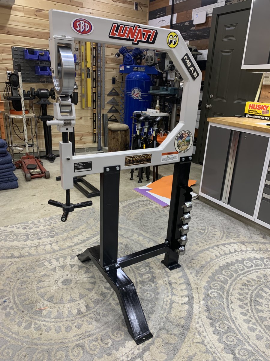

That was basically the end of the Christmas / New Years vacation and the normal (abnormal) work schedule resumed. One bright spot this week was that the English Wheel finally arrived in Austin and so I was able to drive down to the freight company and pick it up myself to avoid further risks of delays or lost boxes!!! Looks like I've got one obvious project to spend time on this Sunday.
full

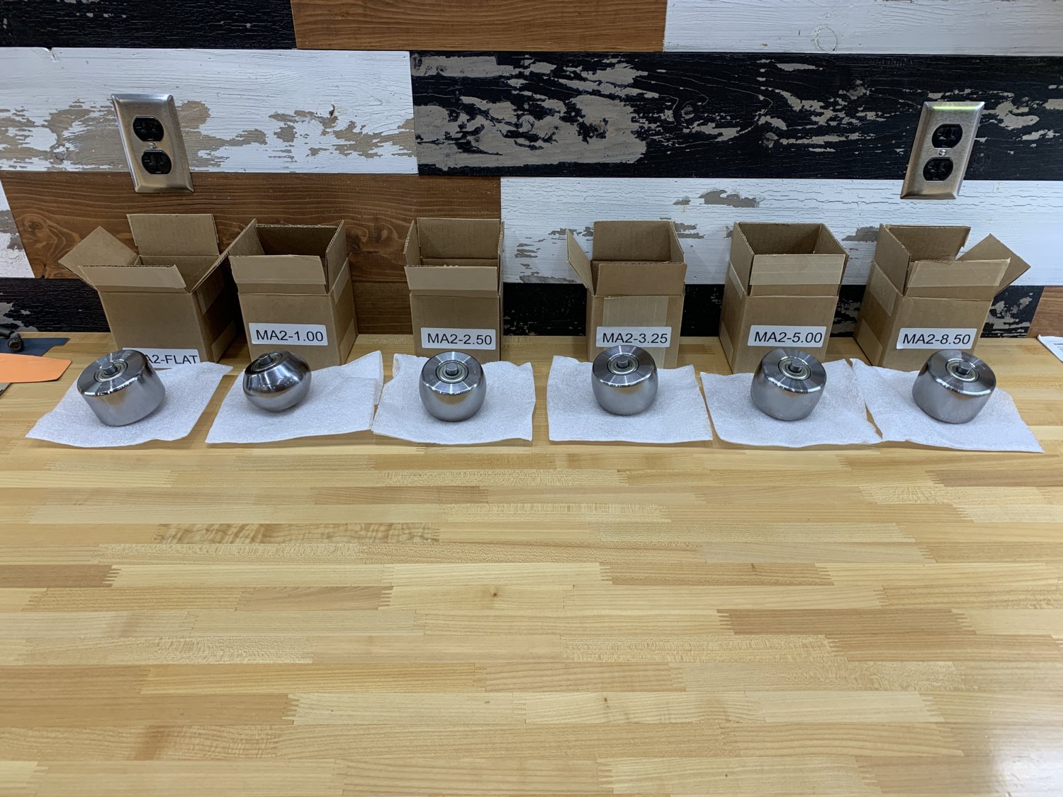

...and the MetalAce lower anvils (Purchased through Trick-Tools) arrived as well. It's a nice selection of radii and will probably let me build everything that's needed to complete this project. Everything from 1" radius to an 8.5" radius and a pure flat anvil as well.

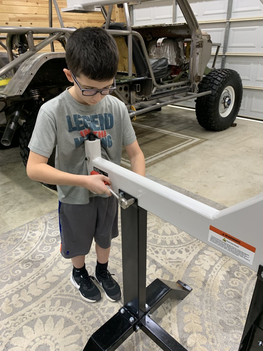

Charlie came out to the garage to help put the English Wheel together...
full
As predicted, the whole thing was quite simple and went together without any issues.
The only "catch" was that the dies from MetalAce didn't quite fit in the saddle of the lower anvil holder. A few minutes with a flat file opened up the slot by a few thousandths and now they drop right in!!! Easy peasy...

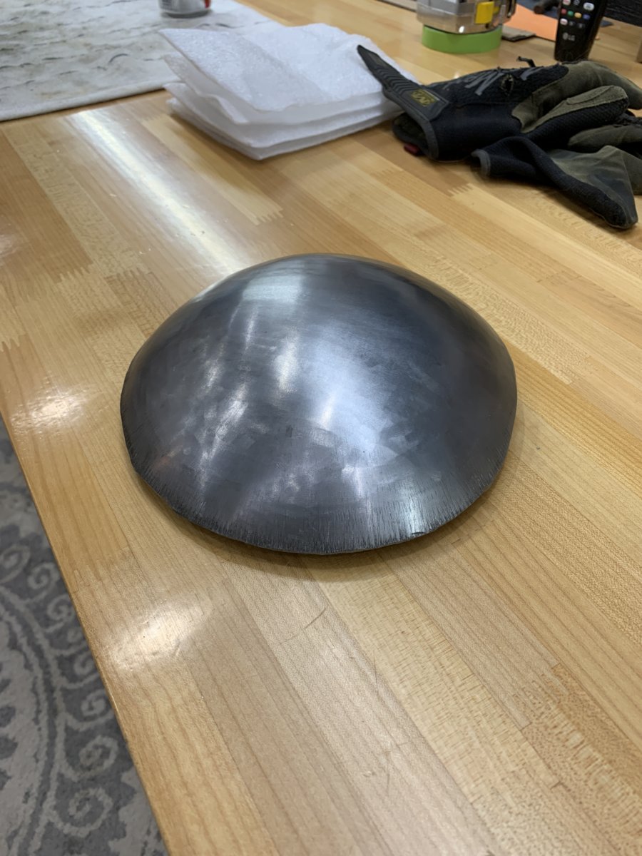

We found the old bowl project that was started when the planishing hammer and shrinker/stretcher were purchased last summer. The results back then were pretty disappointing, and the noise of the planishing hammer was a real deal-breaker especially for the amount of actual work it could do. It was a great comparison to take that boogered-up bowl shape and run it through an English Wheel to see how much cleanup was really possible.
full
The end result was actually pretty impressive! The bowl shape got a lot deeper and the surface finish was substantially better than we could have ever achieved on the planishing hammer.

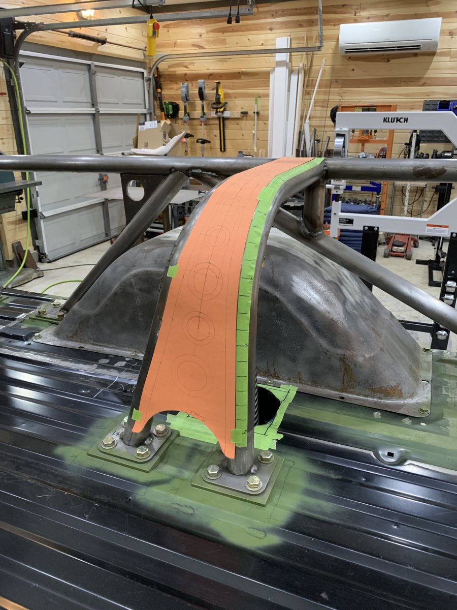

Briefly considered doing these filler panels as an early English Wheel project, but with all the speed holes and flares it was getting too complex and started to feel like a bad idea.
full
Ultimately, this probably doesn't even need to be pre-bent with the wheel and can probably just be finessed into place with tackwelds and slowly working the part around the curve a little bit at a time.
