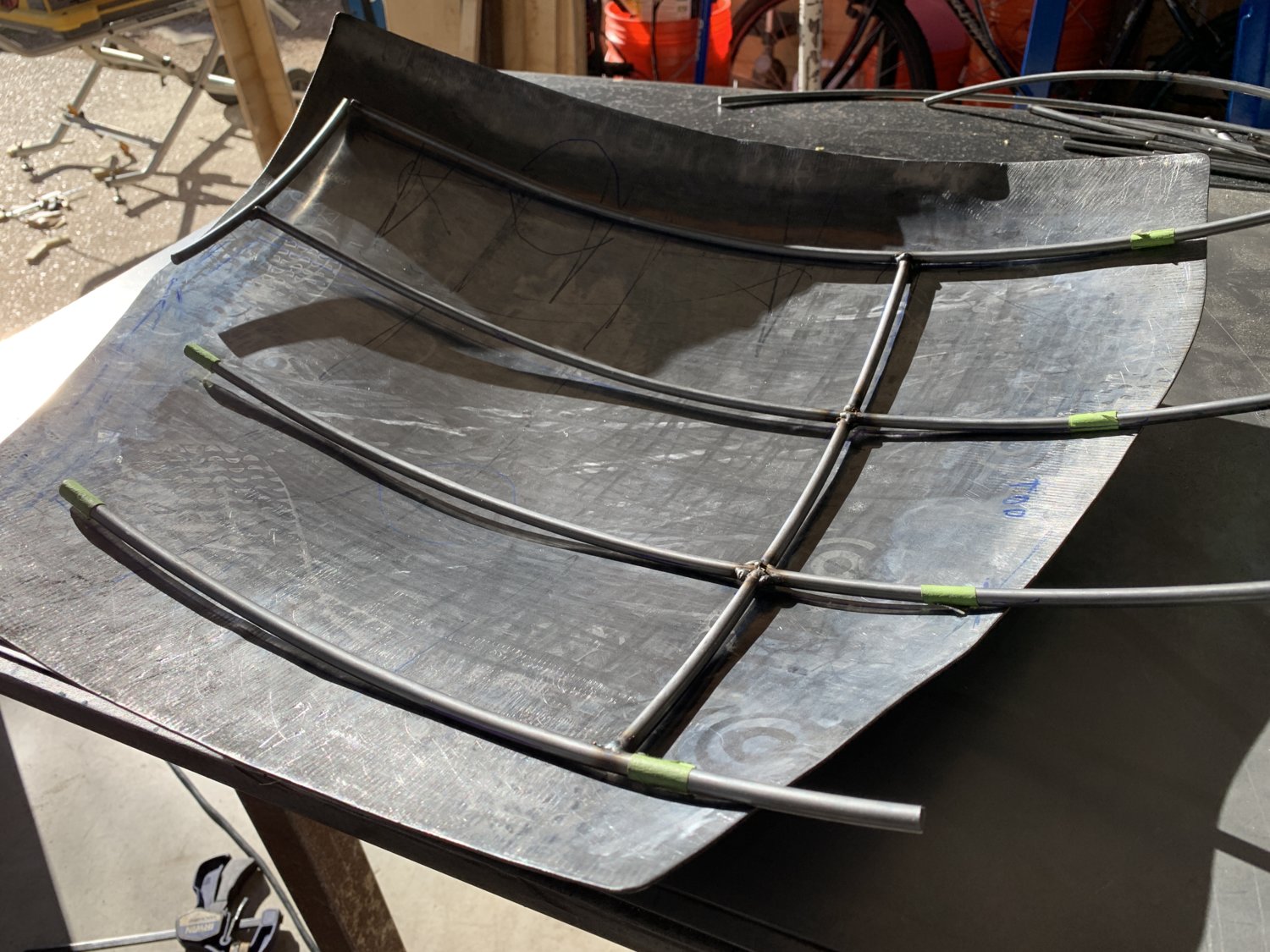

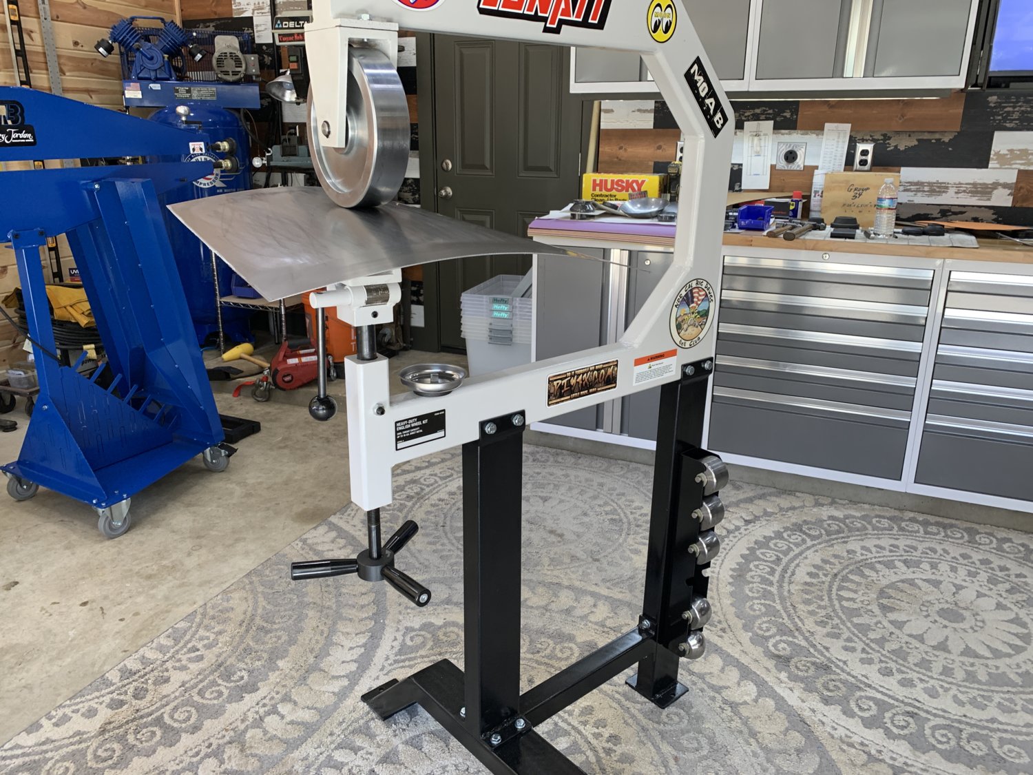

Started on the wheelwheel shape trying to make a sheetmetal version on the wireframe model that was already built. Cut a good sized sheet of 16GA (.060") and starting running it through the English Wheel.
So far...so good... it's easy to get the initial compound curve going especially when it's only a low-crown part that needs to be built.
full

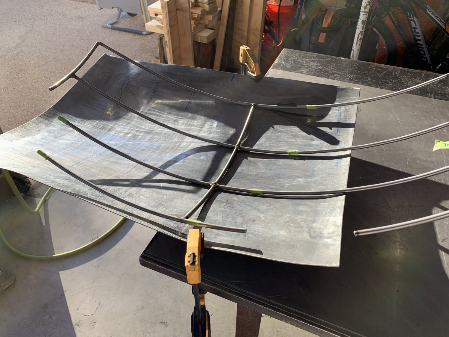

The problem is, that the footwell is NOT a low-crown part. It's a very high-crown part and that means that a LOT of stretching needs to happen in the center of the panel to get that strong curve that is needed.
After literally HOURS of wheeling back-and-forth and focusing lots of enery in the center of the panel, this is best that could be accomplished.
full
Being able to read the metal is definitely a skill.... from this image all that I wanted to do initially was figure out a way to shrink the perimeter so that the metal would curl up more and touch the wires. But that is easier said than done.
Some of the YouTube videos indicated that this entire panel could be rendered with only English Wheel... no shrinking. So I was determined to figure out what I was doing wrong.

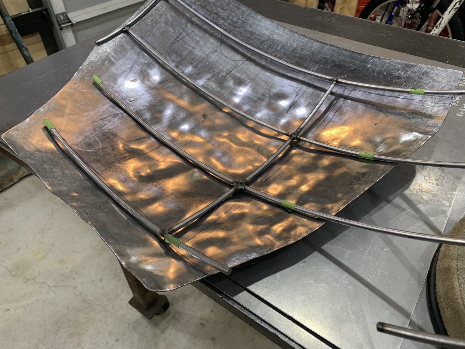

After a lot of study, I realized that the biggest problem was that the metal in the center just didn't have enough "area value" for the crown that was needed. The only way to get the perimeter areas to come UP was actually to work the CENTER of the panel........A LOT!!! Out of desperation, the shot bag and mallets came out and a ton of hammer blows were made in the center to create that "bag of walnuts" look that makes you think you've ruined the panel forever. Even then, trying to dent 16GA in any meaningful way took a lot of power and after a couple hours of that my arms were completely spent.
You can see the walnut pattern in the reflections along the right side of this part... But you can also see how high the crown of this panel has become!!!
full

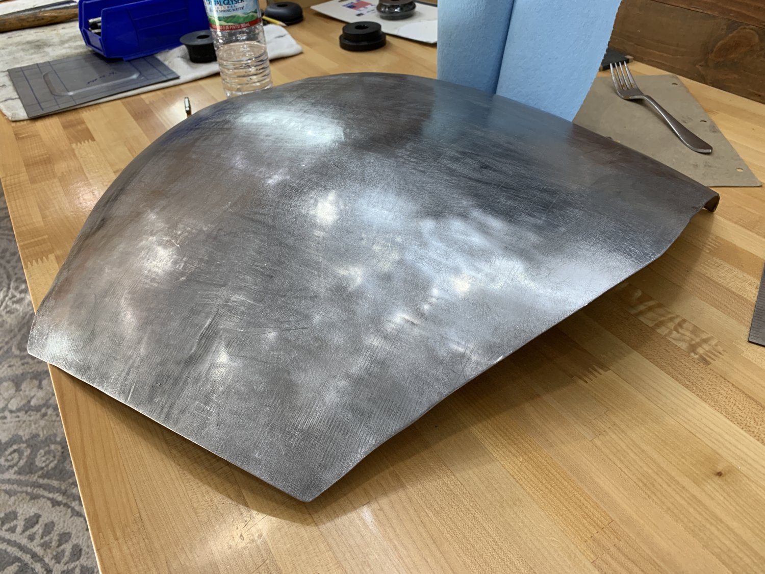

LESSON 3: Stretch it where it touches the wires
It seems so backward to keep working the metal in the areas where you finally got the sheetmetal to touch the wireframe, but ultimately, the gaps everywhere else are just telling you that the overall crown is just not high enough and needs to be developed more. Once this was understood more clearly.... a steady combination of strong hammerblows, and walnut-smoothing on the English Wheel brought the project to a pretty nice shape by the end of today.
full
There is a little more work to do in the upper part of the photo to bring that last corner up, and some general cleanup and refining of the crown shape overall to make it more uniform but overall the shape is pretty close to what is needed.
This one little panel is about 10 hours of labor as it sits here.... clearly, most of that was just learning about the English Wheel... making mistakes and wasting time trying to wheel really thick sheetmetal when I should have been beating the crap out of it with a hammer to get a crude shape into the part instead. But ultimately, that is how it goes when you don't have any experience and are trying to learn something new.

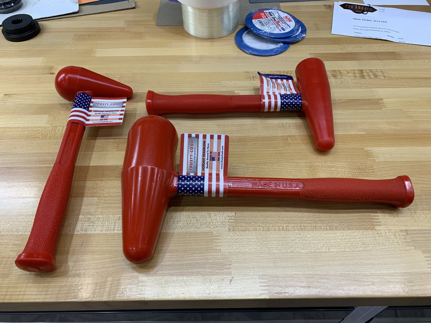

Fortunately, the recent orders placed for weekend progress arrived prior to the crazy weather... and it didn't matter that no snowplows were coming and that everyone was trapped indoors.
Because I had a new box of hammers! LOL

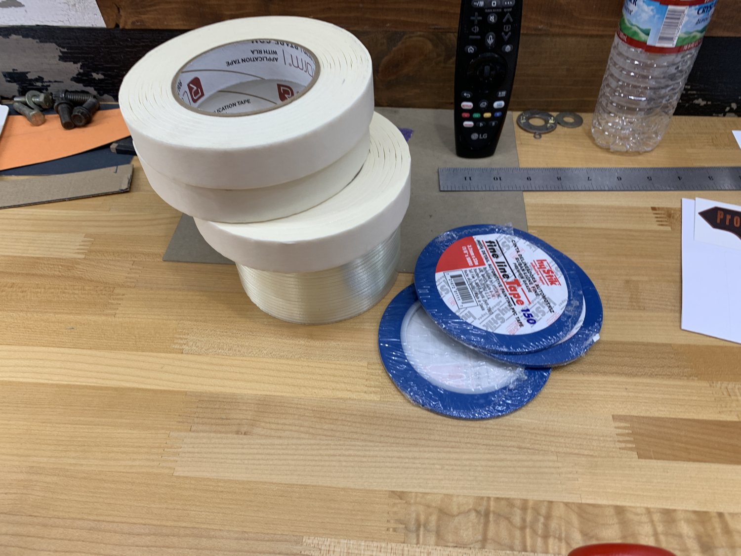

....and a new box of fancy "metalshaping" tape (for making Flexible Shape Patterns)
full

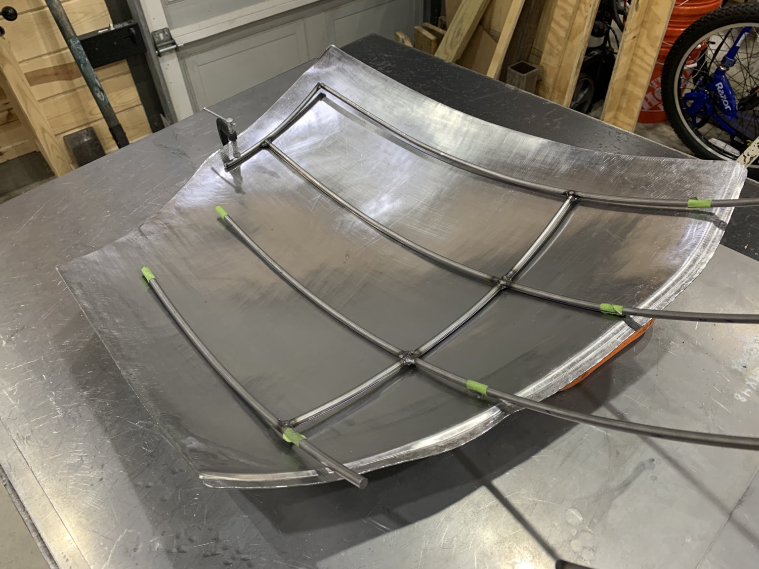

The new deadblow hammers made a pretty good difference, but I'm not going to lie.... it still takes a LOT of effort to make a dent big enough to truly stretch the metal in a meaningful way.
BEFORE:
full
AFTER: (probably 5 more hours spent on this panel)
full
The good news is that now I've got a perfect template for the driver's side... the tape will be applied to make a reversible pattern so that I don't have to use a wireframe model on the next one.
In the grand-scheme of metal shaping... the least preferable method is a wooden buck, followed by a wire-frame model.... with a flexible tape pattern being the best method. Wire frame wasn't ultimately that terrible, but it will be fun to see how much easier the flexible pattern is... and how much time can be shaved off from the 18 - 20 hours that were spent on this first one.

So how’s the tape supposed to work? Or is that being saved for the next update?
It's a trick I learned on that ProShaper link that I posted recently... I need to go back and watch the specific details again now that I'm ready to do one myself, but the basic concept is that you run parallel strips of very low-adhesion masking tape across the entire panel, then run a clear, fiberglass reinforced tape perpendicular to that first layer to lock it all together. Trim the edges, and remove it.... some kind of babypowder (maybe) on the tape to kill any remaining glue :thinking:
Then you've got a pattern with the true "area value" of the steel. In this case it will be a nice dome-shaped template.
As you stretch the next panel from a flat sheet, you just drop the pattern on top and tap it lightly to see what areas have dead-space under them. Those need to be developed more. Areas that are almost done will sit almost perfectly flat against the metal. Basically, you just work the worst areas to get the major parts of the shape in place... then fine-tune from there.
It's very cool... I'll take photos of it as I learn that process too. :waytogo:
