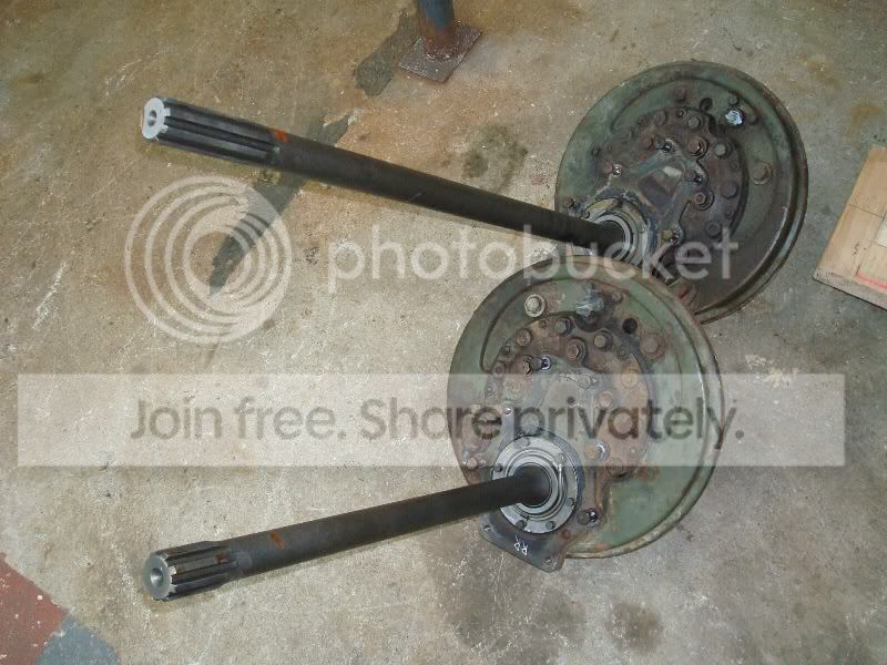

Um......no. I don't own a 55mm socket and I don't have any wrench beefy enough to withstand a breaker bar that long... so I went a different way. I removed all the perimeter bolts from the back of the portal housing where it attaches to the axle tubes.
The only "catch" is that when you remove the drum/portal assemblies you get the entire inner axle shaft too... :D Not a big deal, and it was cool to see how massive these shafts are. I think they measure out to something like 1-5/8" with no neck-down anywhere.

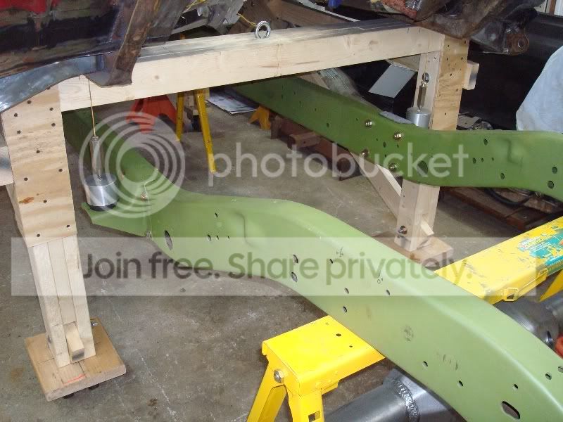

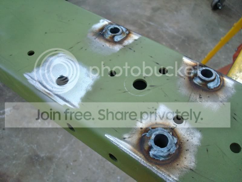

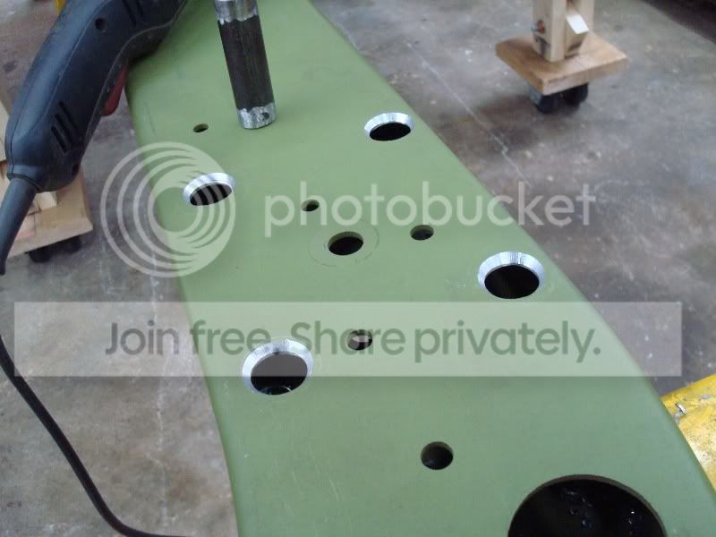

With all that excitement out of the way and a lot of measurements and dimensions recorded in my notebook, it was time to get the frame underneath the body again. One additional step that I needed to take was to add a sleeve to all the through-bolts where the body mount bracketry is attached. Here's a shot of the 1st Body mount position (front footwell area). I got the holes drilled for the 7/8" sleeves and did a nice countersink cut to give me a deep "V" for the welding on both sides of the frame.
Here's an "in process" shot showing the welded sleeves, and one hole after I'd finished the grinding and even cut a small de-burring chamfer on the inside of the hole.
I did the 1st Body mount position on both rails, shot them with a touch-up of Ryoken Green, and then cranked the brackets on nice and tight with all new GR-8 hardware. In this shot, I'm basically dropping plumb lines from the exact hole centers of the bodymount holes to establish the frame position underneath. Since there are no crossmembers (yet) I need to get very accurate dimensions so that I can make sure that the new ones get the frame perfectly square and plumb to the original body mount holes of the body.
