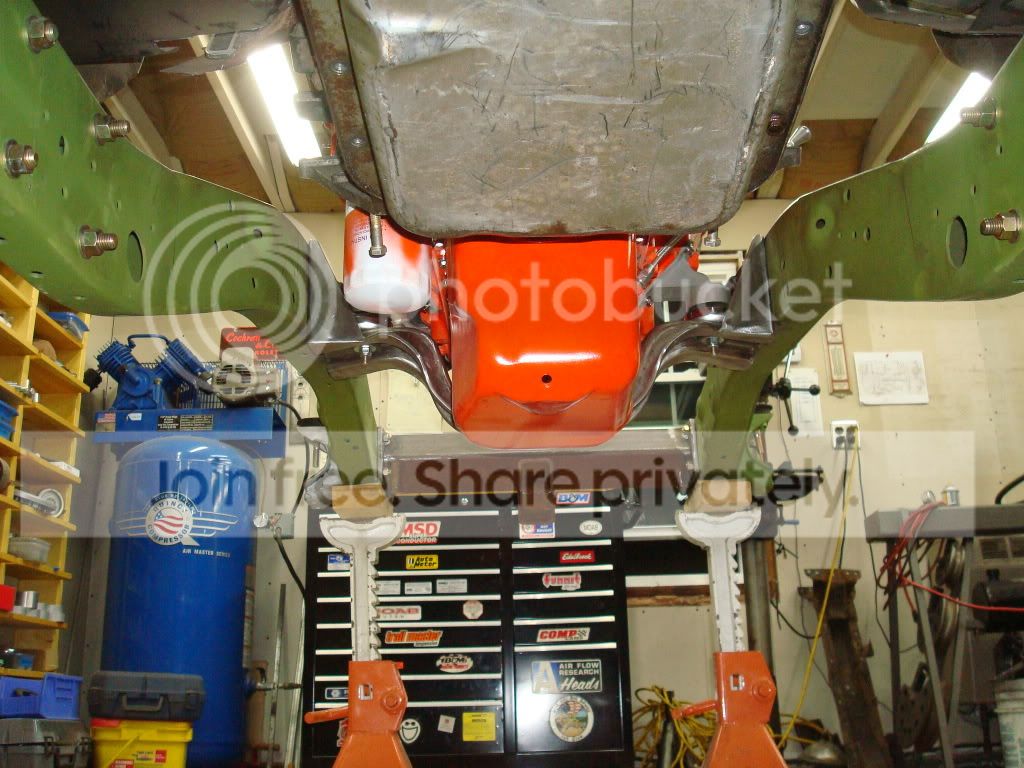

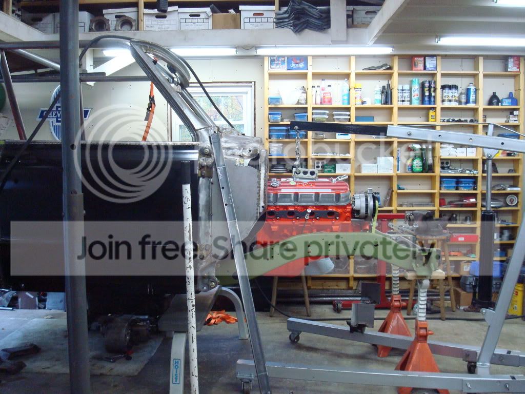

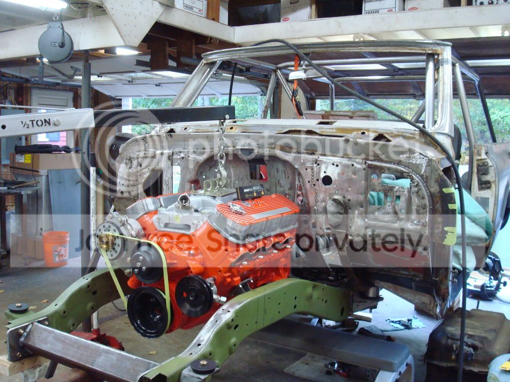

To build a front suspension, it's important to know where the available space is, and more importantly where there ISN'T space to locate the links. Today, I modified and re-installed my original front crossmember (under the rad support area) and was able to remove the lumber spacers and ratchet straps that were holding the dimensions up front.
With that out of the way, I had enough time to get the motor up and into position (once I removed the headers. They had NO chance to fit between my boxed framerails :doah:)
Couple quick shots.....
Next up will be a custom engine crossmember to hold the engine permanently in place, then it will be time to load the empty axle housing into position and see how tight everything looks.

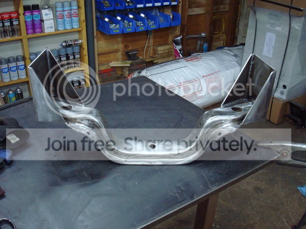

Spent some time this evening welding up my modified engine crossmember, and adding some triangulating plates to each side. Welded it inside and outside to be confident that it's never going to break.
Installed and a shot from the underside....

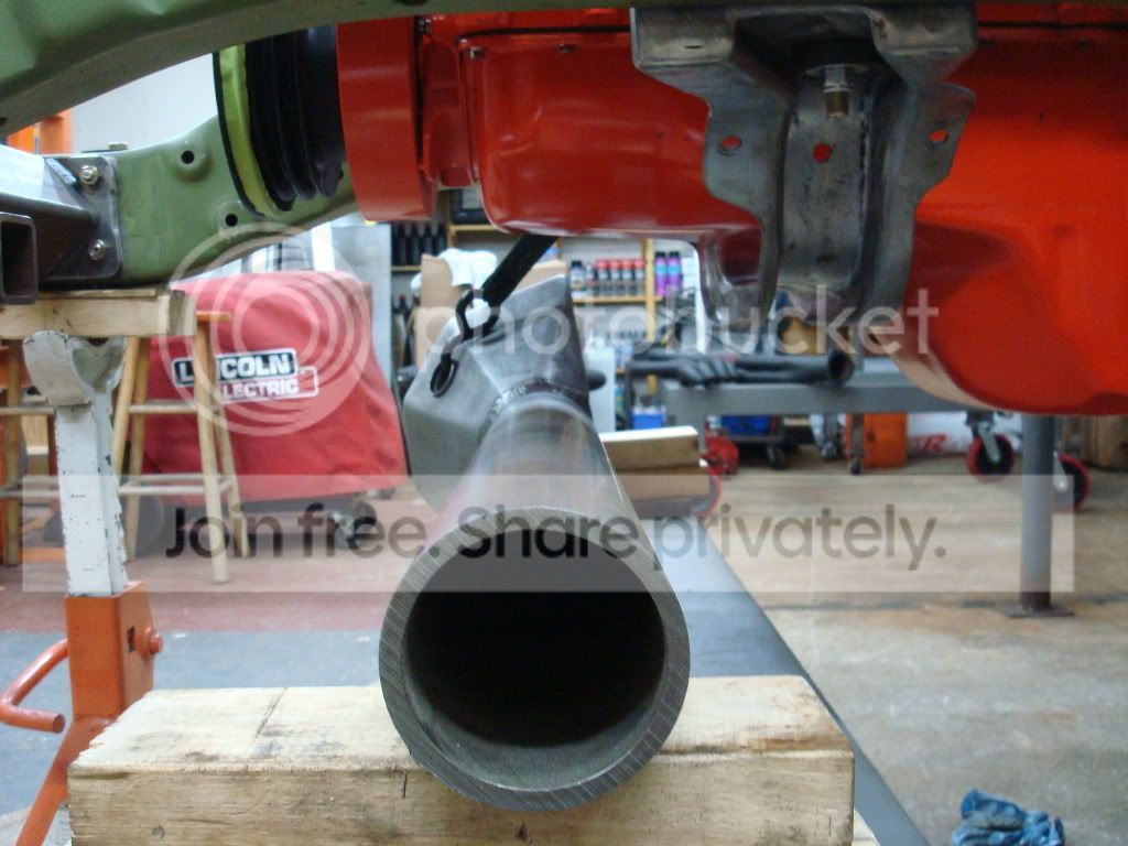

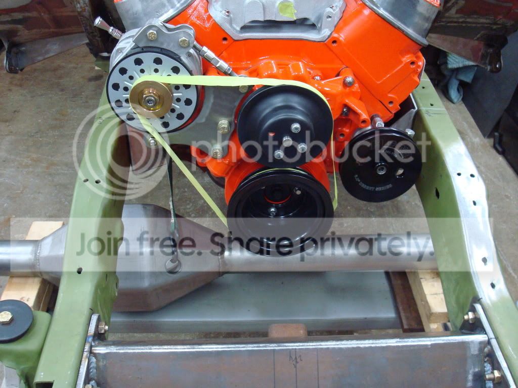

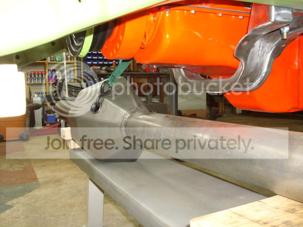

The next challenge.... getting a front axle under the engine and framerails and somehow find 6" of uptravel too!
The pumpkin needs to be offset to the passenger side as far as necessary to avoid hitting the oilpan, and it might even make sense to take advantage of the angles in the centersection. If I place them just right, it might allow for articulation up just under the framerail and perhaps keep the frame modifications to a minimum? :thinking:
This side shot shows a bit more of the challenge. The axle sits a lot higher than usual because of the portal housings, so getting bump travel is a lot harder than it usually should be.
This represents the true axle height for the project. The clearance under the oilpan looks reasonable, but the hardest part will definitely be finding just the right location for the pumpkin to maximize clearances and still get a driveshaft to reach it.

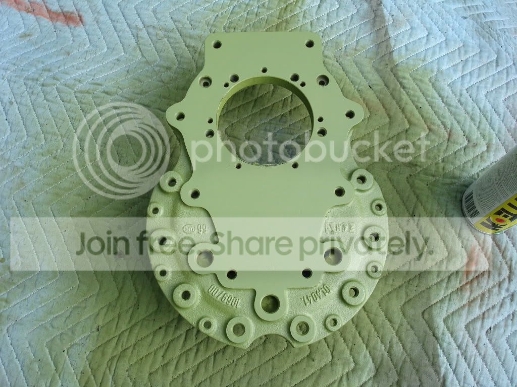

Before I can get the axletube cut down to length to set my final track width, I need to get the final dimensions of the portal housings and 8-lug disc brake conversions.

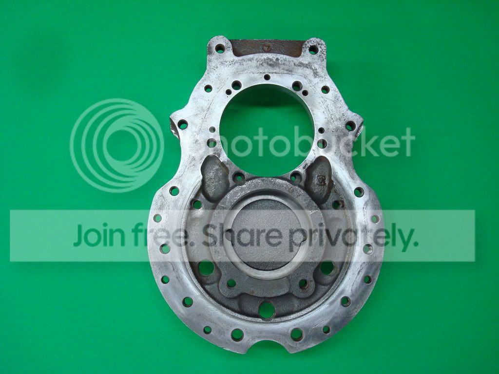

Here's a shot of the portal backing plate all cleaned up and ready for paint.
Ryoken Green:

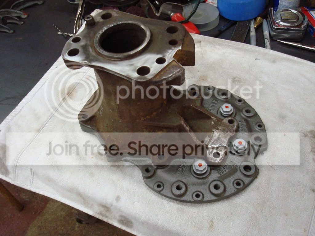

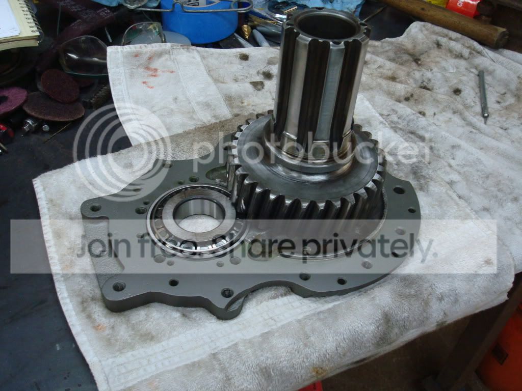

New bearings and the large bottom gear...
Trying out the intermediate Unimog axle spacer for the rear axle. Not sure if I'll end up using this in the final setup or not.

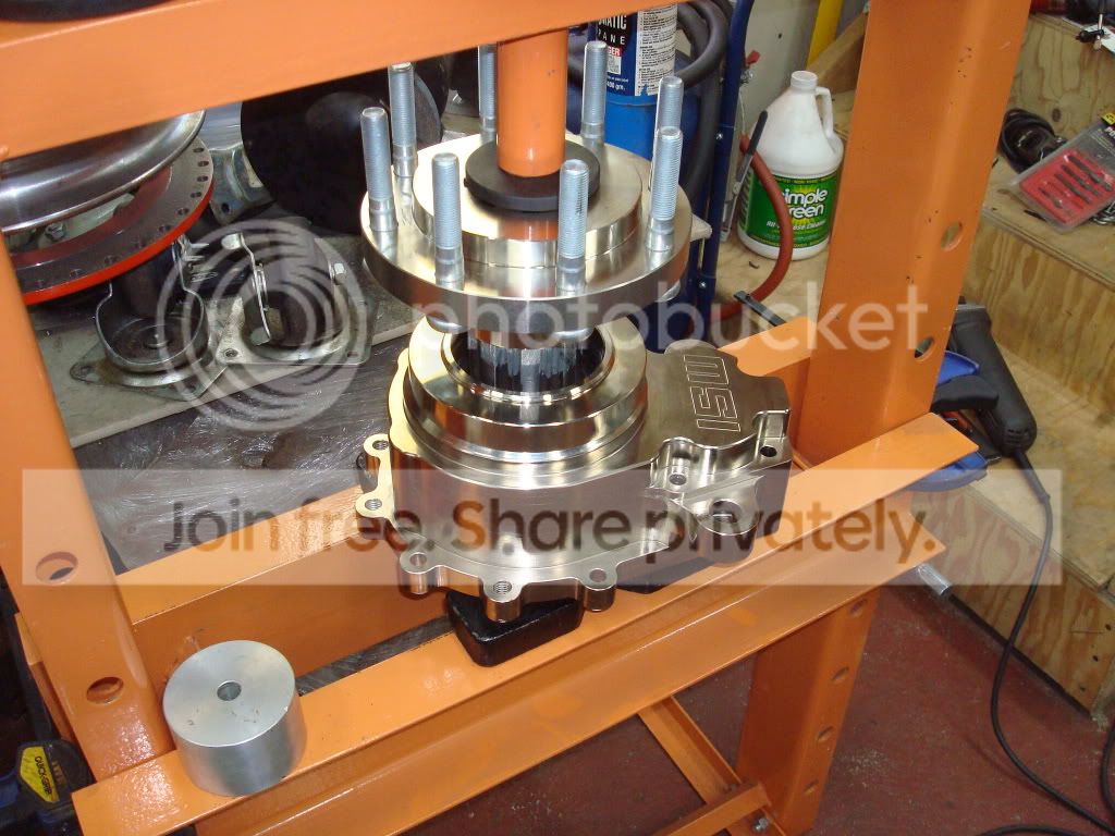

Pressing on the hub....

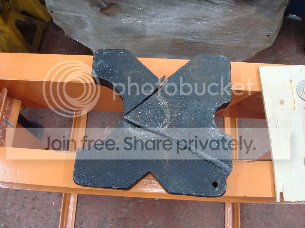

Breaking my cheap cast iron Harbor Freight press plates.... Time for something more "serious".
:usaflag:
Genuine Chinawaneese quality?
wow, that MSI piece is sexy.. looks very well-machined...
