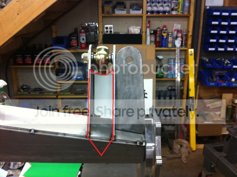

I'm not an expert or anything, but the welds look good, I wouldn't worry about them failing. But there is pretty much always room for improvement, especially if you ask in pirate :flipoff7:
To make you feel better I would probably box all all your link mounts and have as much overlap on the axle where you weld as possible, try to rely on weld strength as little as possible. I don't know if this was the plan already, haven't read the whole thread yet.
You are right on the money, mang!
That red plate is already in the plans, and one just like it on the back side. Running the plate down as a wrapper into the truss is definitely going to help as well...... with the interior welded, the exteriors welded and all of those extra "welded inches" of the front / rear boxing plates, I "think" the link mounts will be strong enough :thinking:
Even after that, there is still a temptation to laminate a little extra metal around the bolt holes too just to be safe.... I don't want to have to go back later and fix stuff, and adding a few extra ounces of metal now is worth the trouble.
