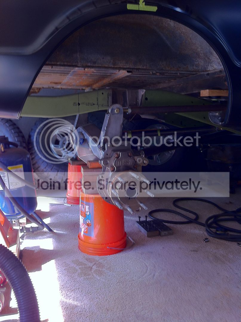

very nicely done Greg....I was thinking the "soda" can was holding up the axle...
So would that be the fully compressed location of the axle?
Dave,
It's hard to believe, but that is not fully compressed (bump travel).... That photo is ACTUAL RIDE HEIGHT!! :bow:
That's the clearance the truck will have just rolling down the road (or trail). On a trail littered with medium size rocks, most of them will just pass directly underneath without touching at all. I'm loving the look of the axle clearance (from the rear) and the flat belly pan clearance view (from the side). Eventually, on a real world trail EVERYONE runs out of clearance...but I am encouraged by the clearance I'm getting with a relatively modest lift. :thumb:
-G

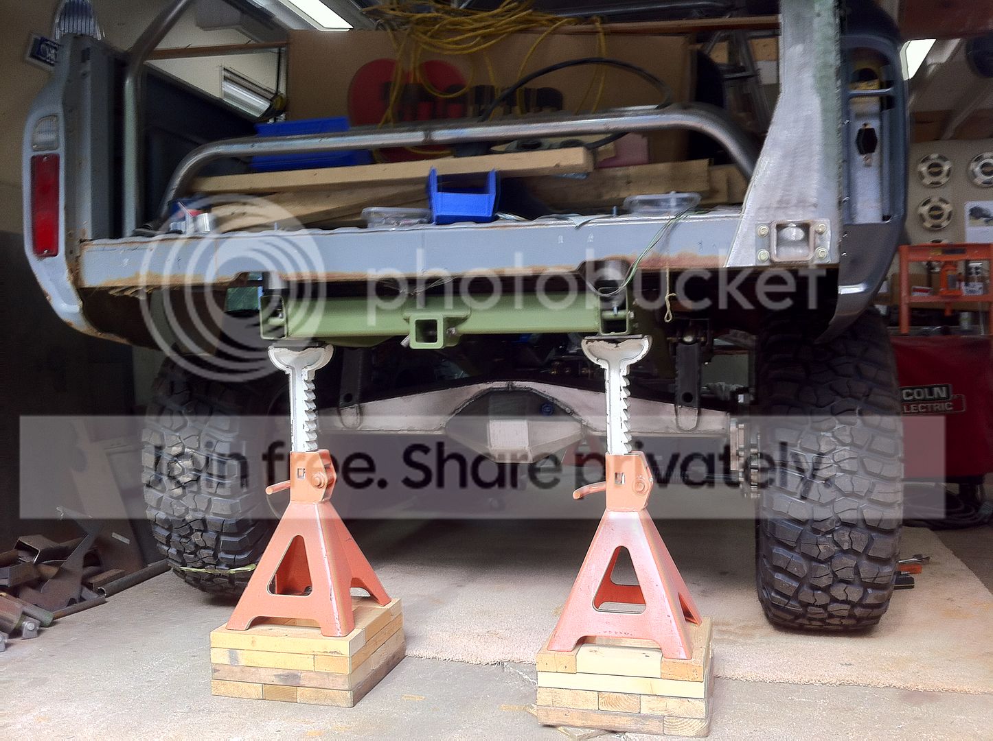

Next steps: Finish painting all the brake parts, drill out backing plates for the installation of the rotating union (for CTIS feature) then re-assemble portals and bolt to axle. Also on the list is a set of mounting points for the ORI struts so I can bolt them to both the axle and the rear frame/cage area and remove those rear jackstands once-and-for-all!!! :saweet:

Officially on its own tires.... :waytogo:

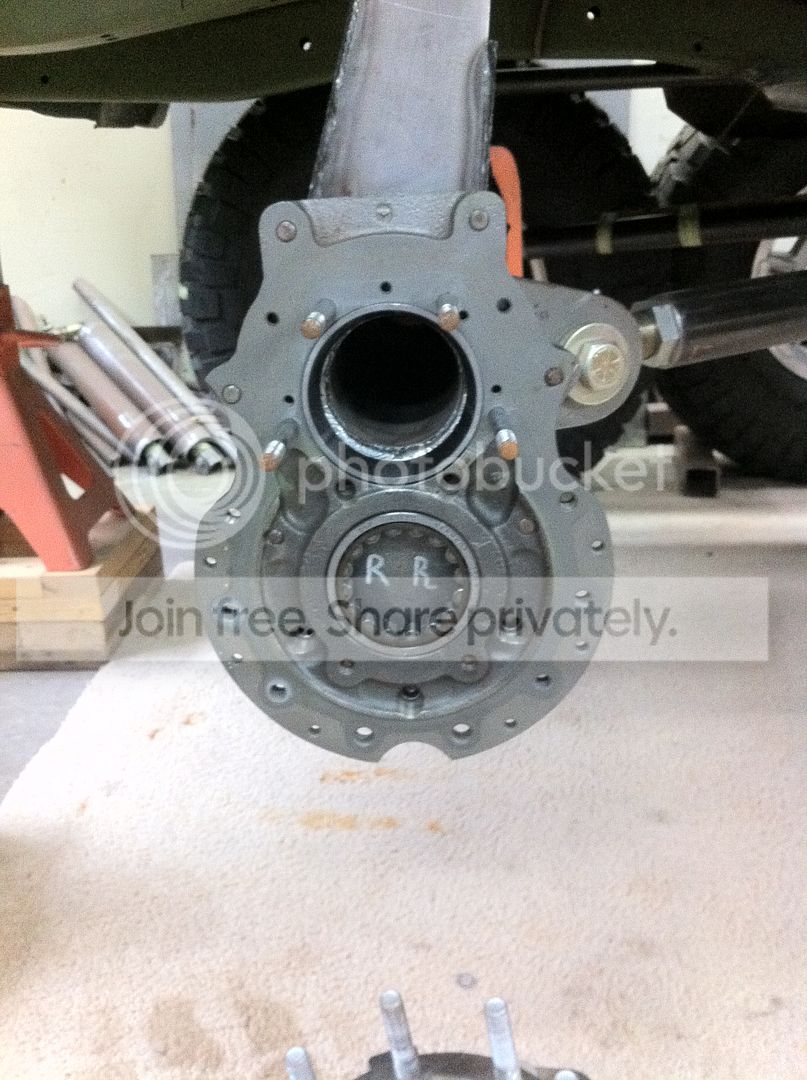

I spoke with my local machinist friend this AM and he said that if I could bring him the parts TODAY, he would machine all the backing plates (Qty 4) for the CTIS unions and also cut down the eXaXt wheel spacers from 1" (original size) to the 3/8" thickness that I'd prefer. So, basically I had to go home and quickly disassemble those rear portals and get them off the truck so he'd have parts to work with. The good news is that I should have everything back by Friday so I can do some more painting and re-assembly work.

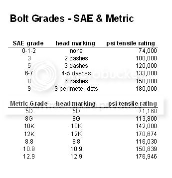

I'm trying to learn more about Metric vs. SAE Bolt Grading......
Here is a table built from data I found online:
The Mog stuff is all metric (yuck!) and as I get ready to re-assemble the parts I am tempted to replace some of the existing fasteners with good quality, high-strength stainless stuff from ARP. I hate rusty fasteners, and this would give me a good opportunity to swap in some good stuff.
The perimeter bolts that hold the backing plate to the portal box are:
M10 x 1.5 x 35mm - Stamping on bolt head: "8G"
This seems to translate to not quite a Grade 5 (SAE) strength bolt....correct?
There are some cap screws that were part of the new disc brake conversion that are:
M10 x 1.5 x 65mm - Stamping on bolt head: "12.9"
I'm not sure yet what that translates to for tensile strength (psi)
Basically, I want to ensure that any bolt I remove gets replaced by something at LEAST as strong as what I took out. So I'll be scouring the ARP catalog to verify that the bolts I'm interested meet the minimum spec. ARP offers quite a few different variations of "stainless" so I need to study-up a bit more to understand which formulations are appropriate and will resist corrosion.
