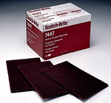

be a good idea to run some maroon scuffpad's over the primer before you paint...

Maroon scuffpads? Could you elaborate? I need something. Now that I pushed into the sun - lots of runs.

for runs, sand em out with some 220 to 320 grit paper. let it dry thoroughly first.. airdried primer is slow to cure... wetsanding usually works best... for a general, all over, "knock the shine done" scuff, use a course scuffpad.. they are usually maroon.. that's the 3M's, but any brand will do really... it's equivalent to about 400 grit...
Thank you. I plan to leave it in the sun all day to dry. I'll grab some sandpaper and pads today and get it cleaned up tomorrow. I really want to paint it before Monday. I like the wet sand idea, I'll want to spray it clean before paint anyway.
