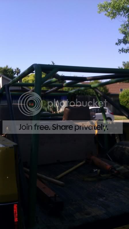

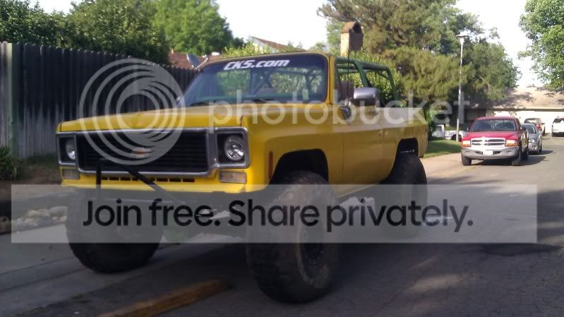

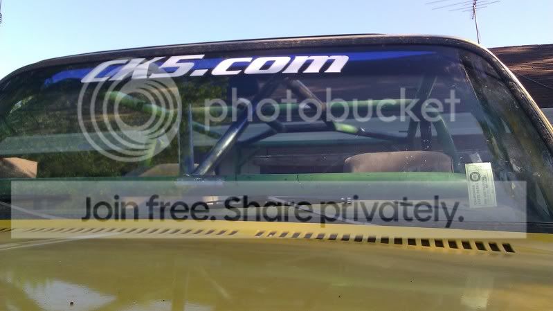

fml doing this anywere but at the shop..... ive been coping with a crappy grinder, and cutting with a sawzall, and tacking with a 30 year old stick welder.....
got dash bar, windshiel bars, and the 2 bars from a to b pillar done
Hell ya. Its hot here too. Too hot to be working on the rig(at least mine).
Its pool time.
MAN.
i HATE using "hand" tools for cage work!
6 1/2 hours and i didnt even do all i wanted to!

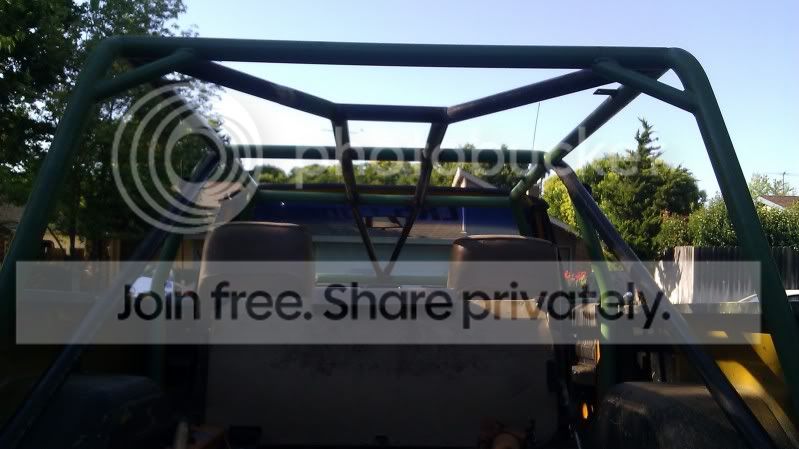

i still need to run a bar level with the bedsides from b to c pillar.
And then i have 110 in left over. Im thinking bars from b pillar to center of truck behind front seats, in a V shape. Thoughts? ideas?
Anyone with bars behind there seats comment on getting passengers back there?

Like this?
I thought about that, but an H doesnt have too much in the way of strength from the side, were a flop would happen. So if you dropped it hard on one side it would just fold over. Allthough that is the easiest option for passengers.
this is what im thinkin. My cage is identicle to this, minus the V in the rear tieing the top in. I havnt done that yet. Im doing the bars on the bottom near the bedsides, and debating on the v at the b pillar
pics
The H had harness seat belts in mind. I would add gussets to make the H stronger .
After seeing the pics this just came to mind:
