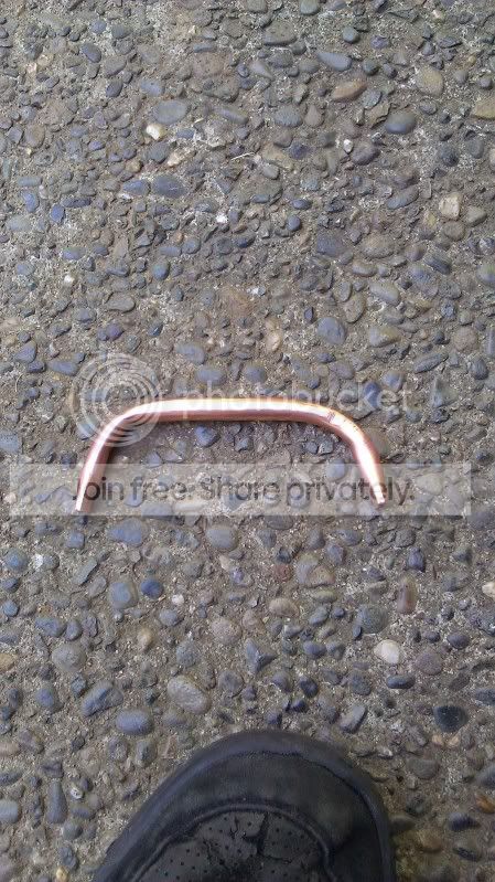

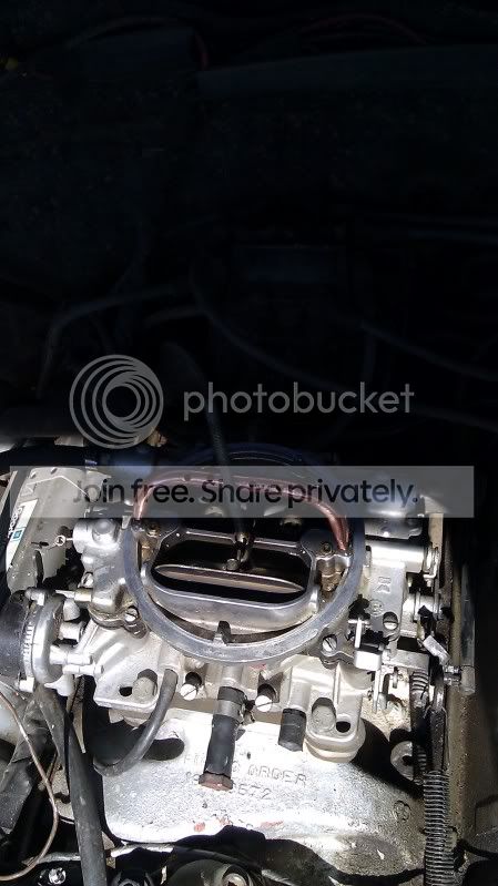

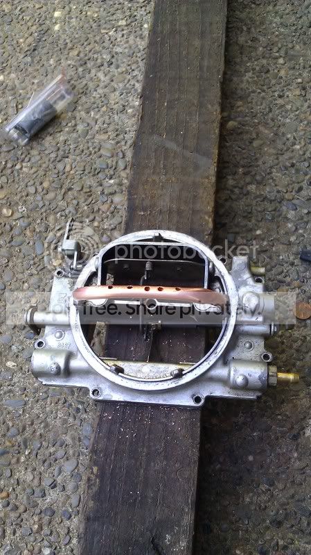

so did some Edelbrock modding today.
Installed off road needle and seat.
Set float level at 5/8inch
Set float drop at 1 1/4 inches
Placed a piece of vacuumn tubing in 2 places in between bowl channel to prevent bowl to bowl transfer.

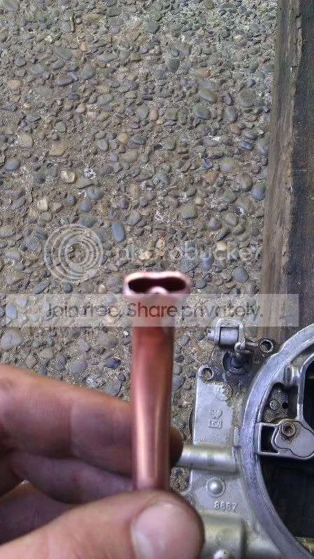

Made a Fuel bowl vent crossover tube
I got a piece of 1/4in brass tube and bent it into shape, then used some pliers, then a screwdriver to make it the shape of the Weird opening on the bowl vents, then drilled some holes in a non symetrical way. Then finished it off with some jb weld.
My floats were WAAYYYY high when i checked em. Like 1/4 inch. So that should help a ton.
Also im 99% positive in addition to one bowl flooding anonther that i was puking gas out my bowl vents into the carb.
HOPEFULLY this will make a more offroad capable carb.
