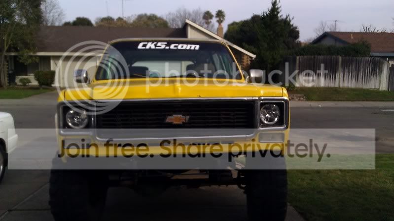

Got my sticker today!!!
weee....
Congrats on the promotion brother...
Now just one question, now that your the official Meat Man
When's the BBQ?I'll Bring the Scotch:woot:
Haha i know! I want to have a wheelin adventure with a nice fat BBQ getogehter thing. Sometime in the near future i hope
