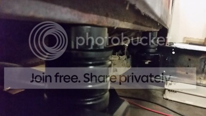

73 K20....crossmember time
Mine are the daystar brand that DIY4X sells, I didn't reuse any hardware.
Yeah I just went through the garbage to get my old crap back. Now ive get the sleeves painted. I went from finishing to getting 1 corner done. I cant believe I paid 85 bucks for this. Oh well I guess. It does look good up an extra inch.
Damn ive not seen that post.
From page 10 of this thread.
Normally I would recommend the LMC rubber body mount kit over poly body mounts, but rust probably isn't an issue for you.....
Martin
Nope not much rust out here. Does the poly allow the hardware to rust out easier?
No, the LMC kit comes with all new hardware. The poly kits require you to reuse your old hardware. Around here, the washers and such are all rusted away.
Martin
Ah i see! I think the body lift is on hold. I have too many cans of worms to open at the moment.
Martin
Information overload.
I've seen Martin post that a half dozen times at least though

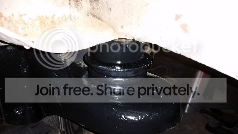

Went back out and put the front driver side body mount together. Finally got it figured out. I need to fix the rear still but thatll happen tomorrow.
