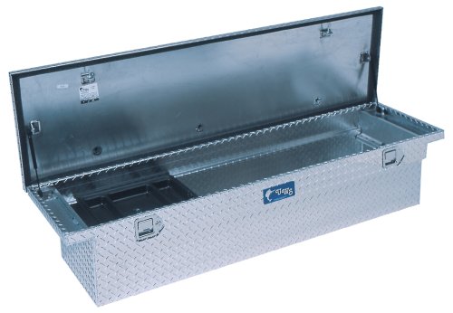

Went to see the grandparents in Nacogdoches yesterday. Grandfather hooked me up with an aluminum toolbox that will fit down in the bed behind the rear seat(below the bedsides). Looks almost exactly like this:
It'll need to be set up off the floor a bit to fit and be where i want it, but it's light, lockable storage for all my tools and parts and such. Grandparents are the best! haha :D

It's a bed box for a smaller pickup(A Taco, or the like). I can post up dimensions as well. It'll need to come up about five inches or so to be where I want it.

i actually have one close to that for mine. only it doesnt have the wings. i used it on my dodge to sit between the stacks, and it ends up fitting perfectly behind the front seats since i dont have a rear seat to worry about.
i actually sprayed mine black with a spray on bed liner to match the floor in the k5.
Before I got my house I had every tool and strap and tie down I owned living in that box full time. And still had room for other gear. Much bugger then it looks
also helps when you buy it for half off on "managers special" lol
steveo are you running a backseat? I think I remmber you are. Trying to get an idea where your new box will sit.
stevo are you running a backseat? I think I remember you are. Trying to get an idea where your new box will sit.
Yeah. running the factory original backseat. Basically i'm going to build some type of "subframe" that will secure the toolbox and elevate it about five inches or so. I want it to sit between the back seat and the tailgate, but be easy to get into(key into lock, latch handles) The fact that I want to raise it up some is also kind of needed since the box would hit the back of the wheel wells if set straight on the floor.
I'll make sure to post pictures. Hopefully going to pick up some metal tomorrow or the next day, to start on the bikini top header and the frame for this.
That's why I was asking bout the backseat. I was trying to git an idear bout whether or not the "wings" would sit over the wheel wells or not.
