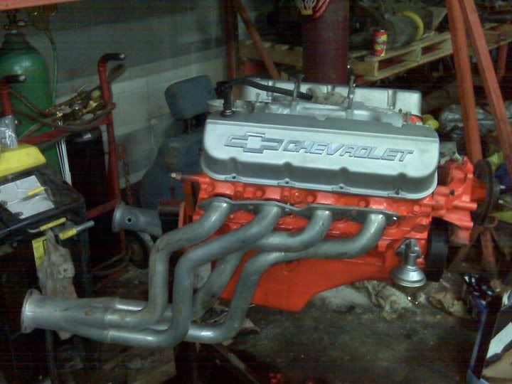

I would look at a dual pattern .650-675 intake, and 675-700 exhaust, with 250-260 duration @.050. That would take advantage of the breathing potential of those heads.
I was eyeing the compcam solid roller XR292R which is around those specs. needs a 11:1 or better ratio it says.
What are you shooting for C.R.?
I dont really have a target CR, what ever it has to be, thats what itll be i guess and the true LS6 454s were 11.25:1 as well. I'm not afraid of higher CR and high test fuel.
I don't daily drive it. Its not a dedicated track car. a weekend warrior in the summer. ive maybe made 1000 miles on it in the last 2 years. but I run the snot out of it like all my other vehicles/.
that xr292r is looking pretty good. i'll see what that cam program says before I decide on anything though.

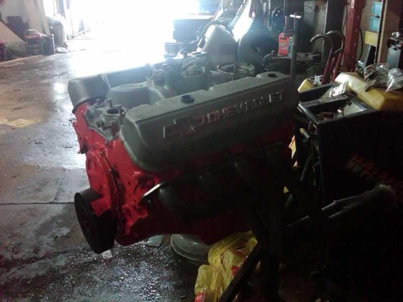

heres a better pic. I don't know why my BB has gone to **** for pics lately. Oh well. It dulled the cam down to a comp cams 280H that should be plenty good for now. It just doesn't have the compression ratio to make good on a big stick.
