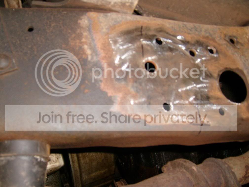

well today i made a little more progress, i removed all the rivets that i needed to for the 52's and cleaned up the steering box area to find small cracks that i had to drill and will weld in before i put the brace on
The nice crack can be seen on the lower right bolt hole for the steering box

I have made some progress in the past few days, i got all the old brackes off the frame and the extra ones off the donor frame that i have. I got one of the sides for the 52's mocked up and started to put the seals in my D60 just waiting on the lockright that is on back order to put the axle all together

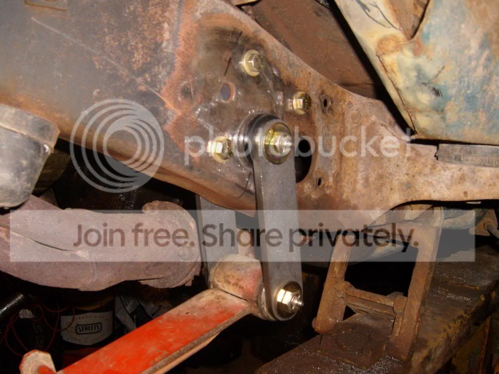

The New holes drilled in the Frame for the New DIY spring eyes
The Beefy DIY shackels and 52 inch springs installed
Below a Picture of the installed 52 inch spring and the steering box brace welded in

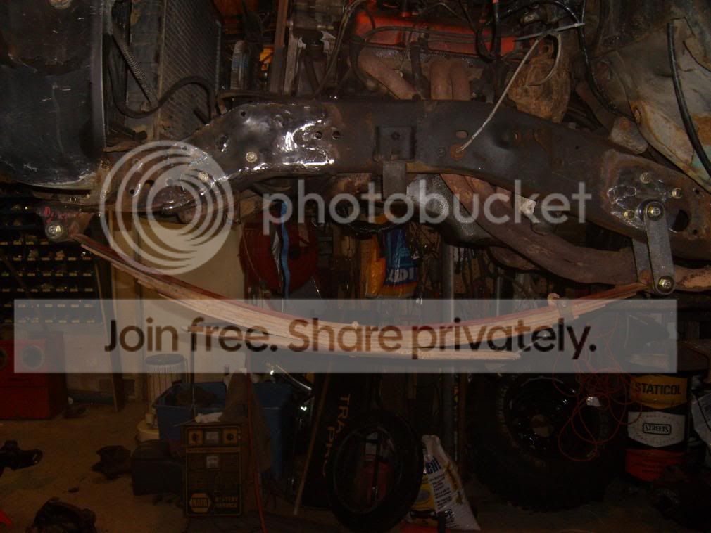

I figured its time for a update, These pictures are pretty old but the most current i have, the truck is back on the road ill take some pictures tommarow of the track bar setup i made and the rest of the 52 swap
The old twisted Cross member is removed
The first 52 Spring is mounted
