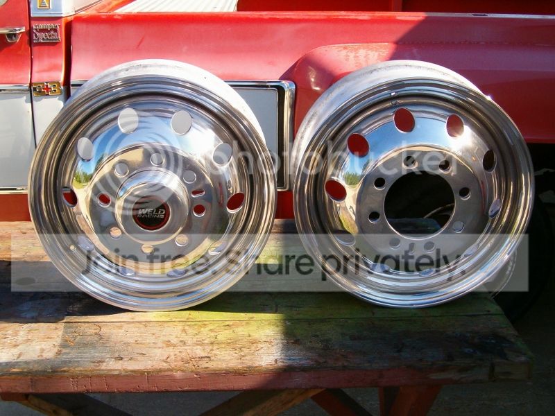

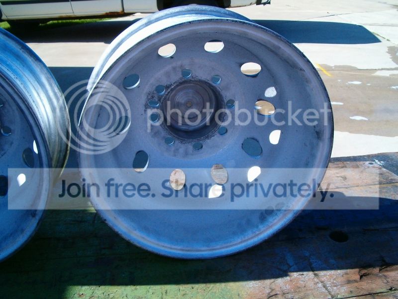

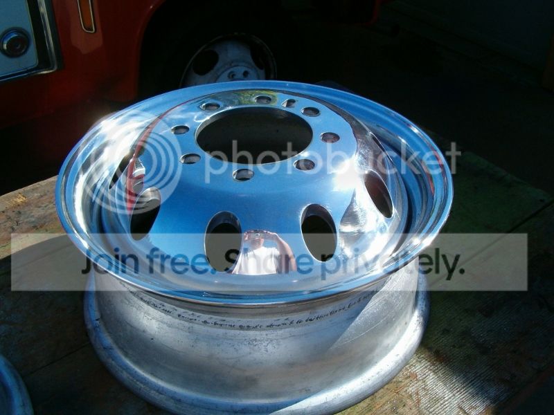

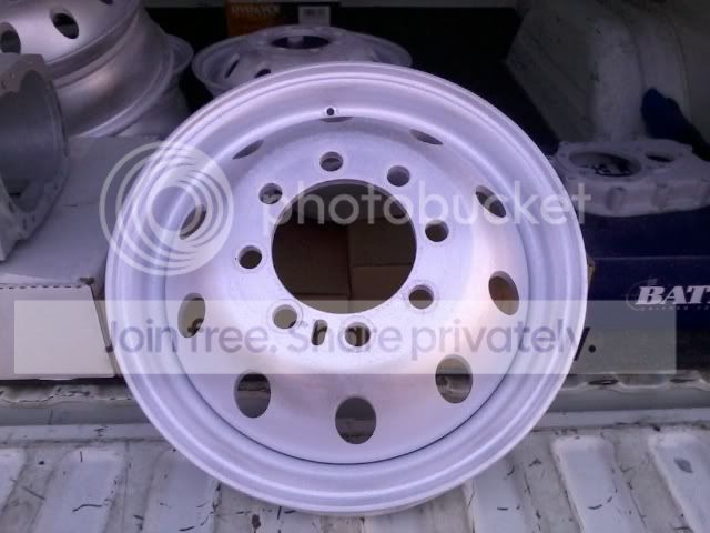

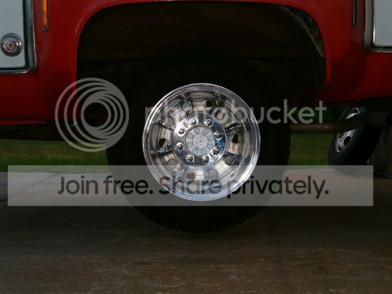

Finally got a couple of my wheels back from the polisher:
before's:
after:
Did they do the insides on two also.
He's still working on the two for the rear...he did the inside of them by mistake, now he's doing the outside (showing side) of them. He's spent over 200$ on abrasive's so far, and is in the hole trying to get these looking nice. He's charging me $250 for all 4 of them. They were pitted to a point of having to use abrasive to remove the pitting, then he goes for the polishing.
Very nice lookin' wheels, the reflection, not so much.... :D

They look great! How are ya gonna keep them like that?
Well for one, they won't see salt, also probably only a couple thousand mi. a year, and I will have to polish them from time to time with some polishing cones/balls and some metal polish...it really don't take long with these attachments in a drill...

Pretty happy with the wheel polishing...final cost of $250...so total wheel cost so far is at $870 w/ lugnuts and caps.
probably could have gotten a new set for not much more:dunno:
So here's where I'm at with these ones...

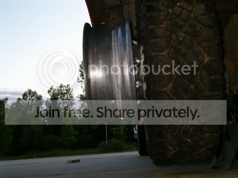

The tires I want to mount are 265/75's and when mounted side by side on the truck I have .600 between the rims...I hear recommended gap should be about an inch...that means I need about a 1.5 inch spacer between them...and new wheel studs to be deep enough to go through them..

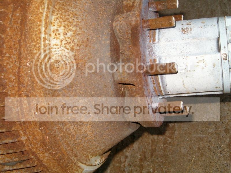

Right now the wheel studs are just right, so I would need 1.5 inch longer than the dually studs which measure about 3.25-3.5". Does anyone make a 9/16 x 5" stud to fit?

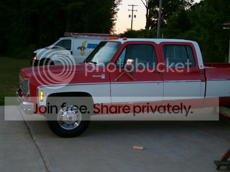

The front look great I think:
The rear inner mounted, and the outer WELD wheel mounted to check stud length...just right without a tire on the rim:whistle:
Stock stud length:
So right now, I want to run the 265's because I have them, and are a little more than 1/2 tread left on them...they are Goodyear Duratrac, and they provide pretty good traction, but I need to make the above mentioned investments of 1.5 inch spacers and longer wheel studs if they are even out there.
Or Mount up some tires that will provide the clearance needed between the tires, and bolt them on with the hardware/wheels/studs I have now.
What to do??:dunno:
First:
New dually wheels start at $850 for a set of four, but I was looking at the quality available at that price and they do not compare to WELDs, the good ones like alcoa which compares to WELD are in the $300-350 a piece.
As for the studs, if you are going to put a spacer, you will need Dually spacers and they do not require longer studs because they bolt to these studs and they have their own studs for the second wheel.
You can't use regular stud on a dually.:thumb:
What to do??:dunno:
