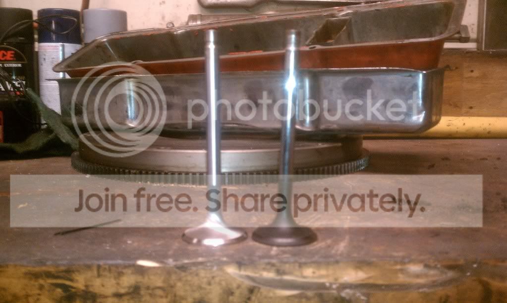

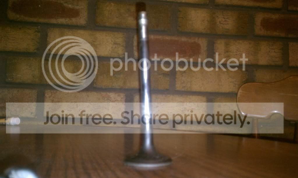

I was having problems with cylinder #1 not firing all the time. Tried the simple stuff first, plug, wires, cap/rotor, went through the valves a few times. Still wasn't hittin on all 8. Did a quick compression check and it (#1) was down quite a bit compared to the others. Could be cam, valves or rings. Was also down on oil pressure from when it first fired...30psi running vs. 60+ before. I'm hoping one of the plugs in the oil galleys behind the cam popped out as they weren't the tightest going in, knew I should have tapped them for pipe plugs. Rather than do any/more damage to it, I decided to pull it and open it up to see what's going on.

That won't cost anything to fix, but why did it bend, and just that one. It didn't suck in any water did it? Of course then there would be more damage than just one bent valve.

Unsure if I want to pull the pan and deal with it in the truck or pull the motor again to do it. If I pull it again I might say screw it and put it in my 78 TransAm.
