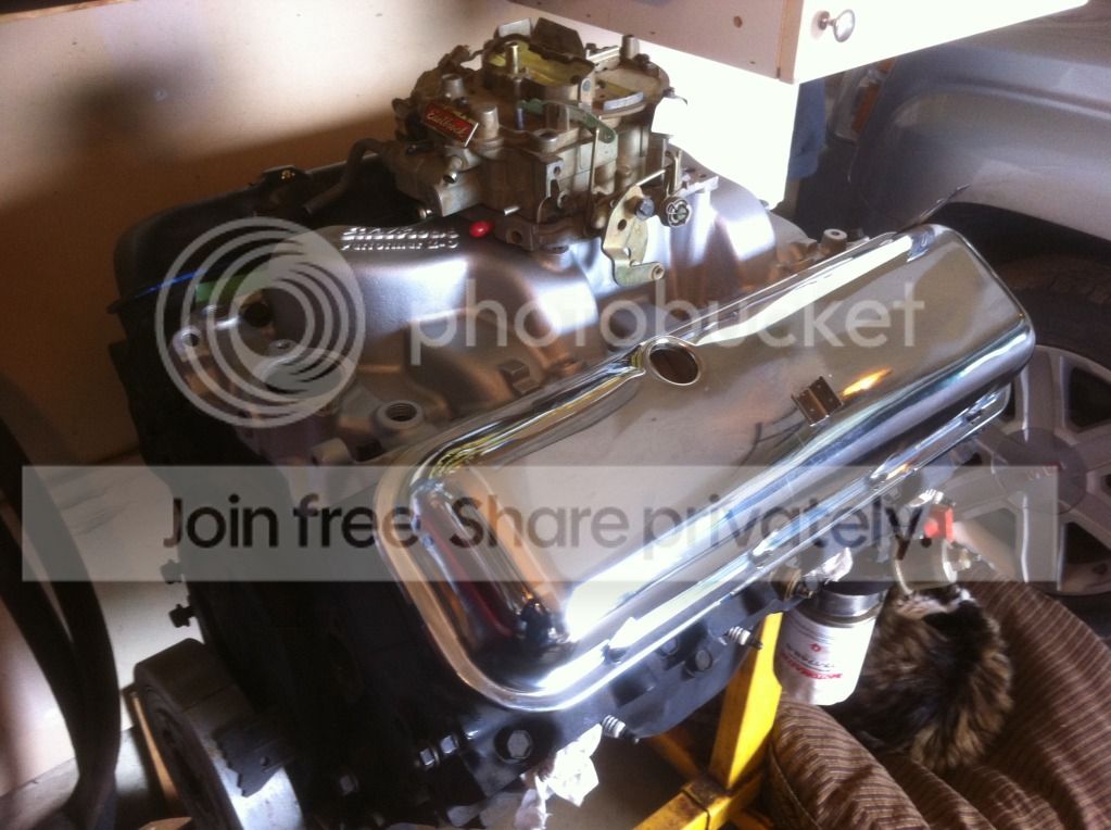

[/url]Rene was asking how the 454 was doing last night. That's it with Daves intake and some chrome VCs from my uncle in B.C. :thumb:
