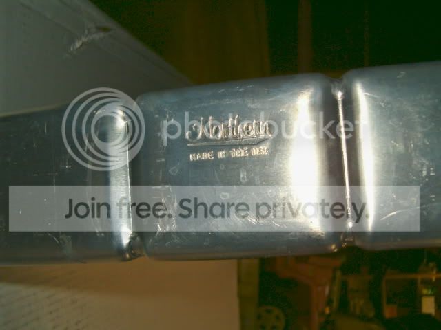

I want to post up asking if anyone has bought the Summit brand Aluminum radiator that fits our trucks....Looking for a comparison here. I recieved my Jegs brand unit today, and it is made by Northern, which I believe Paul said made the Summit brand also. This particular one is listed in Jegs as an "A body, and 73-87 C/K applications including BBC's". Their dimensions are slightly larger than the Summit dimensions and I just wondered if in fact these are 2 different radiators.

yup, stamped "NORTHERN, made in USA" right on the side of the tank...

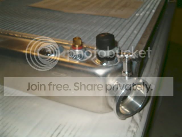

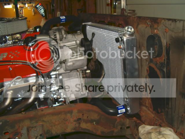

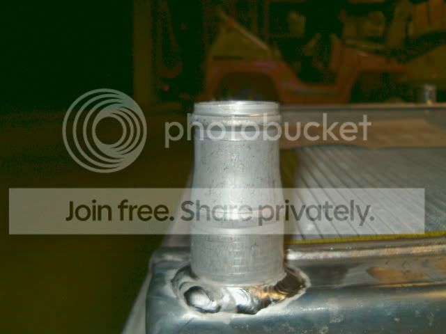

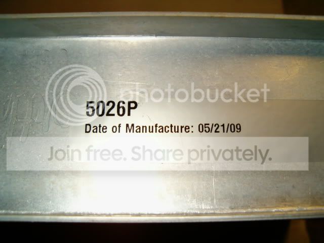

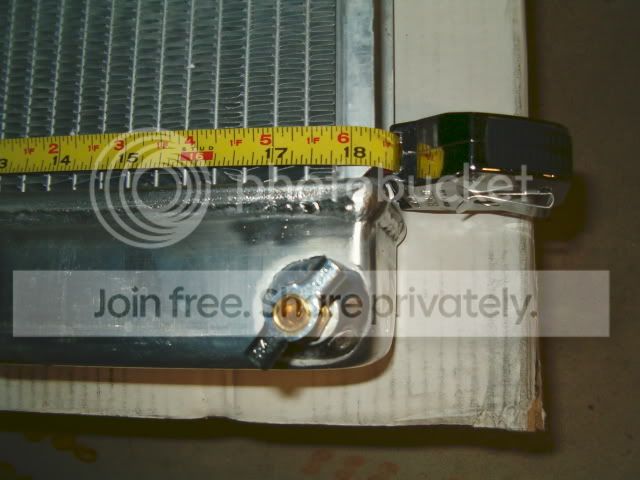

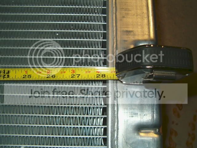

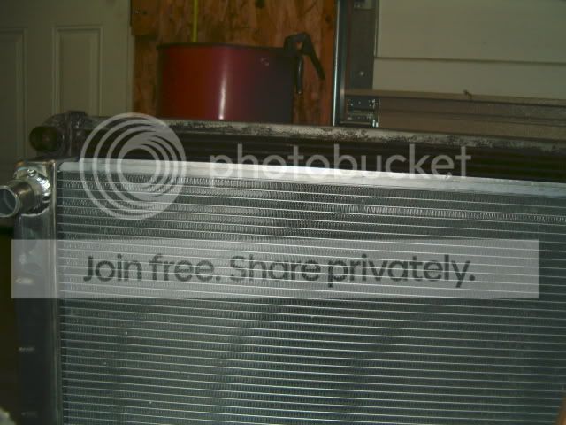

Here is the Jegs (Northern) unit I ordered. Cost was 349 +
the Northern part # is 5026P This one is listed for A body, and 73-87 C/K trucks including BBC applications. It is a little bigger than the one listed above, justifying (or not) the extra 60$ price?

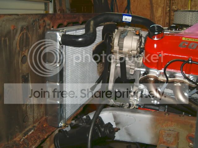

core is 2.25T x 28.25W x 18H with an overall 33W x 18.625H not including the filler neck. It has dual 1" tubes.
The inlet (top) is dual sized for 1.375/1.5 hoses, and the outlet (bottom) is 1.625. The OEM style hoses I picked up for a 77K5 are what you see in the pics, and they fit like factory. I think I need to make a spacer block to lift the radiator about 1" to fill in the opening of the rad. support. I'll have to check the top plate to see how it fits. Comparing the old 77 radiator to this new one, you can see about 1.5" shorter in Height. Looks like a real nice piece though.
