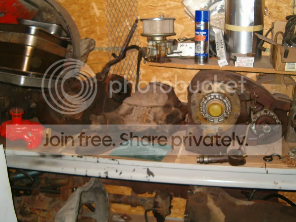

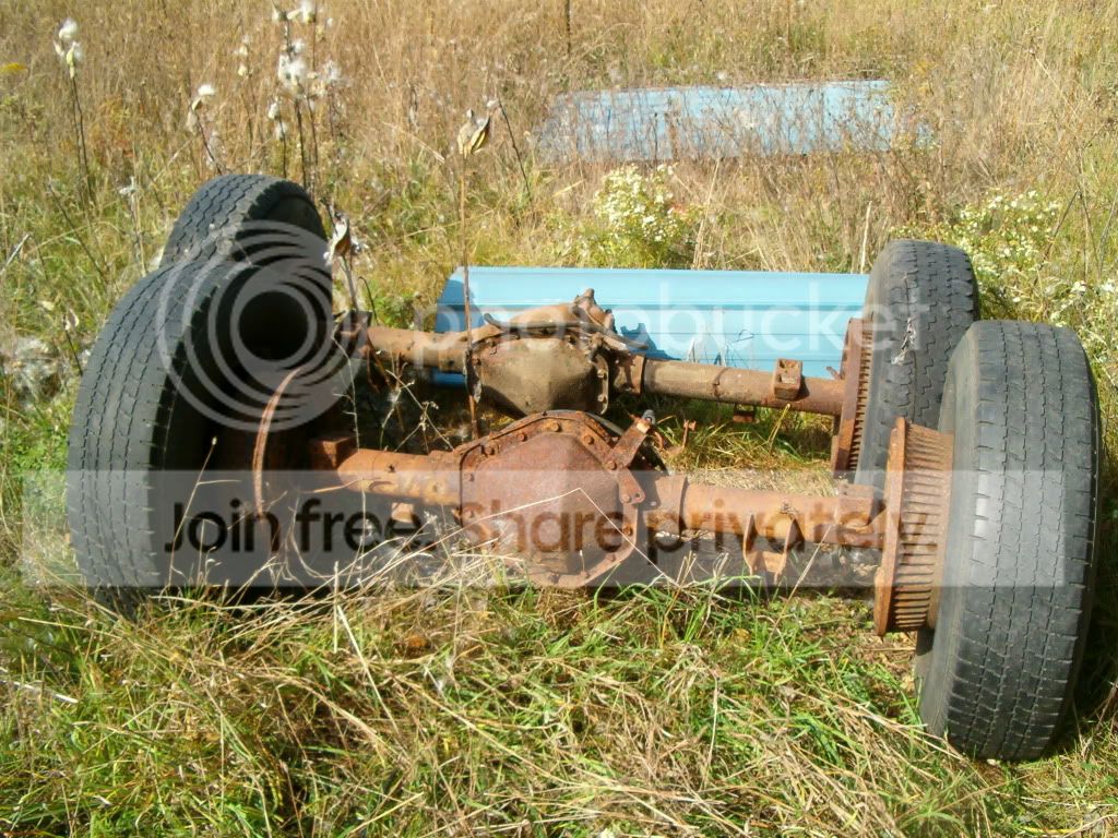

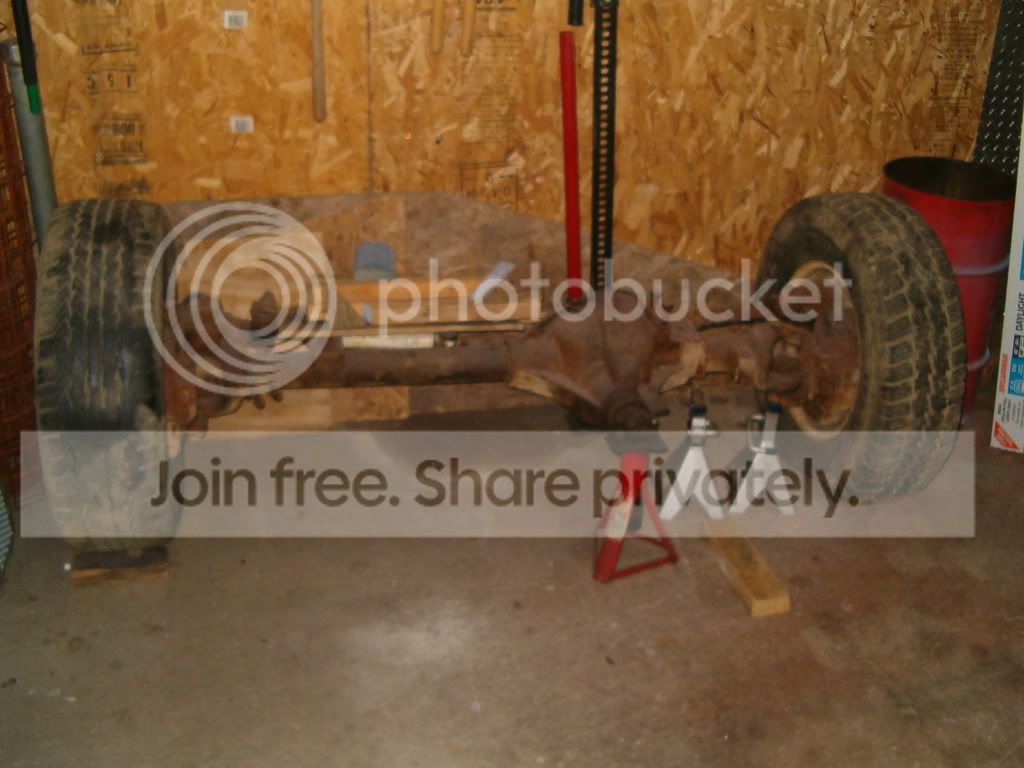

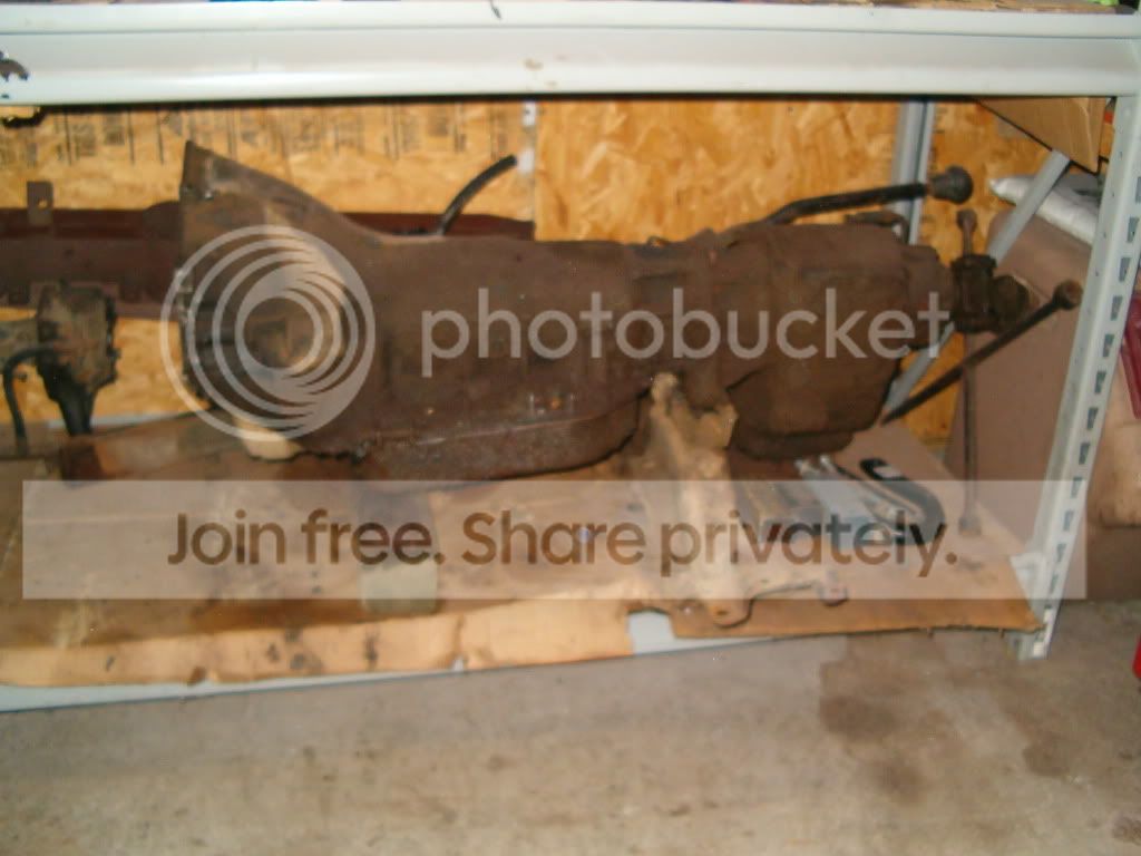

I've been aquiring parts since 06. I found a Wrecker, that had a T400/205, a D60front-Open, and a 14BFF rear with 4.56 gears in them. The rear C&C axle has a open diff in it, which has some abuse, and the C20 parts truck mentioned earlier has a 14BFF with an open diff in it. So I will use the open diff carrier w/ 4.56 gears in the C20 axle, along with a Detroit Locker.
Some spare transfer cases:
a 205 from a T350, and a 203 from a C6

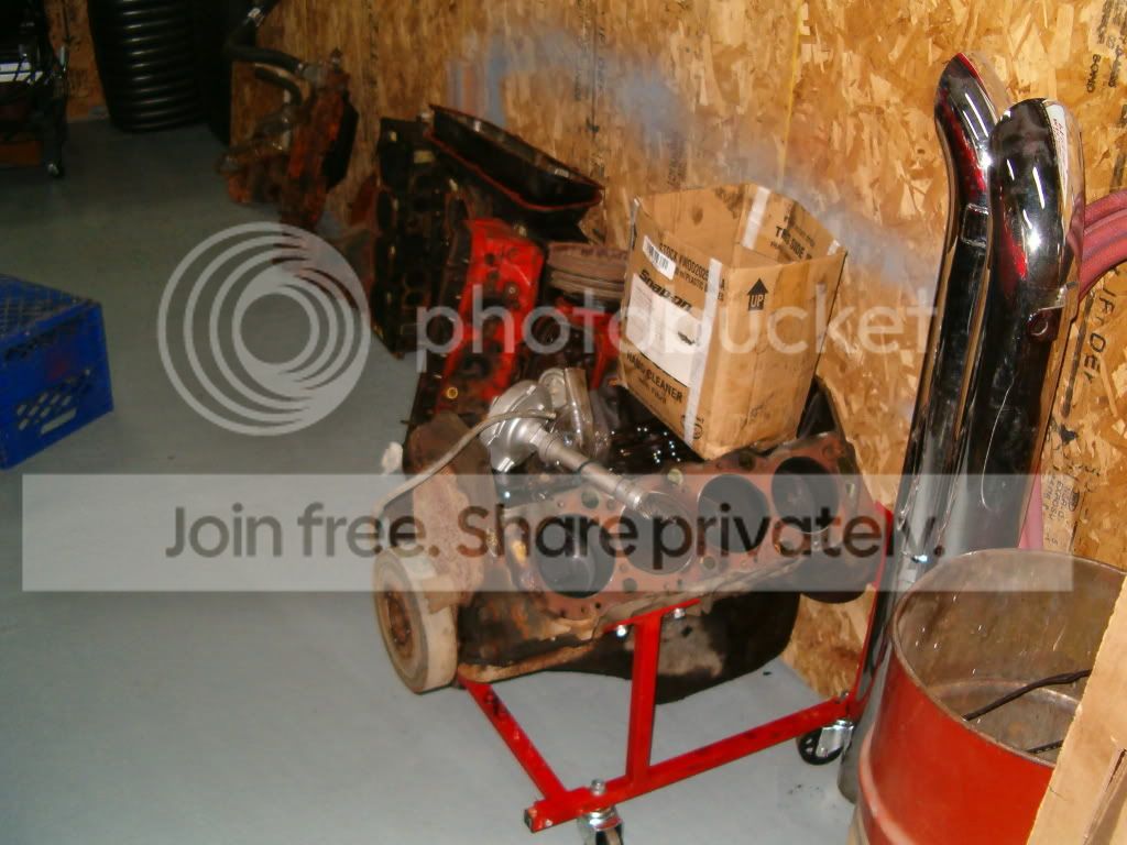

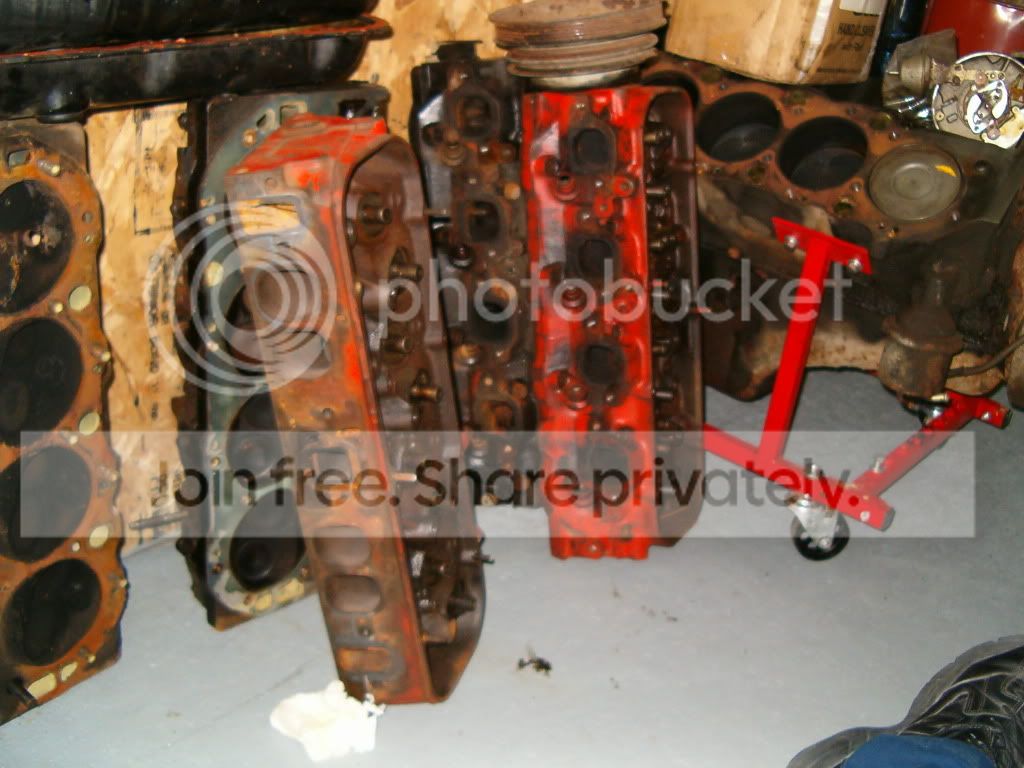

I picked this up for 500$ off Craigslist, with 2 sets of heads...one peanut port, the other large oval, but can't really find what the casting number goes to. I think they are 136 heads. I found the set of 781 heads on C/L also for 100$ what a steal. Although they do need to be completely rebuilt, and we will upgrade to 2.19/1.88 valves, and do a massage on the bowls, and gasket match the intake to them.

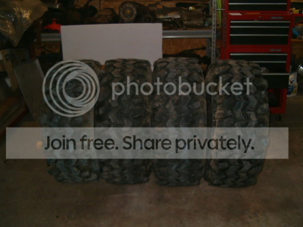

Got these tires through C/L also, put in a want add for 38-40" mud tires, and a guy calls me from 150miles away, and says he's got these TSL's 39.5/16.5 for 600$ but negotiable. I found another deal for some 38? boggers with wheels for 1125, so I took that add with me, and the guy took 450$ for these.

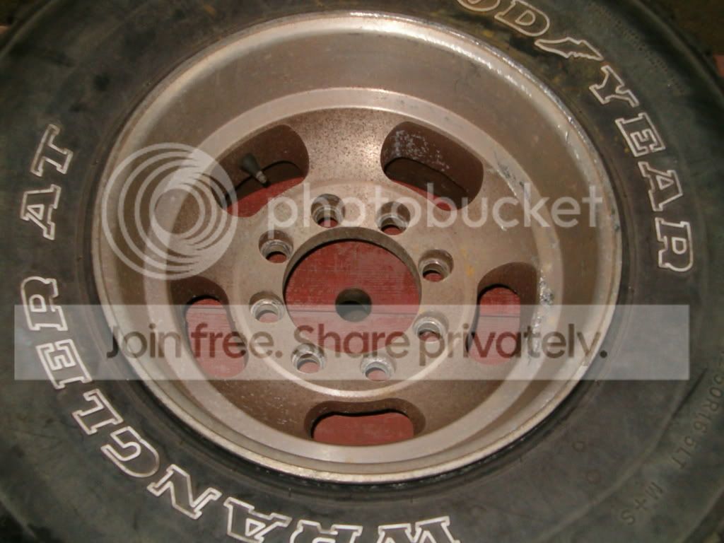

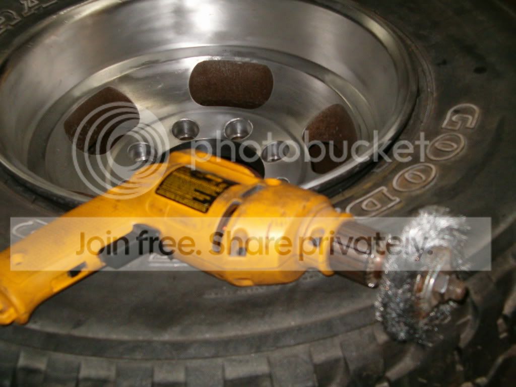

I got these wheels from......take a guess....yep C/L 200$ and a lot of cleaning with a fine wire wheel in the drill. Hitting them by hand produced practically nothing in an hour. I spent about 8 hours on them with the drill, and some polish.
I then had them mounted and balanced with silicone beads instead of stick on weights. The dismounts of 4 throwaway tires/ mounting of the TSL's and the silicone balancing for 4 tires was 105$.

wth is that thing in the middle of the table?
Thats the original 3.55 rear diff out of my Vette. IRS type. It will be going in for a rebuild with the Rear axle for the K5.

Heres a thread(s) on the 781 heads/valve needs:
https://ck5.com/forums/threads/engine-builders-need-valvetrain-help.261656/#post-2610958
And a thread on the 454:
https://ck5.com/forums/threads/big-block-guys-identify-this-block.260762/#post-2599767
