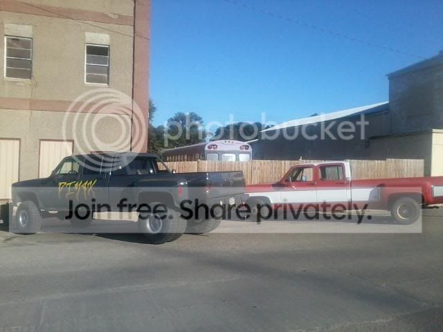

Got a picture of old Faithful today on my cell around 4:00 p.m. Central time.
Sweet.
Doesn't let any grass grow under his feet, does he?
yah Zim left Idaho Falls early this morning.
He should be about 3/4s of the way through Wyoming about now
Zim got to Kerts safe and sound sometime this ( saturday) afternoon evening.
He should make it back plenty of time to spare
Super cool pic
Ahh darn ya beat me to it Eric. Guess I'm not zims pic bi*** anymore lol. Whatever will I do with my free time:haha:
LOL Adam I thought it would already be posted he sent me that at like 1 my time and I didn't get it posted until like 11 my time.
I am ssssssssssslllllllllllllllllllllllllooooooooooooooooooooooooooooooowwwwwwwww
Zim and John, left my place around 8:00 p.m. on their way to Waterloo IA. There last stop for the day. Had a good long chat, showed John some of the equipment in the shop and some of the things we do. Talked Crew cabs and decided Dave got the little crew cab version according to the picture.
Found some 16" dually wheels floating around the shop that Dave was interested in as well as some trim pieces for his Crew Cab and off they went.
Said the new tow rig was performing well and 9mpg on the flats and for some reason, better up through the mountain passes.:dunno:
Nice try, I see water that has run from where the truck isn't parked and pooled slightly under the truck...
