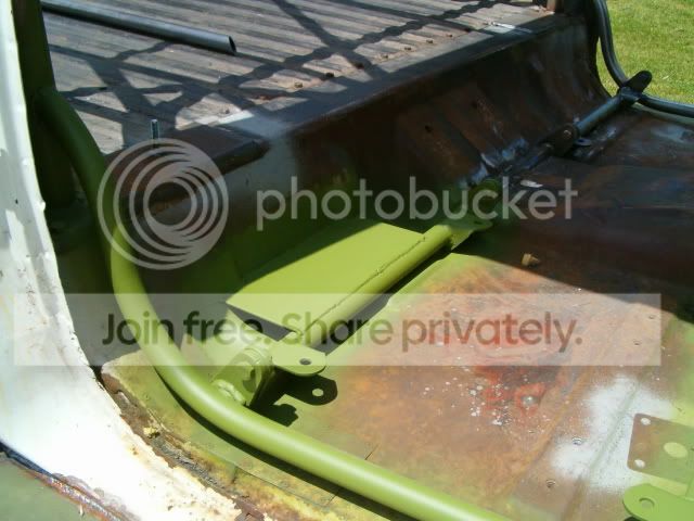

Been working on a few small things, made a plate for the rear of the cage where the tubes come together...its only tacked on but I thought it was a nice addition, and I have a plan for that space!
Added a couple more seat belt tabs, another grab handle, and a step to get into the back without twisting your ankle.
I got the rest of Kerts' tube gussets put in today also.

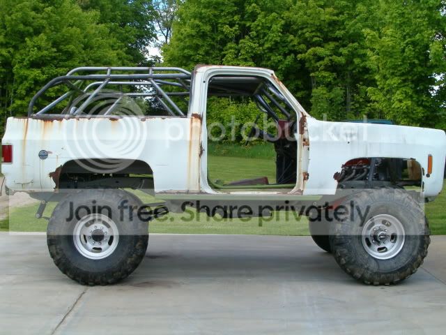

Had a great day with no rain for a change, so I tried the tires/wheels on to figure out the fender cuts.
The black lines give the same amount of spacing between the rear of the tire, as the front has, about 2.5"

Bad@$$ Dave! It looks tough. Nice work.
I would angle the front opening back to the slider, then put the same angle on the back, just move it back so it meets the bottom where you need it to.

take the red section out and slide the other section back. then you'll have to get a couple small pieces of the upper wheel opening lip to fill a small gap there. then it will look like the finished pic when done:waytogo:
Heath I will angle the front fender back to the slider as you suggest, and also cut off the fang some.
The rear fender I will probably move back as Rick has worked in his pic....
I like the stretched look of the opening for the rear.
Rick that is exactly what I was trying to picture in my mind, great photochop on the wheel opening.
