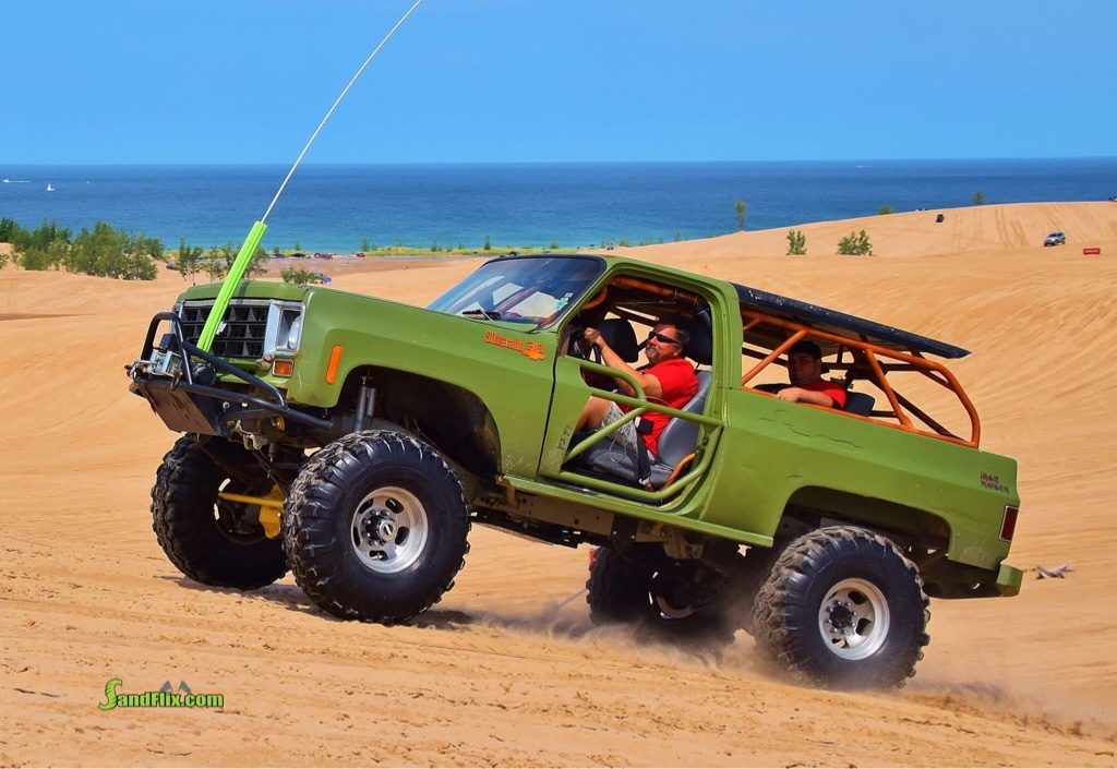

wish I could make it to one of these get together's again..... I STILL haven't rode in the maiden:confused: been fircken hectic and tight around here for a LONG time though
Catching it in a running state is the hard part!
LOL.. about like my burb then:haha: I was about to ask last time and then the tranny decided part ways with it's self:doah: one of these days it'll happen:waytogo: Gotta make a dune party yet or something
Sidewalls are all shiny....he pimped it up the hill and with every throttle of the skinny peddle romping the block to one side even gave it that pimp walk I'll bet!:pimp:
:haha:The little wheeler (3 year old) made me play that video (the forward shot version) on the big screen 5 times.:saweet:
