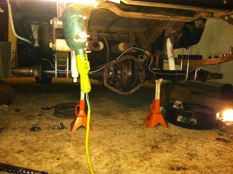

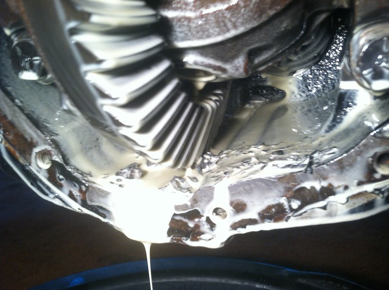

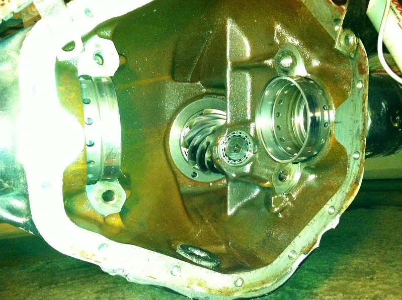

The carnage

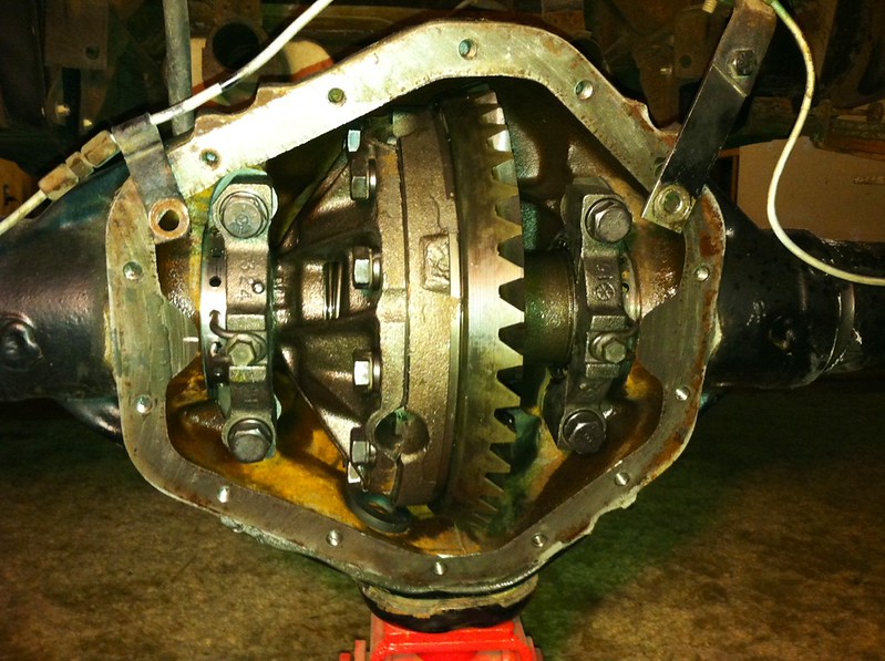

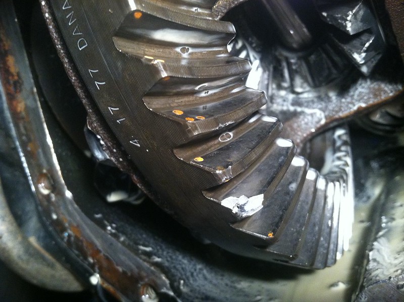

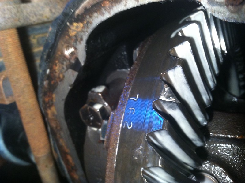

These are the only chips I found on the ring. The Pinion looked fine.

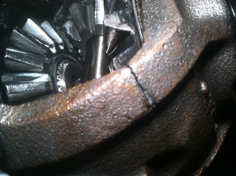

Carrier is cracked.
CUCV 14 bolt. Don't have it yet, still in his rig.
Just swap the guts to your axle, then you don't have to mess with moving mounts.
Martin
Martin
Yeah that's what I am going to do. Completely forgot about that until I looked at the picture. I'll also be doing a disc conversion since it comes with the brackets.

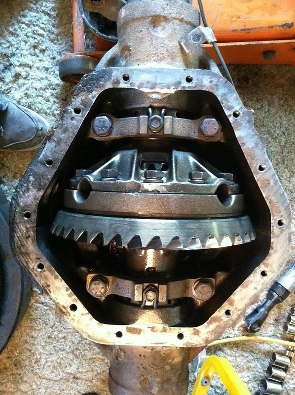

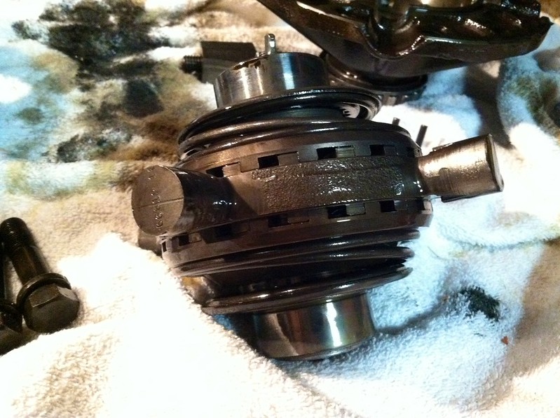

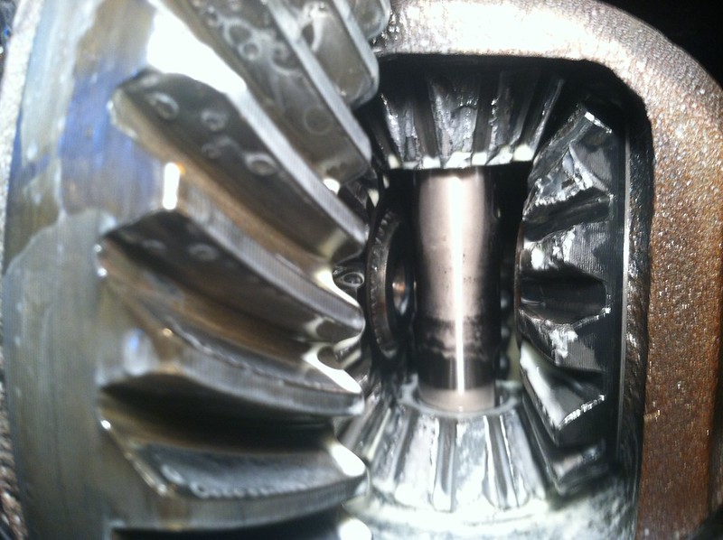

Here is a better pic of the spider gears. I've located a Dana 44 Detroit locker for $335, so I will probably pick that up when I get paid next. Don't really want to drop $700 in lockers all at once.

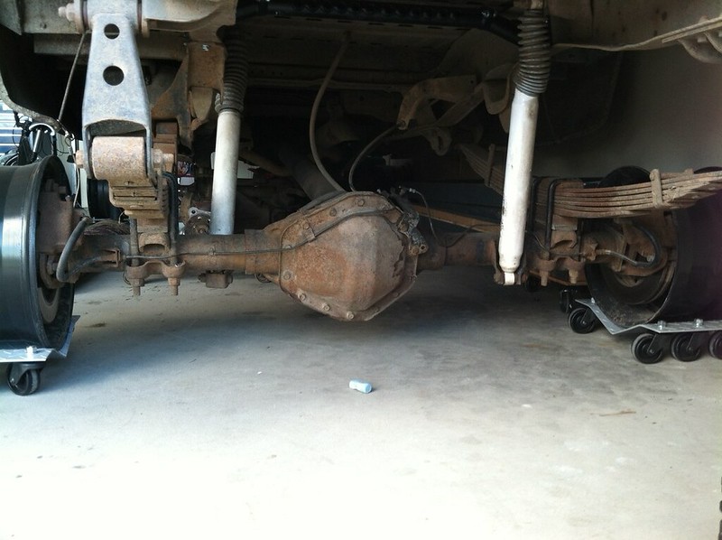

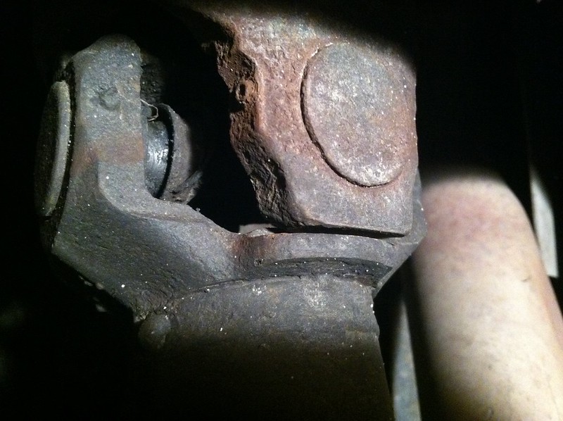

Found I had a busted u-joint on my front driveshaft. That will be nice to not have that banging noise anymore. I can't believe it didn't completely brake for how hard i've been on it.

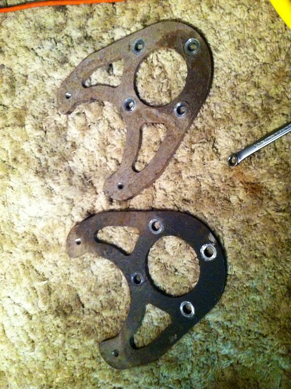

Not sure who makes these, but it came with caliper brackets for the disc conversion.

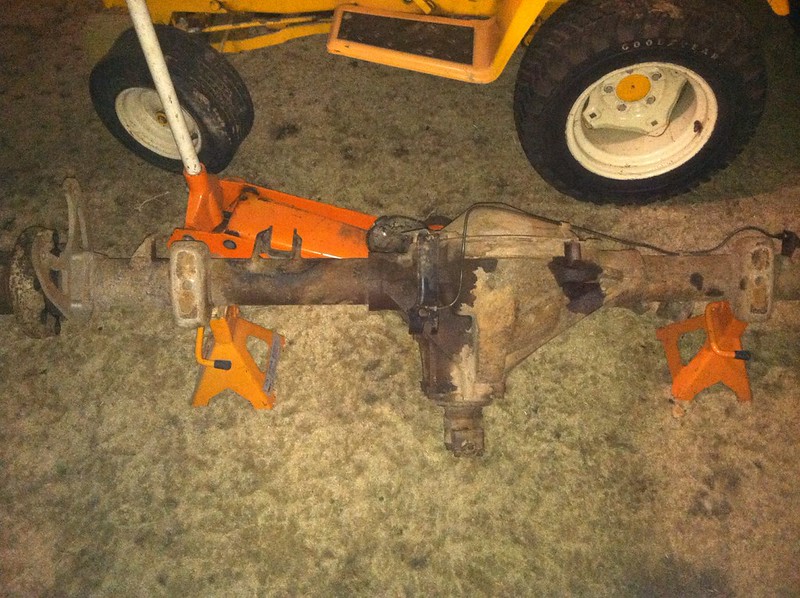

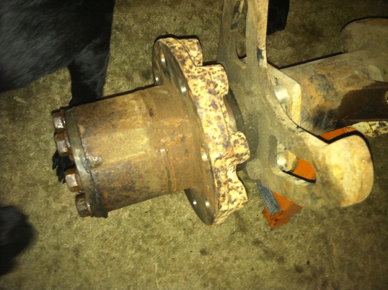

Anyone know why the hubs on this 14 bolt look a little different than my current 14 bolt? The one under my truck now doesn't have the indentions on the hub.
I think it may have come from under a one ton van originally. How wide are the van axles? 69"? I'm sure someone knows.
I think the 3/4 ton and 1 ton truck axles were the same width, they just had different locations for shock and spring mounts. Could be wrong though.

Got both 14 bolt carriers torn apart, guts swapped, and put back together. Both axles turn very smoothly, I hope it stays that way. In all honesty it was pretty damn easy. The only hard part was unbolting an torquing the ring gear bolts cause it was so hard to hold. And holy **** that is a heavy carrier! Tested out the Detroit by jacking up the rear diff and it works great. Can't wait to really give it the test.

Open CUCV 14

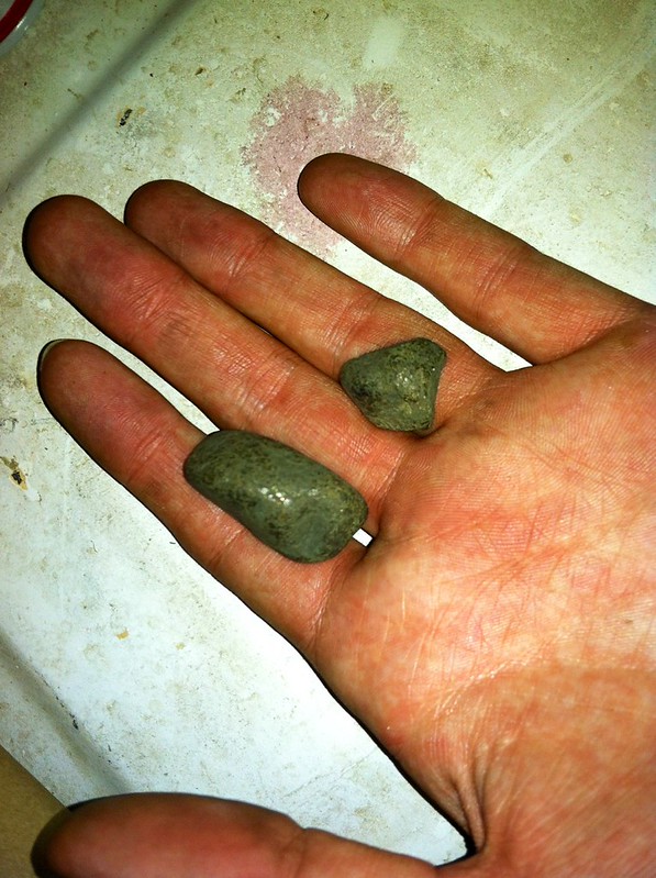

Got done with that part, so I moved on to the disc brake swap. Pulled these rocks out of one of the drums.
Brackets need some paint.
