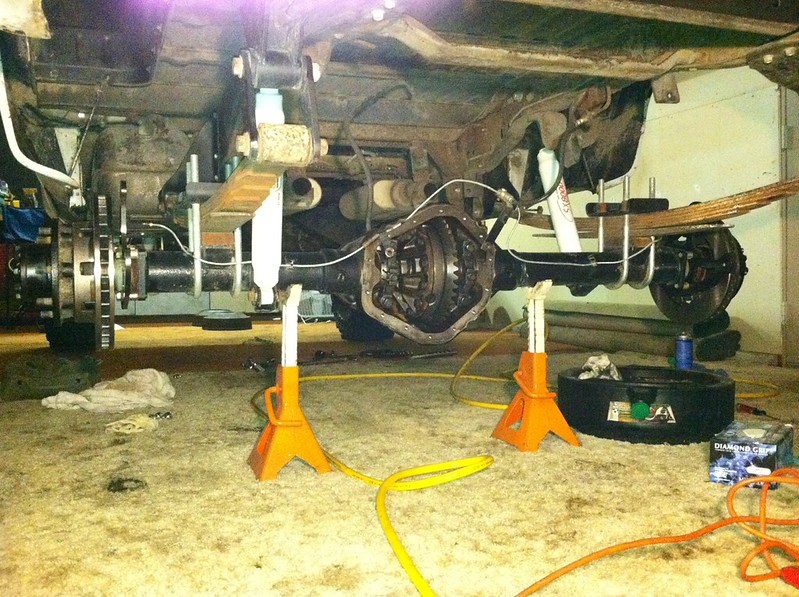

Your garage is carpeted? Sweet :D
Nice job dude :thumb:
haha shag carpet! It's a barn at my Dad's house. The house was built in the '70s so when they re-carpeted it, we just threw some of it down there. It's actually kinda nice. Like working on your truck in the living room :woot:.

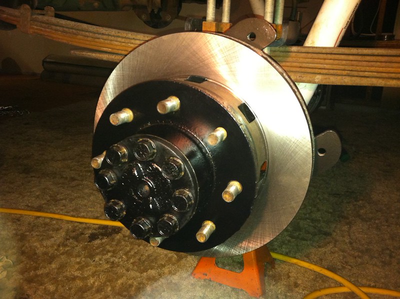

This hub is from a dually by the way. Guy I bought it from took it off the HD70.
Yeah I think the HD70 is narrower which works out for the offset of the H1 double bead lock wheels. He obviously didn't want to use the 70 hub. I just put 2 and 2 together after taking the hubs apart.
Instead of 2 nuts and the lock ring on the SRW axle, the DRW axle has on big ass nut with a key way and a clip.
The 70hd with the 14 hubs is wider than the 70hd is alone.
Chris? Yes is the answer. He needs to use the hubs on his truck.

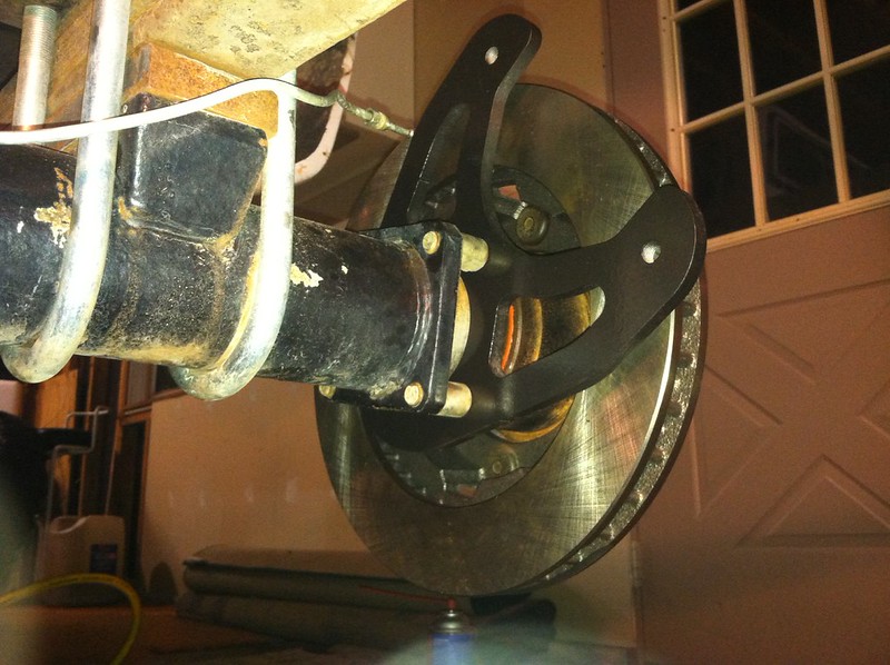

Still need calipers and the rear will be done so I can start on the part I broke. Its going to be like this for a while cause I ran out of play money for this thing.
