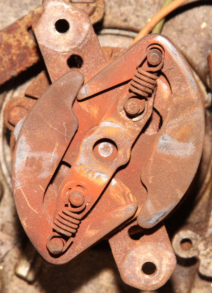

so we took the distro apart.. as we were he said.. your weights arent working..
so my 1977 monte carlo distro weights.. had the stock worn out bushings.. giving massive slop.. the stock springs were all loose... then we realized the one weight was jammed onto the other.. and when i put the new rotor on i locked it there... so the weights couldnt do their job.. but it was all bad... well replacement kit would be $20... i decided to scrap that..

here is how my distro looked.. old one of course... 1977 monte...
see all the wear spots? you can see the tips of each weight.. how they were locked...
DistroWeights by TeleFragger / RootBreaker, on Flickr
