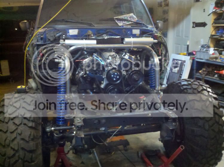

79 K5 H-Bomb build
454 with 049 heads, roller tip rockers, and a performer rpm intake... beyond that I'm not sure.
So someone put differnet (better) heads on it because those TBI blocks came with peanut port heads IIRC. Sounds like a good platform to start with.
Iirc, to use gen IV heads on a gen V block you need special head gaskets. Keep that in mine when buying rebuild parts later.
yeah, I used a set of 049s (had them port matched them and bigger valves) on the fj60 build... the motor was stout but I wasnt worried about emissions.
edit: photobucket sucks.
That's a healthy sounding BBC.
And I don't see why an 049 head won't pass a tailpipe test. The cam, ignition, EFi and of course cats are going to play a larger role in all of this.
yeah, i've been researching the "magic" combinations to make it worth it to build the BBC (havent found it yet). My definition of "worth it" is building at least 450hp/500tq. Going the the retro roller cam seems like the easiest way to get there.
my buddy has those kind of numbers in his K5, it's a beast for sure.
It sounds like you've already made your decision, but yeah I'm all for the BB in the K5.
