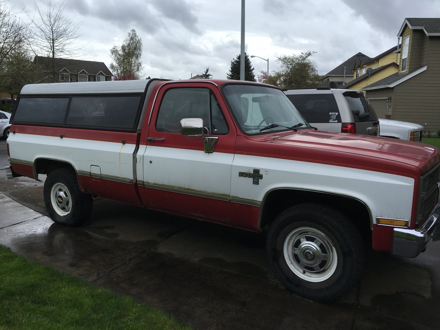

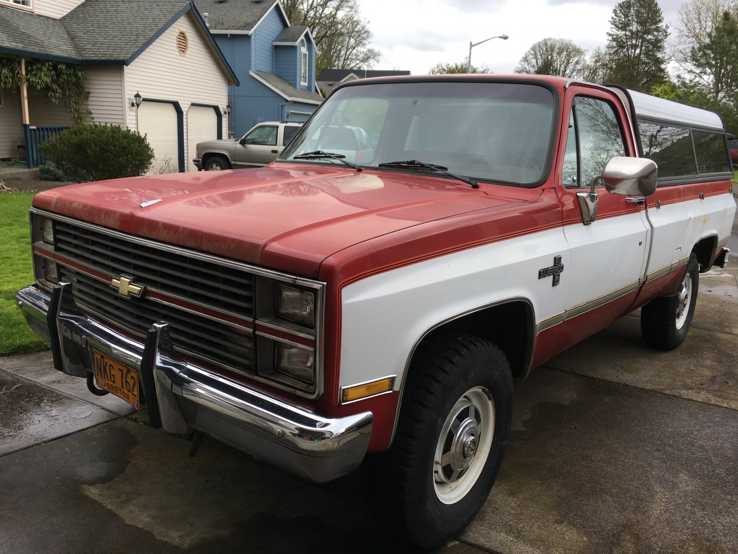

The last factor is that I found a nice 84 k20 for a steal of a price... but has a bad 350 in it.
full
full
I COULD just take my 355 from the blazer and literally just bolt in there and have a running truck.. THEN just build the 454 and put it in the blazer. Right? Help me. It's just money right? lol.
