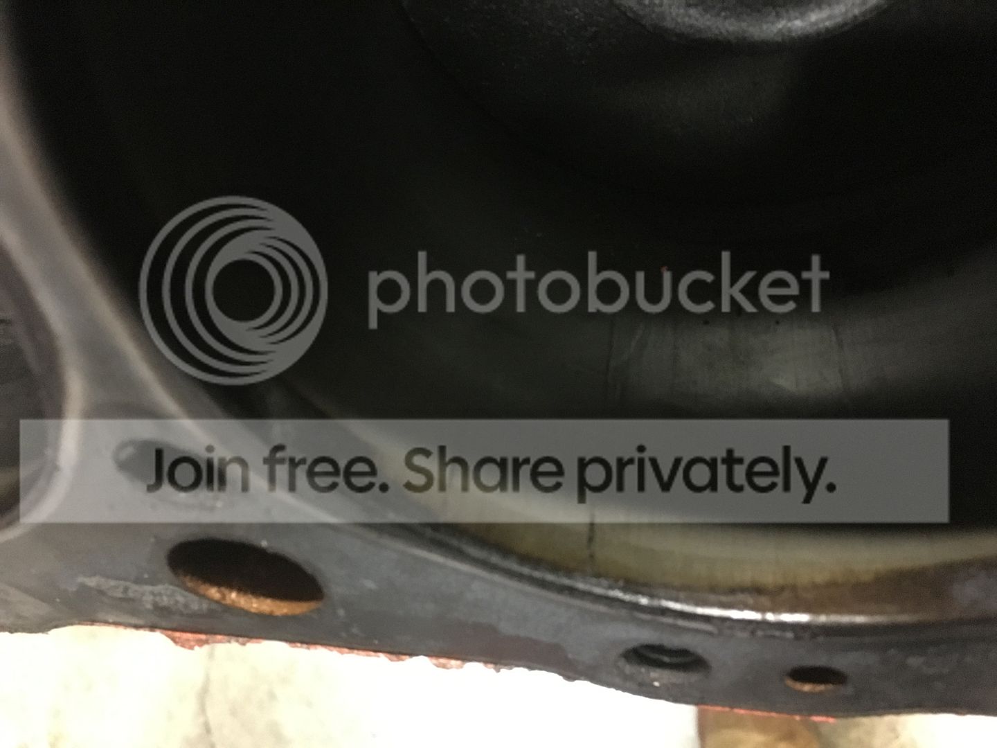

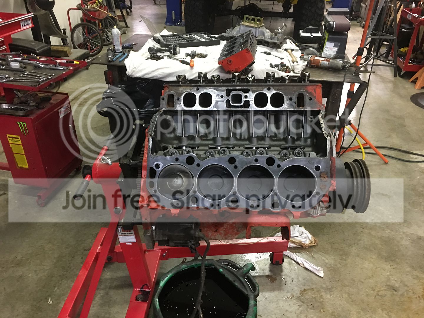

Well not so good news... I got out in the shop tonight:
I can catch a finger nail in there pretty darn easy.
Bummer.
well, I called it for now. Called the fella with lil red and told him that I would not be taking it home. I think I'll stick with the small block for now and stick the BBC in the corner for another day. I just want to get this pile of junk back on the trail.

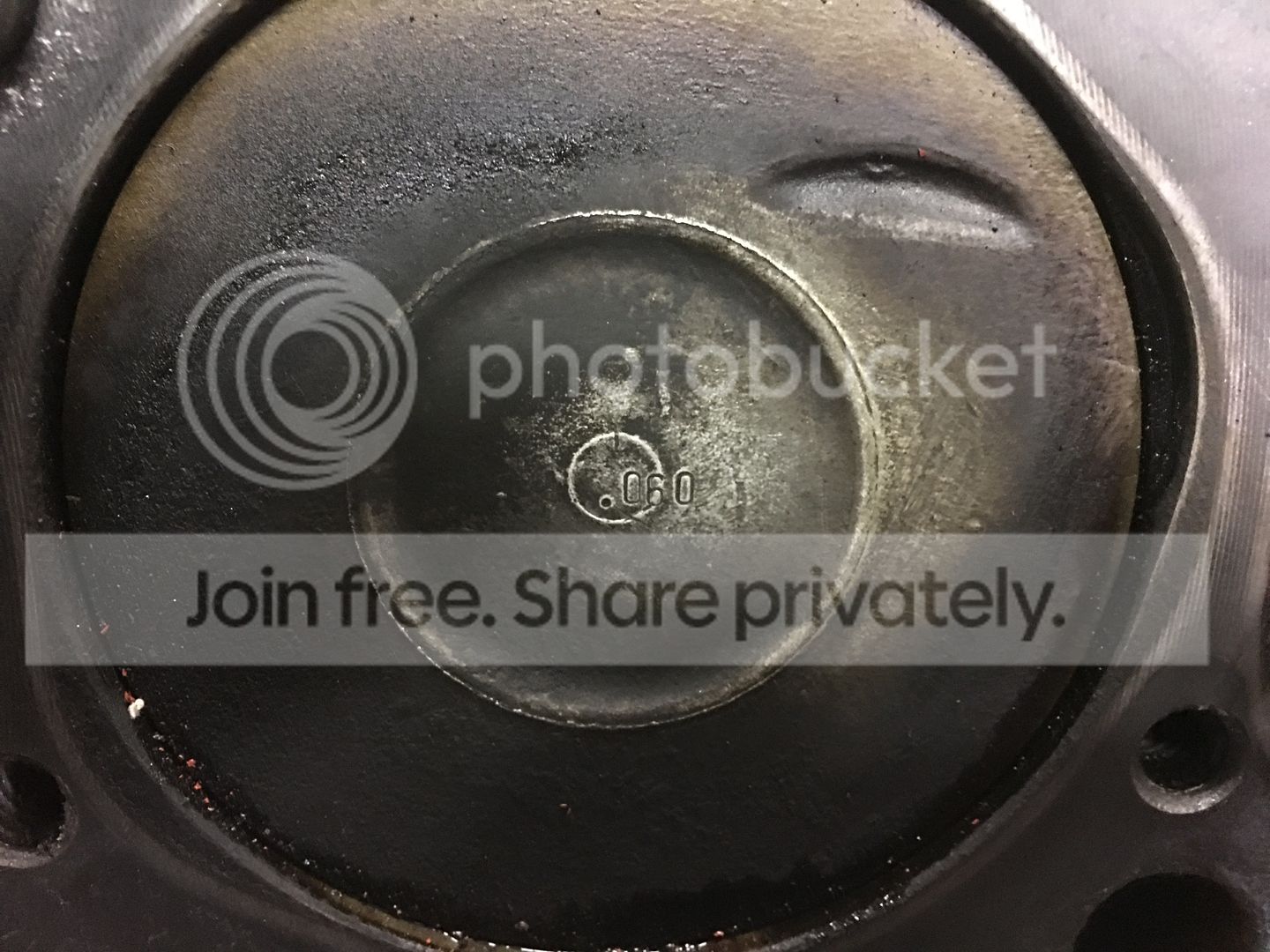

You'd have to do the research, but certain year big blocks can take a huge over bore. I think .125 over is possible and is one of the ways people are getting big displacement rats. A super quick check shows several pistons available at .070 and .100.
Yes, I'll eventually go that route....
