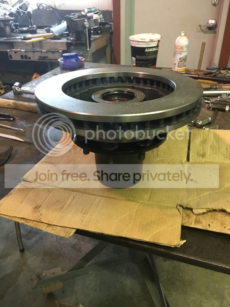

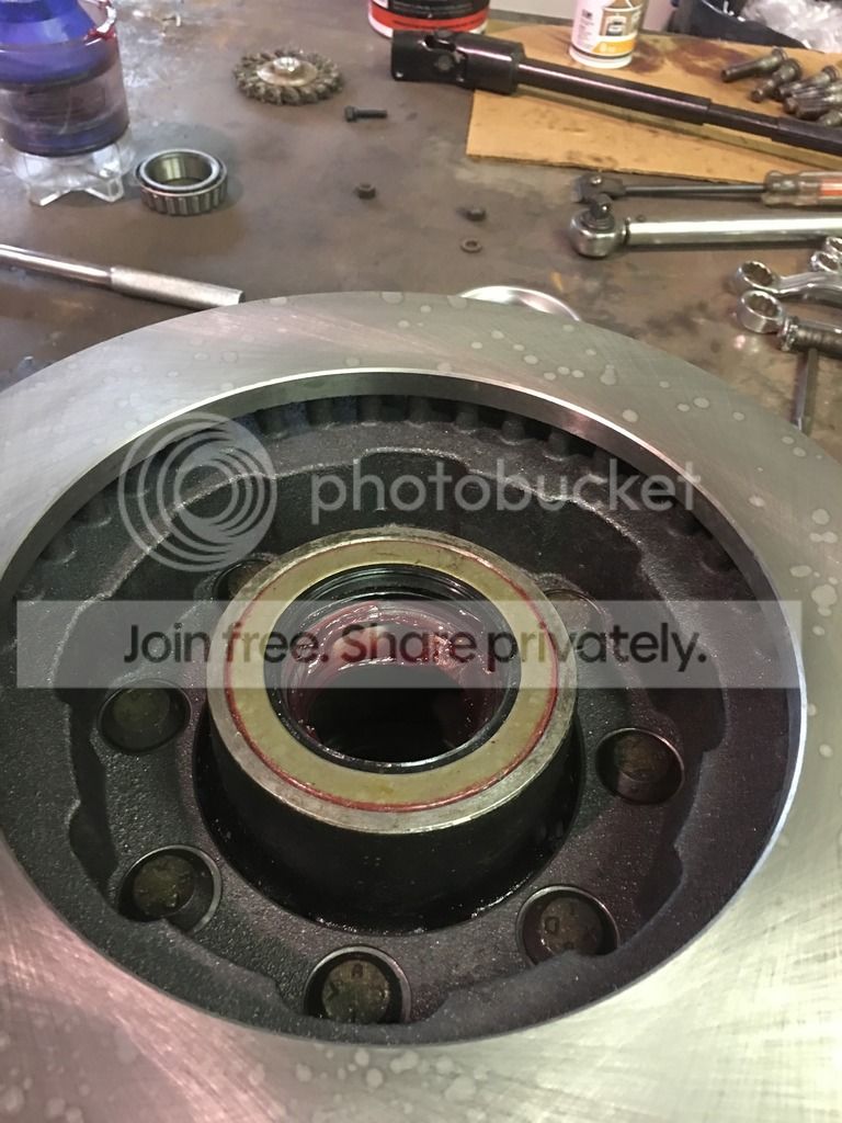

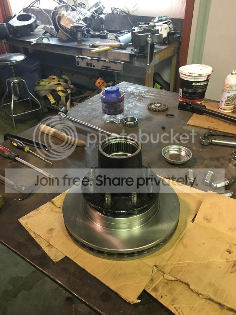

Got rear 56s ordered. Started getting the front brakes on. 20 ton press vs brake rotor/wheel studs.

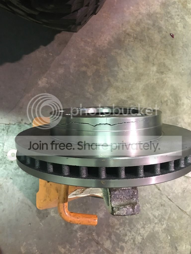

Rotor lost:
I assume you were supporting the rotor where the pads ride on it?

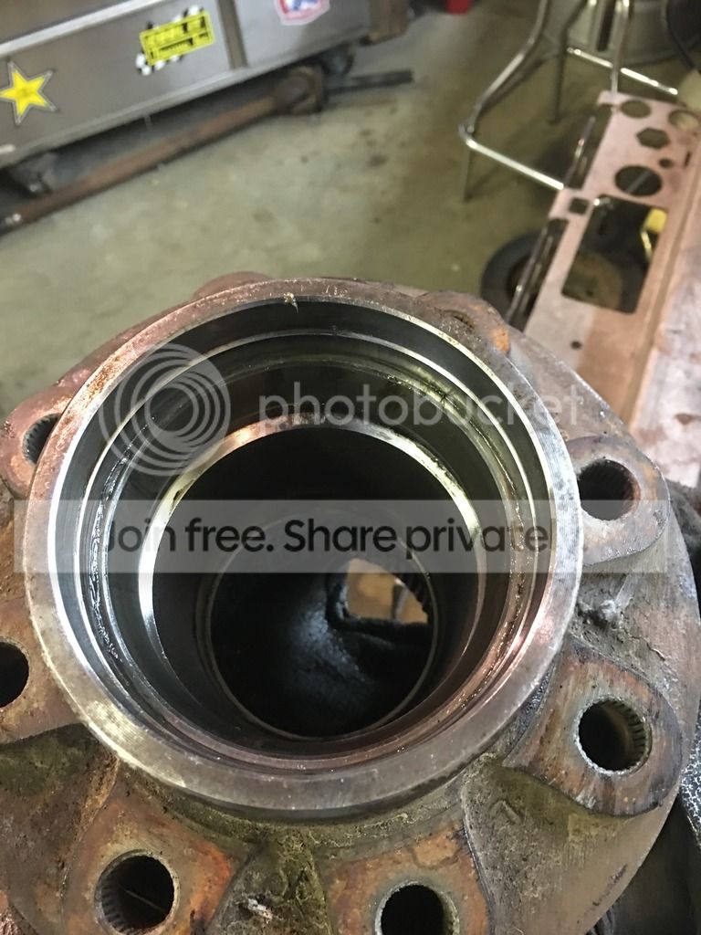

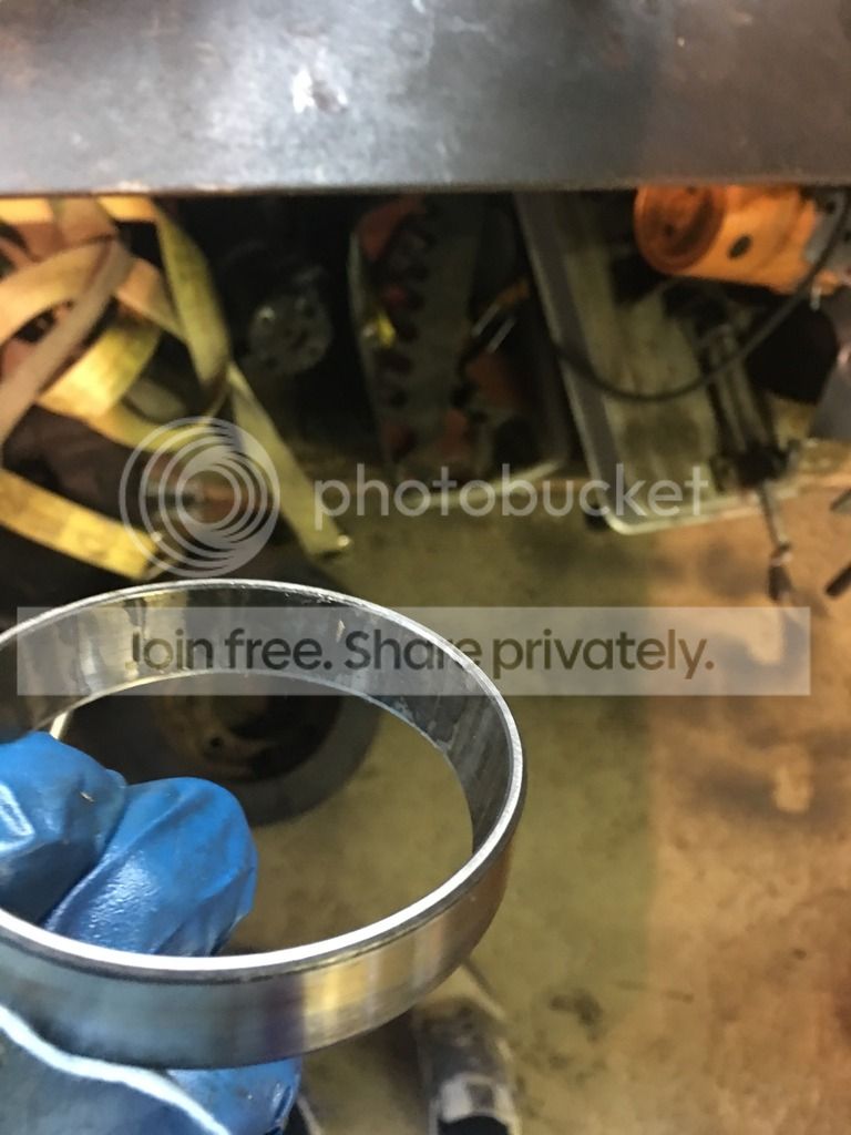

here is another example of the previous owner's idea of a "recently rebuilt front end"... over the years and various builds I've learned to check.
scorched races:

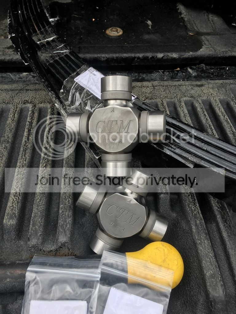

Getting close to wrapping up the front end... got some goodies coming tomorrow.
