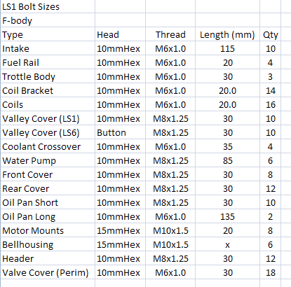

Today has been fun. I drove downtown to pick up my engine around 2. When I got home I quickly realized that gen 3 engines are fully metric. This being a non metric house(I only own old vehicles and am an aircraft mechanic) I had no 10mm bolts to use to hoist it out of my truck. After some research the motor mount bolts are 10mm so I used two of those. That also made me realize the bellhousing bolts would be 10mm too. So I ordered some ARP ones. Once I finally got the engine into the garage. I pulled the bed off so it would be easier to hang the tank and make the exhaust, pressure washed as much of the underside as I could, then pulled it in the garage and started ripping it apart. I got the core support off and the old engine out tonight. Interestingly enough its the original engine to the truck, and it doesn't look to have been rebuilt. Well the deck wasnt surfaced at least since the vin is still up front. being a 207 casting and a M code vin I'm going to guess its a 4 bolt main but I don't care enough to open it up. Tommorrow will be cleaning, painting, going through the wires, and bolting stuff onto the new engine
