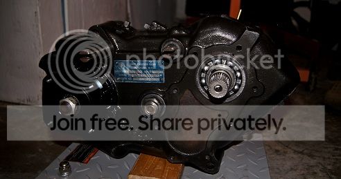

mmmmmmm...... rebuilt transfer case. so clean.
