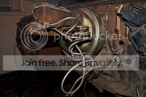

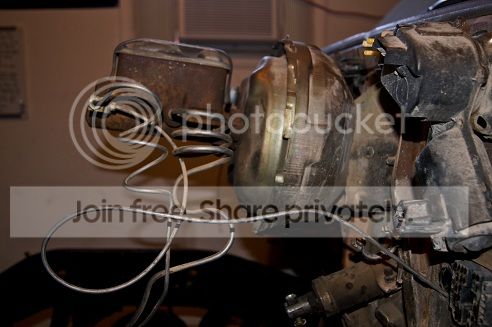

3) i've got an old electric brake controller a previous owner spliced in and hooked up under the dash..... it has a hard line that runs to a T into the brake booster? do i need to drain all brake fluid from this to remove this line? should i just leave it?

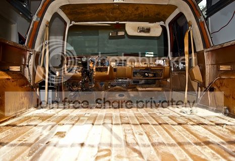

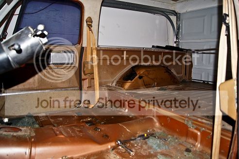

interior is now stripped out. all fuel lines are out.
no rust underneath my carpet! **** yea!
found 62 cents under everything.

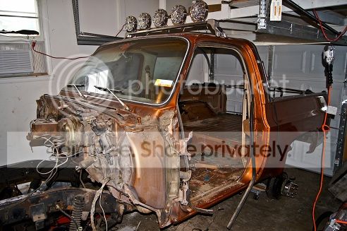

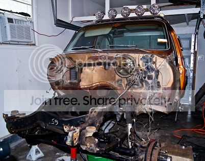

after the one inch body lift, frame painting is next, followed by engine installation.
i've bought a bunch of tools just for this swap. my tool budget is about a grand, including the engine stand, cherry picker, transmission jack, air compressor, air drill, etc.
i finally got em all out. used an electric grinder, ground off the heads, took my air drill and drilled out the center, and then took an air hammer and finally knocked em out.
rivets are pretty ****in tough man. i had all four heads completely ground off, and i was still lifting the entire truck by the engine cross member with a hydraulic floor jack. crazy.
also, engine cross member is out, and so are my body bolts. the bolts started to rotate freely as they came out, freaked me out, but it was fine. just kept turnin em and they dropped out.
gunna get my body lift on, and the frame painted, then installation starts!
