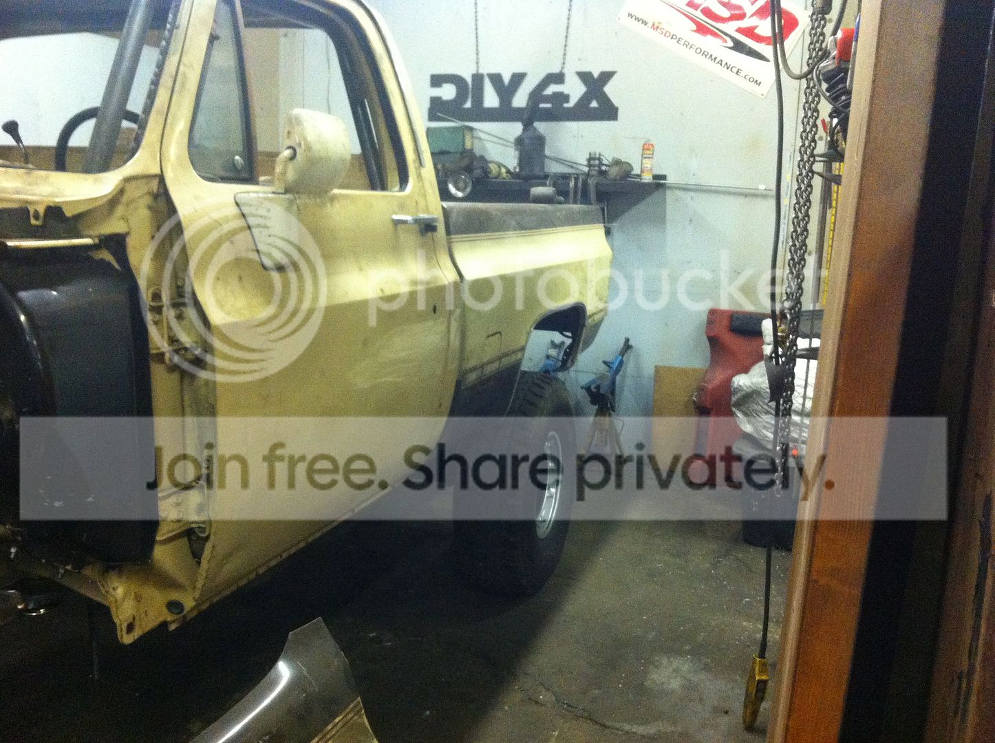

As you can see, my front cross member is an issue. Pretty much the way I saw it when I tacked it in place. That's ok though. Its still doing its job for now. I'll have to redesign before I can put the crank pulley back on.
Engine needs to go back about 1.5". Then I can tack the engine cross member in place and get a support underneath the trans. My hoist is holding up the rear right now.
I think after that, I will make a decision about the steering box and get that mocked up.
Lots of firewall work to do. Tcase/doubler stuff needs to be sorted out as well as the front clip mock up.
I need to get the box dug out and see what kinda shape its in. Might do that this weekend sometime if time permits. Got an extra set of hands around this weekend so that'd help. Gona start snowing soon I hear. Definitely don't want to dig it out of a snow bank later.
