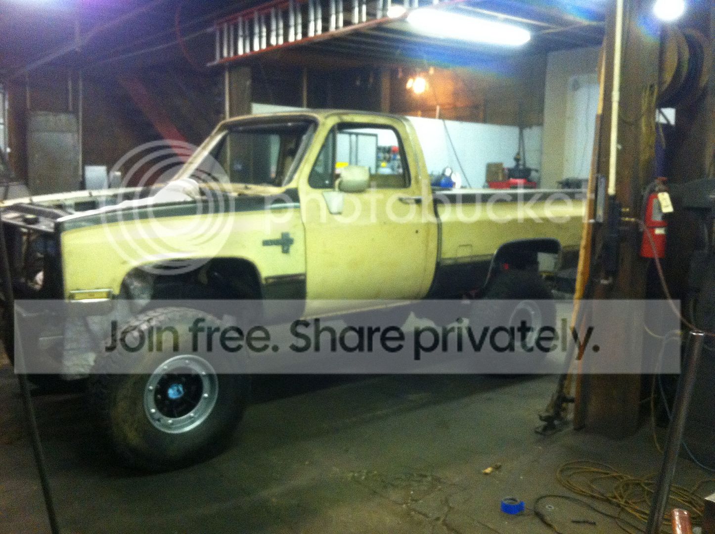

80's short box, "S.E.R.E." Box permanently attached to the cab.
That two tone is nice but it says "Chevy" just a little to much for this build.
That's a good looking color.

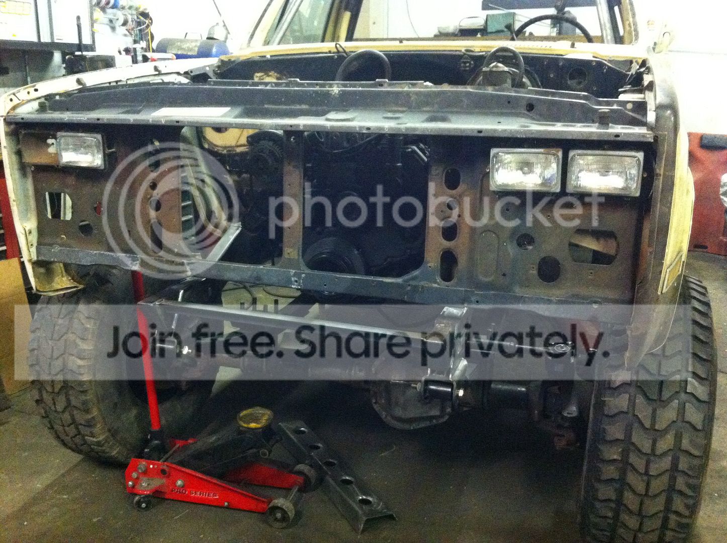

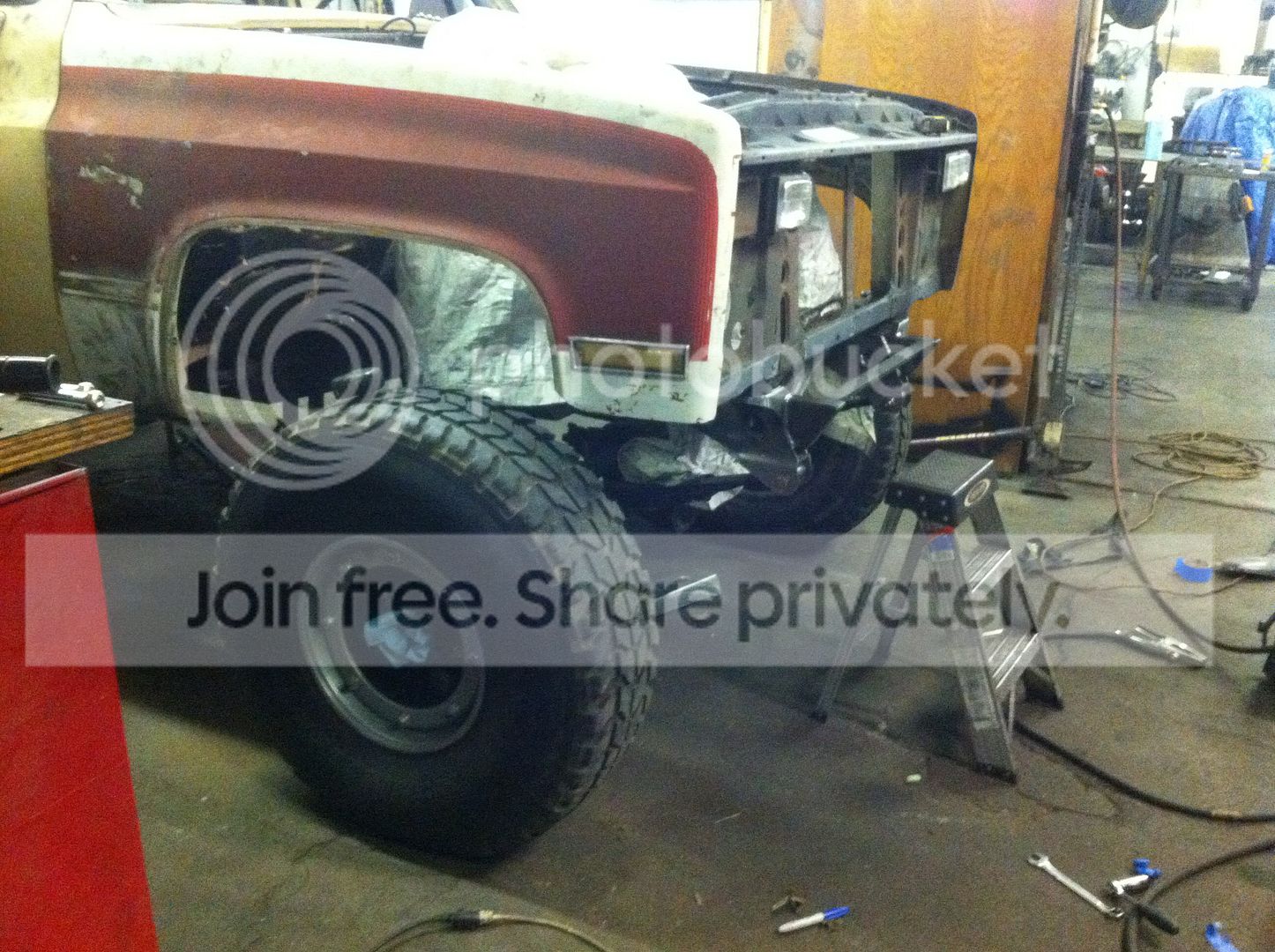

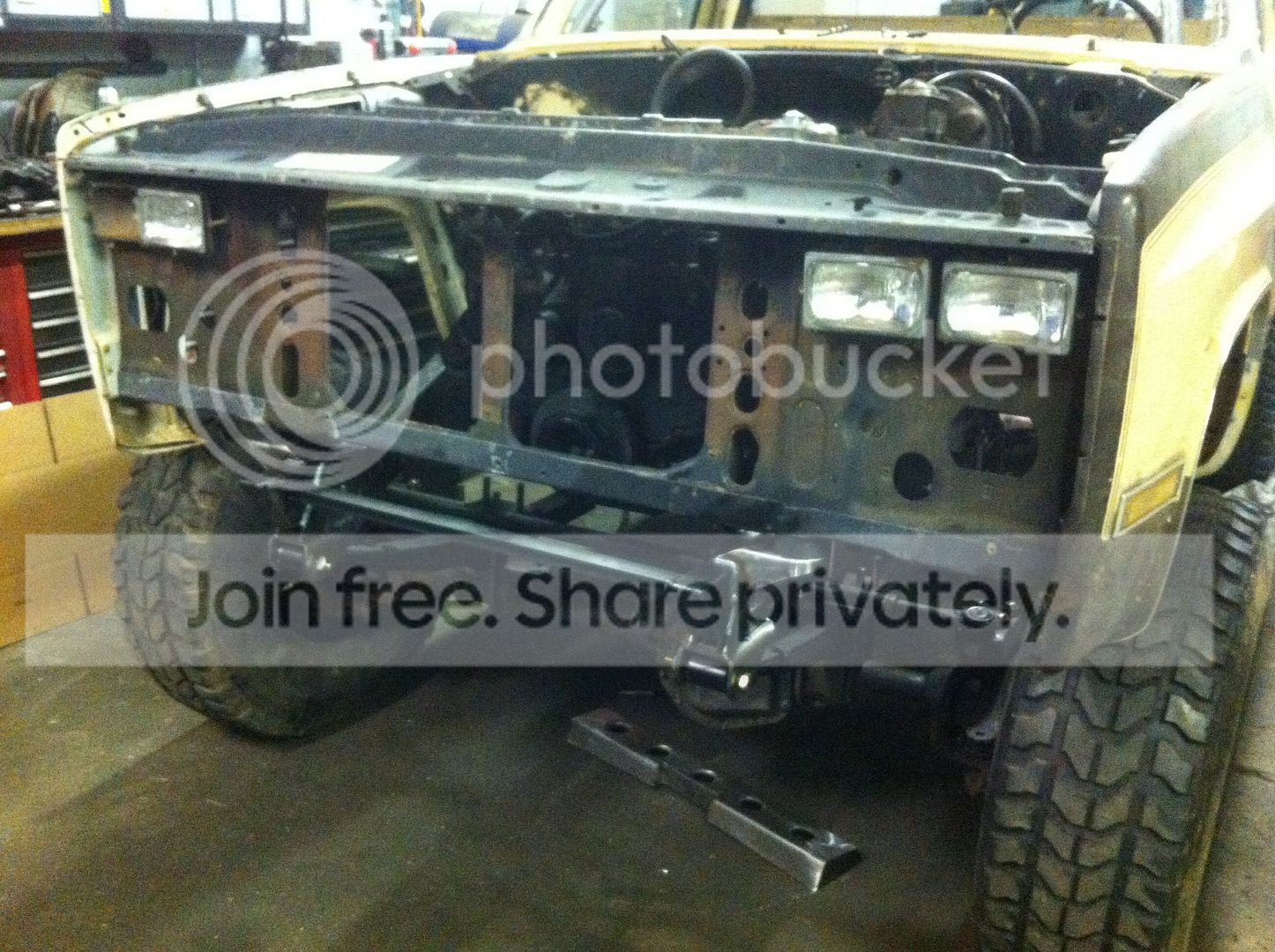

Got the radiator core support set in place tonight.
Got a lot of work I can do now. Finish up all the body mounts, I can mock up the intercooler, radiators and such. Cage work can continue.
So much to do!

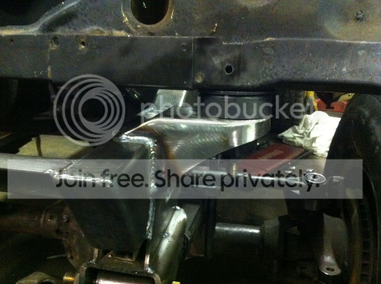

Had to set it up this way so I could visualize some options for mounting the core support. Currently the bolt holes for the body mounts are right above the frame rails rather than off to the side like our old Chevy's usually are. Which was expected of course. This is the second of the two major drawbacks to not narrowing the front of the frame rails.
I haven't slid the body mounts between the core support and frame yet. Got a couple different options though.

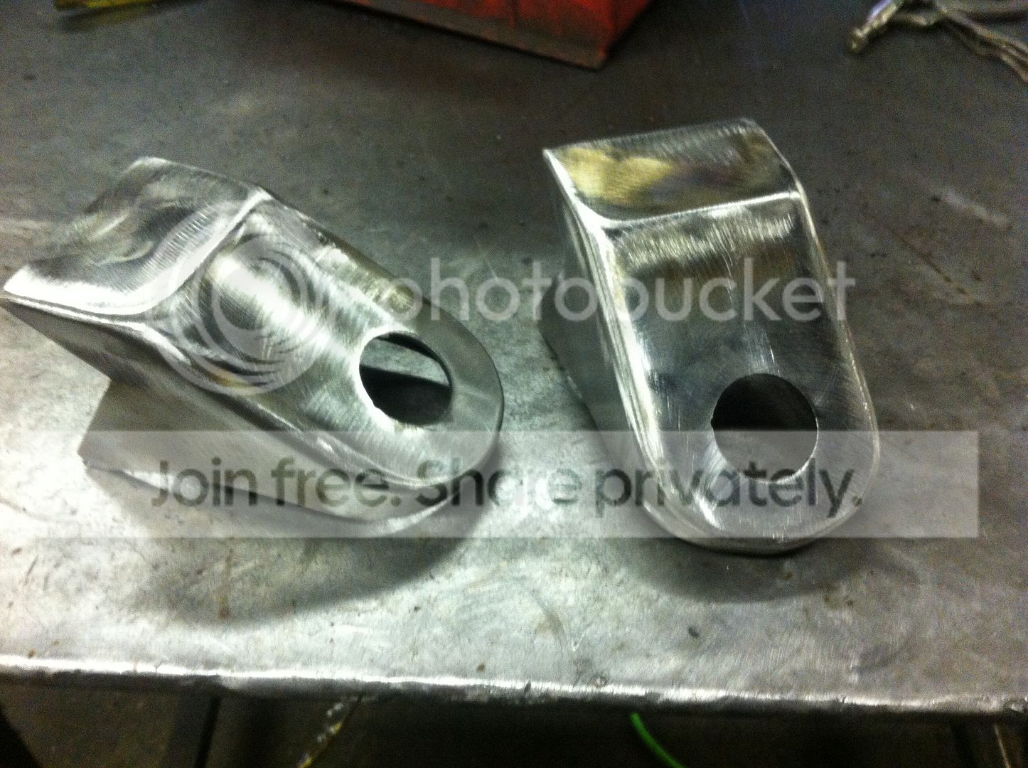

On another note, the second new product coming from this build is in the works!

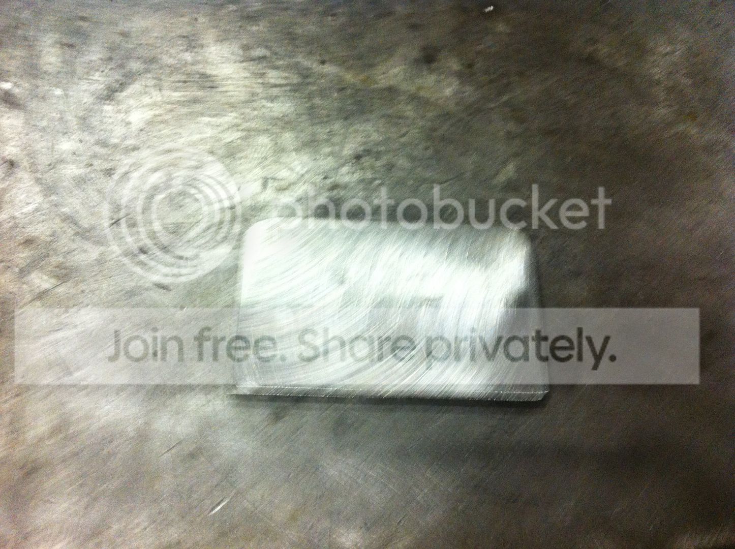

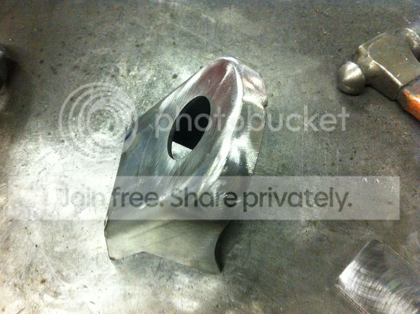

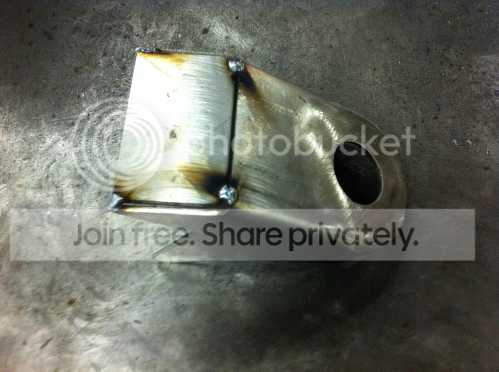

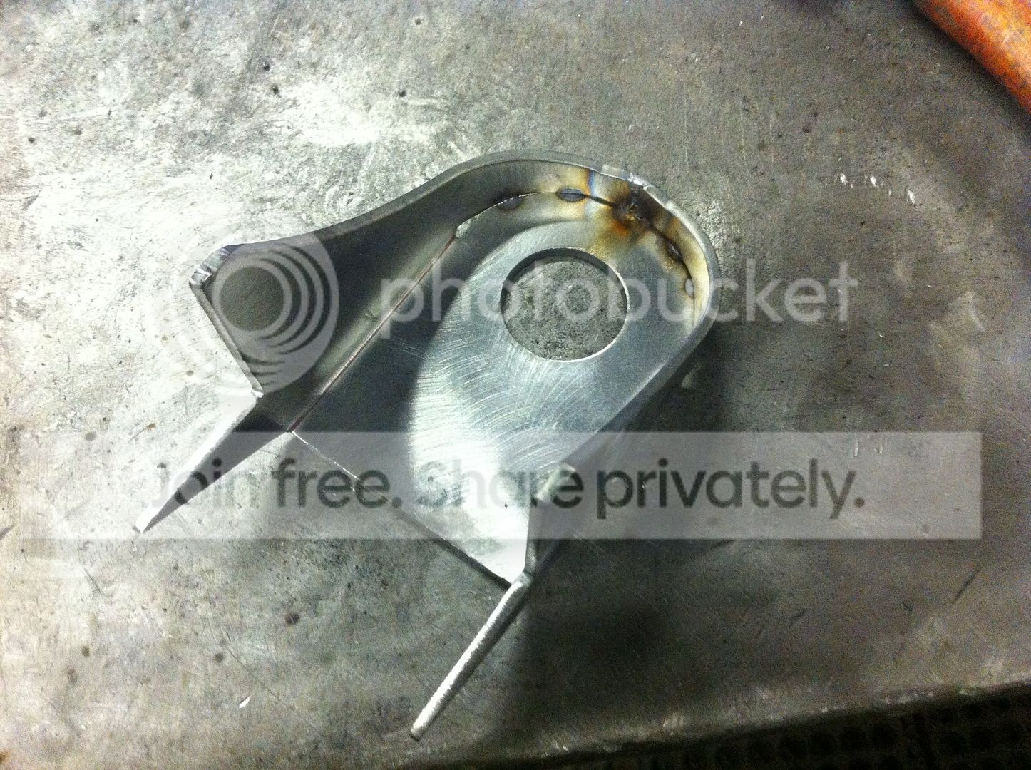

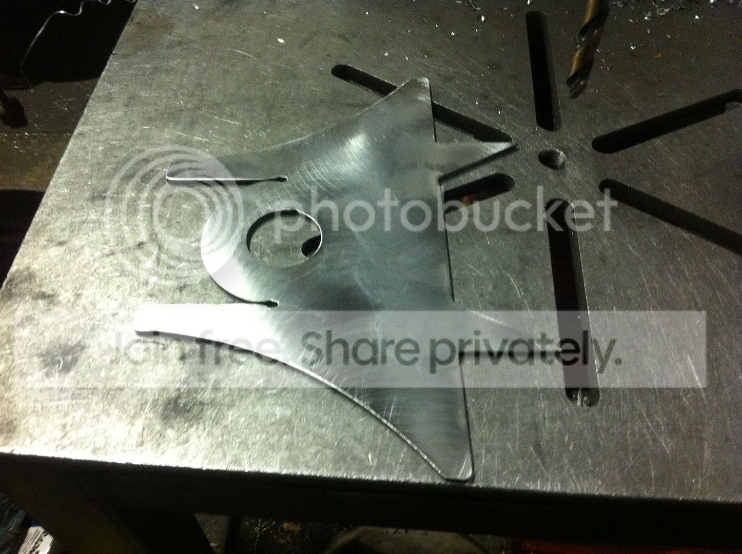

Start with one of these,
smash it a couple times,

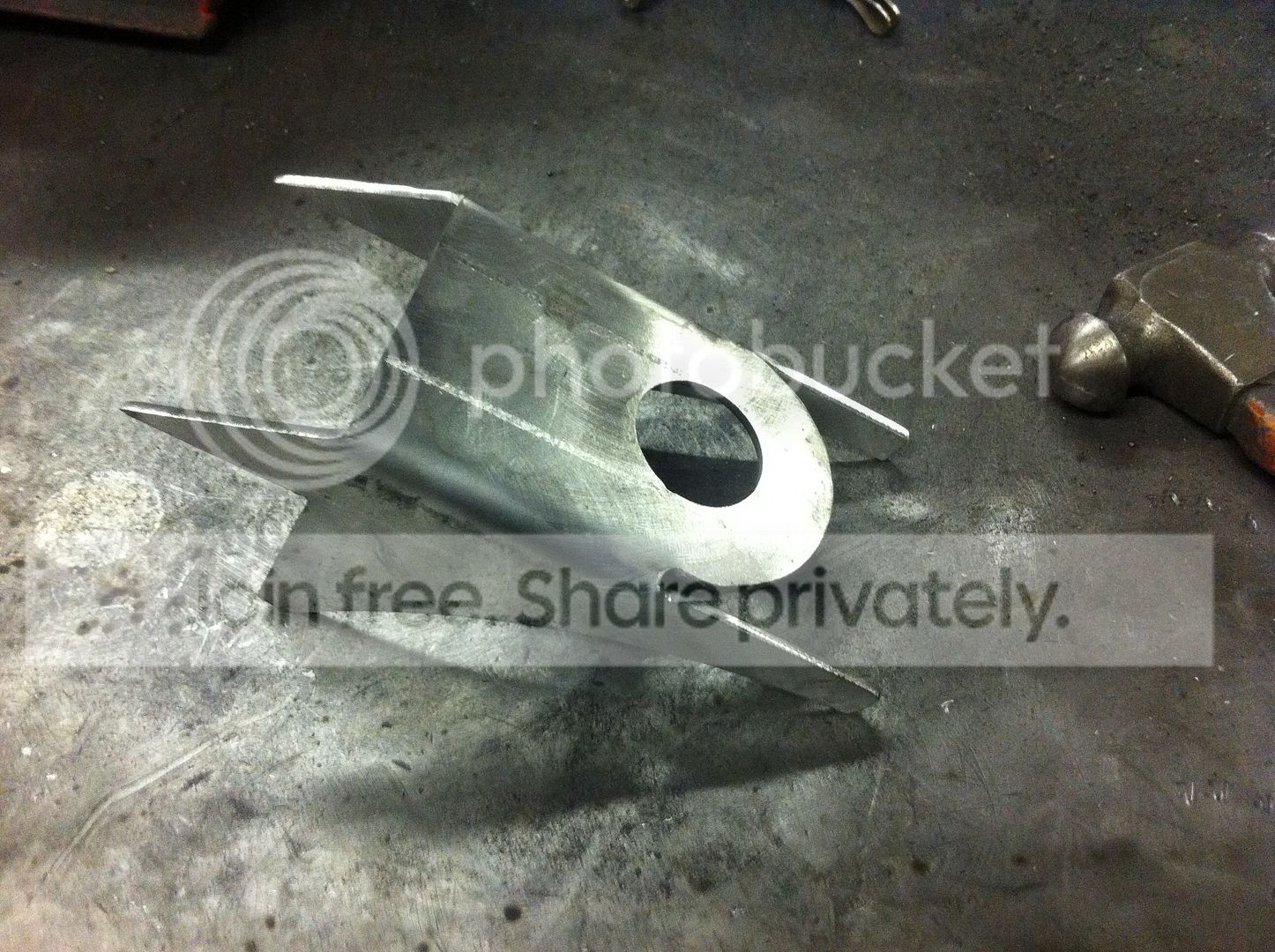

roll the ends and tack,
weld and clean up,

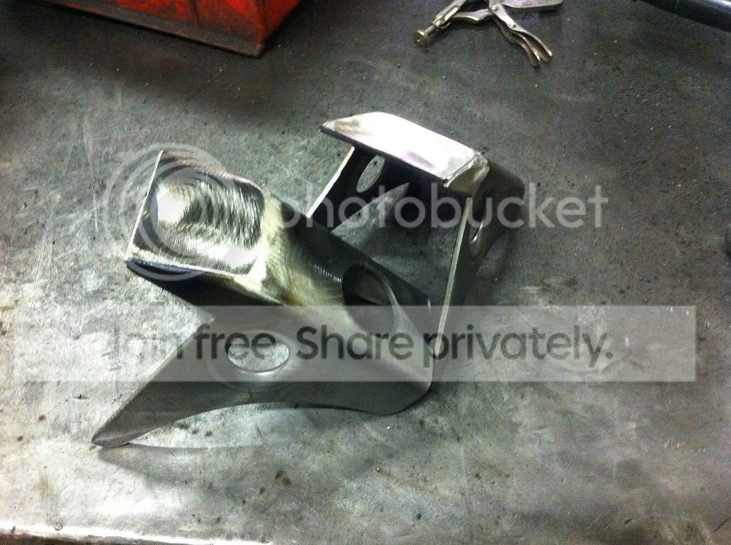

add one of these,
tacked in place,
rinse and repeat,
apply to frame with generous amounts of weld mixed in,

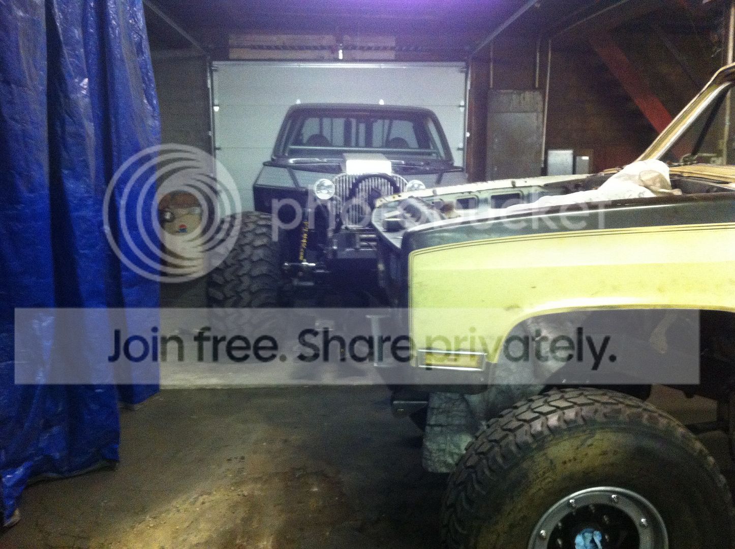

Fender fangs removed.
Stomper's rig on 49's in the back ground.
Better side shot for the stance,

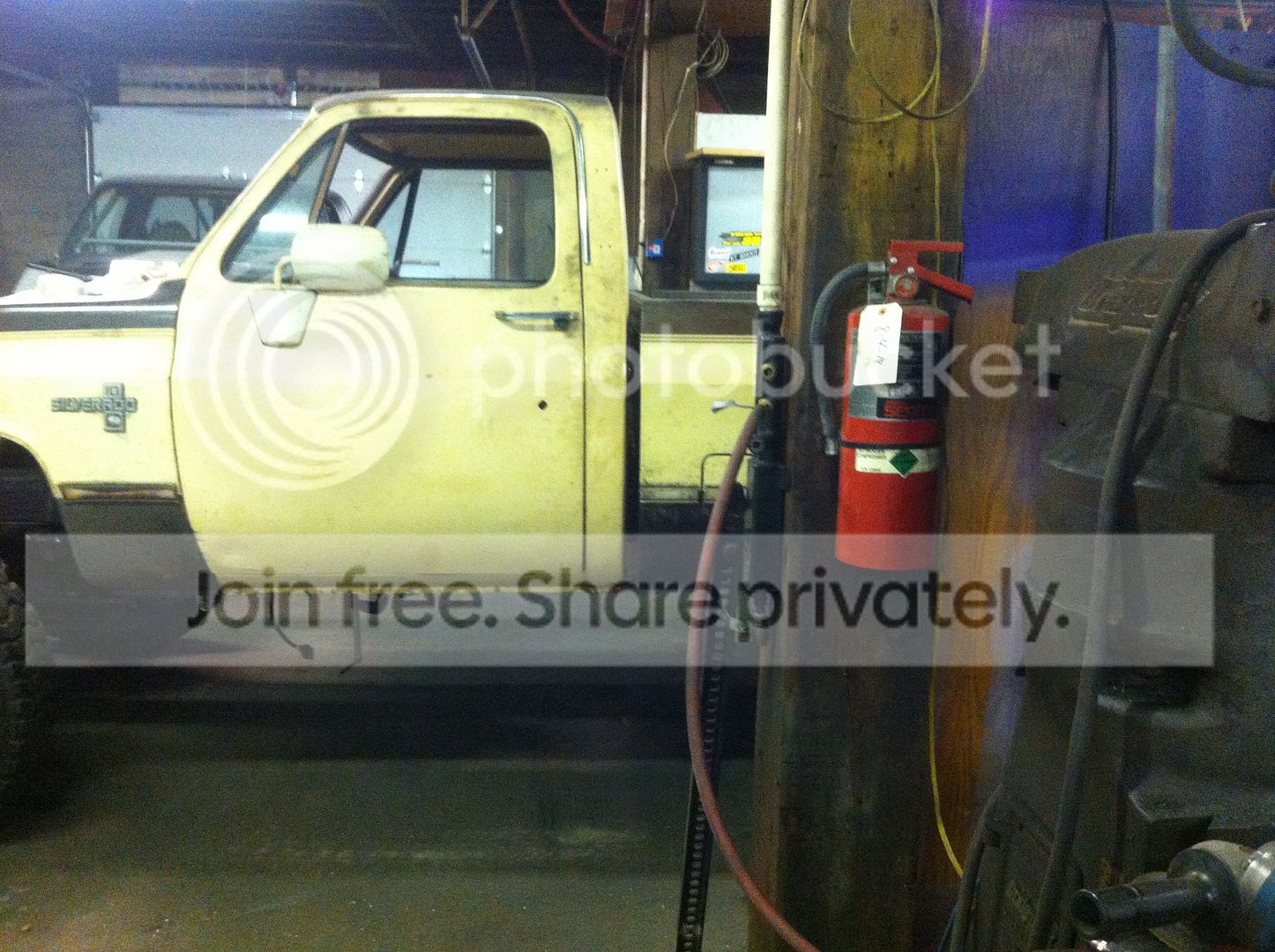

Starting in on the box mounting, How's that cab to box gap look?
Forward most box mounts
Got stuck here for the evening. Need another set of hands or a box lifting device. Might build the box lifter tomorrow.

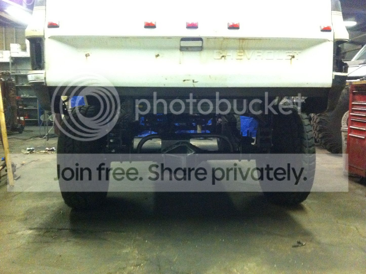

Shot from the rear just because...
