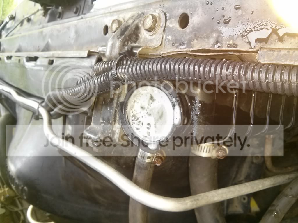

Time to do some shake down! I noticed the radiator cap was leaking, which I replaced with a new cap that also leaked, which I replaced with a new cap that did not..... (to be continued)

Now that that stuff was all replaced, the shake down continues. Remember when I said my radiator cap leaked? Well at this point it didn't leak per-sé, but it would vent water into the overflow until it was full.... uhh ohh
Poo.....

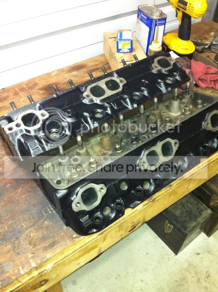

So..... a new set of heads it shall be. A good friend of mine in Austin has a set of camel humpers he's currently in the middle of porting for me. Just casting flaws and bowl blending, as well as new seats and guides
Roughed in, but you get the idea

DING!!!! heads are done! (These are a set of 624s. The camel humps will not be used)

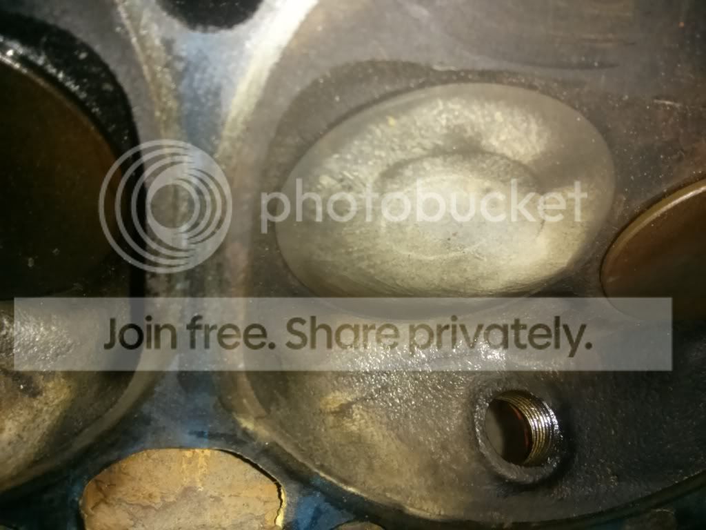

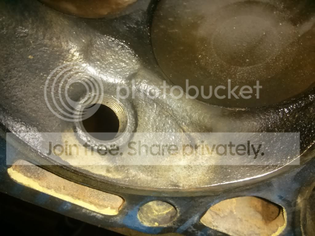

New heads are going on, as well as top end gaskets, seals. Etc. I was hopefull we would find the undeniable culprit of the cooling system getting pressure, AND WE DID.....

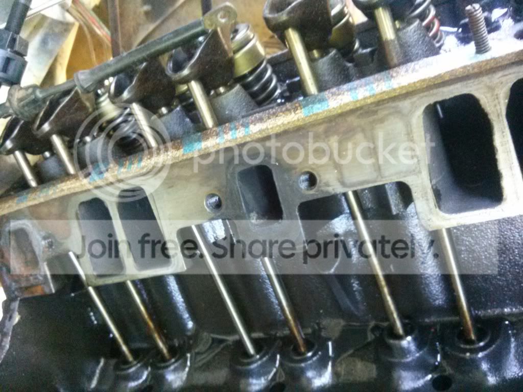

Tear down. Pretty damn clean

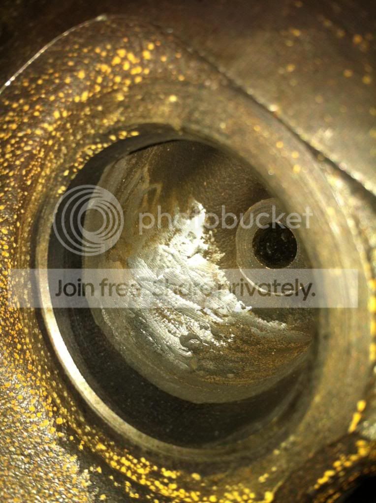

Bang. #4 with a crack
#2 with a canyon
Now, we learned that this is a .080 over block. No bueno. Ive got my eye on a. Fresh, never run .030 over vortec long block, that ill pick up tomorrow, or the coming week, as a spare.

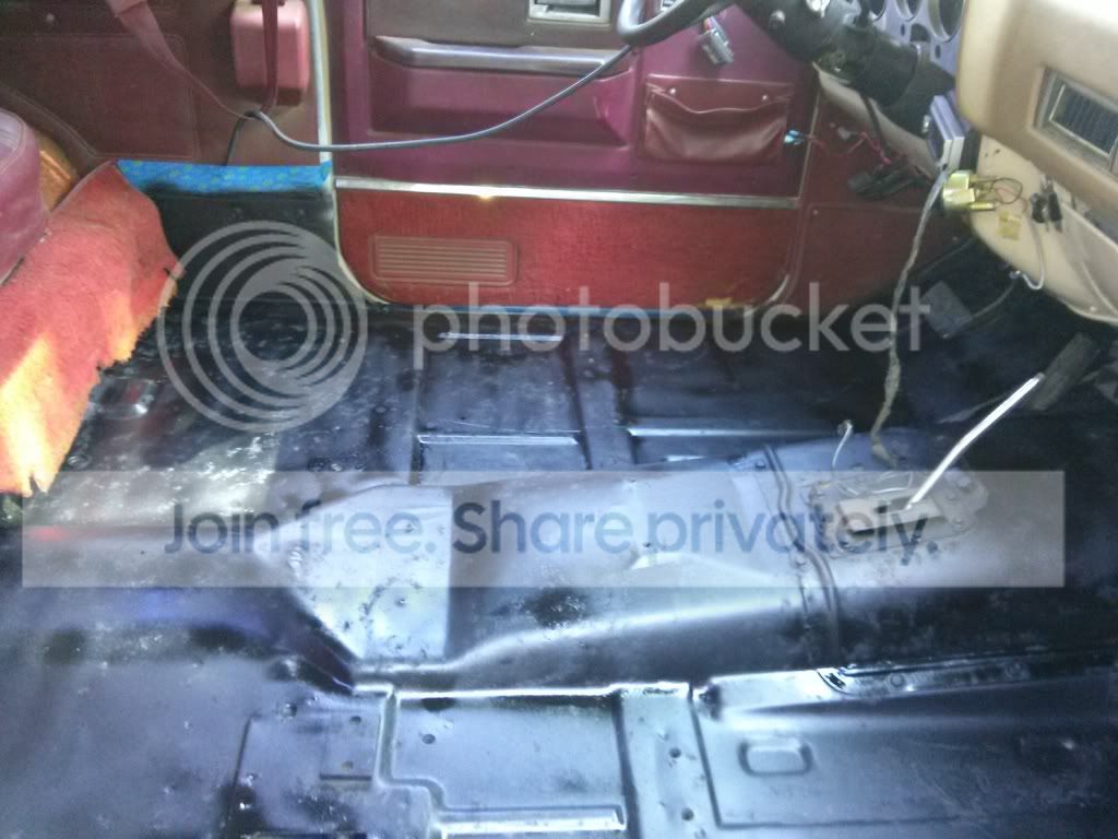

Started some stuff today-

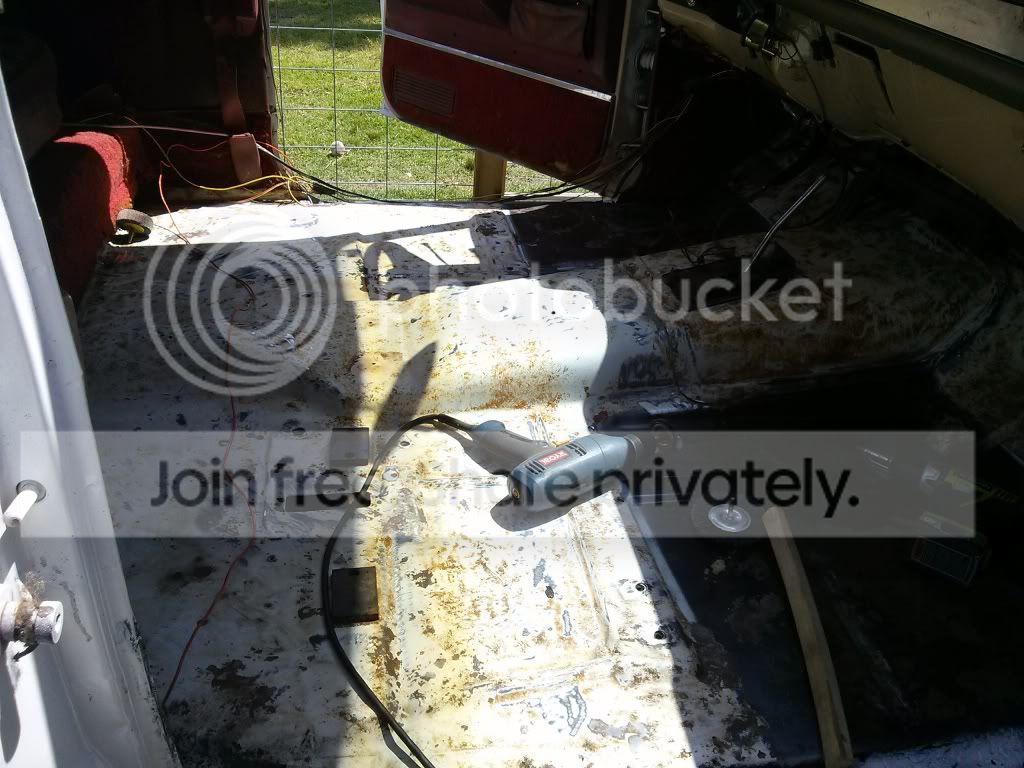

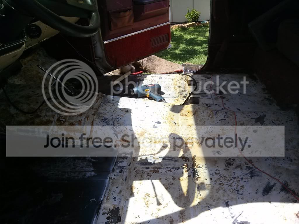

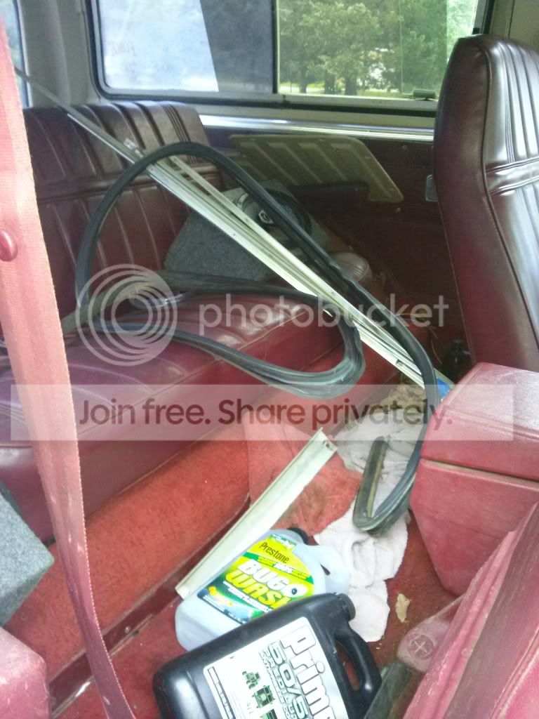

Dude, bro...... this was a little more of an undertaking than i thought it was gonna be..... SCREW THIS CARPET MAT STUFF
And finally..... yeah, the back will be done too. Gotta wait till next weekend (my weekends are thrus/fri)

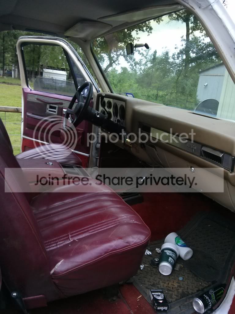

Okay, i also had a thought.... the sheetmetal dash has been done to an expinential degree.... im thinking stained 1/8" birch plywood.... im gonna think about it, feedback welcome.
Id use it for headliner. Lower door trim panels. Dash (similar to ryokens design, just wood) maybe even a center console. Interior bedside panels, you get the idea
I have yet to see anyone's homebrew interior that looks as nice as the stock interior.
Martin
i try to steer away from wood on vehicles just because of the fact it will break down faster, but staining it will help.....i dont know im sure it could look cool and its something that no one else has done (to that degree) but i myself would go a different route. But its not my k5 :thumb:
Yeah, im starting to think the wood would look cheap. Meh. Maybe regular sheet metal and ill powdercoat it. Ive got a color called black chrome that might look pretty cool. Ive also got a power that precisely matches the oil rubbed bronze color i used for the two tone. Its called like antique penny, or something to that effect
