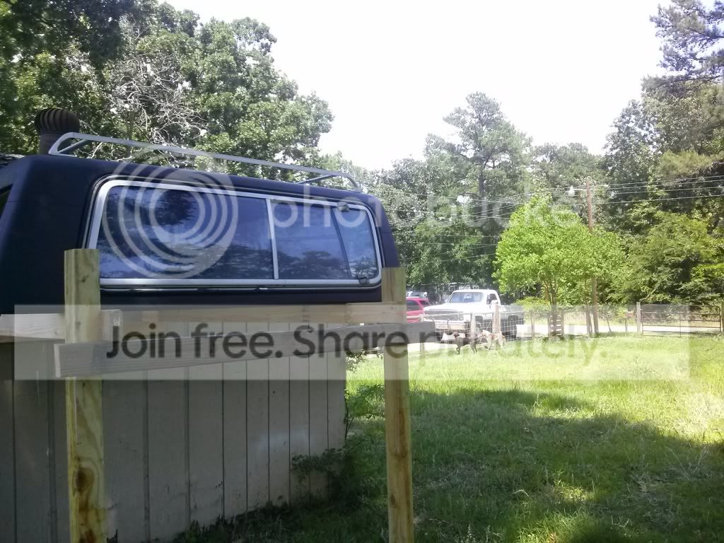

The idea is straight forward. Back up in between the posts, and shed, crawl into the back andlift up the shell while your pregnant fiancee slides the 2x4s underneath. After its up just pull out from under it, and zip a couple screws into the cross rails to help hold stuff in place

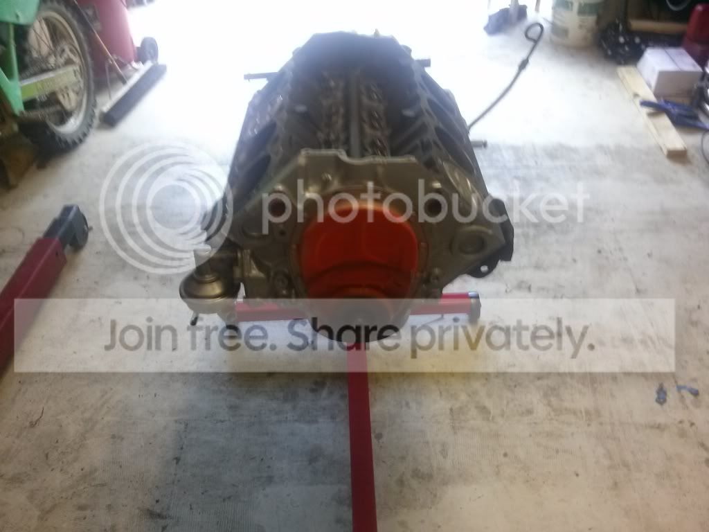

New motor is underway-

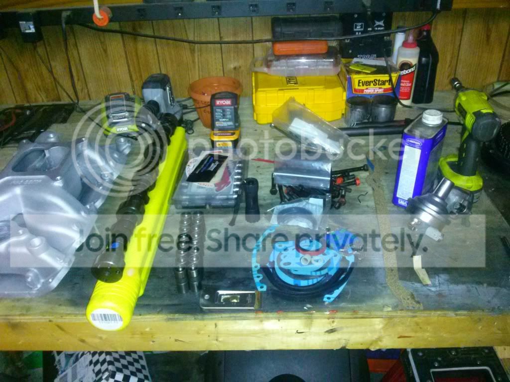

Goodies-

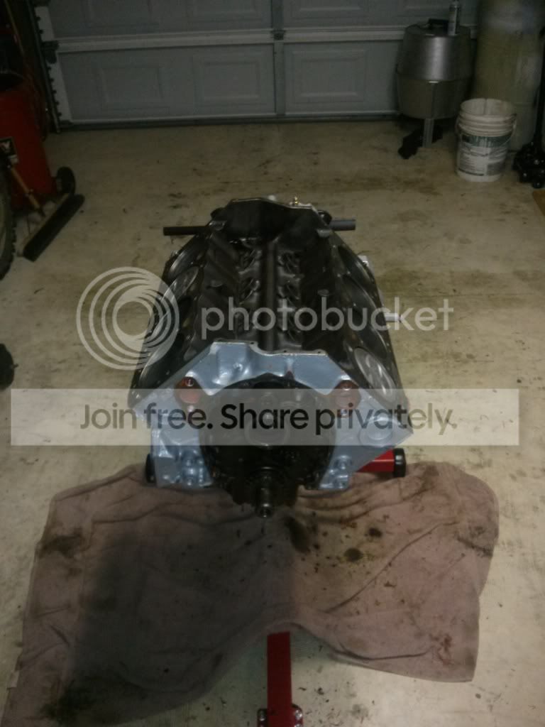

Removed the stock cam, and cleaned most of the gasket surfaces. Tomorrow cleaning will continue, and when i am satisfied, the new cam will be installed, along with the swirl port heads, and air gap intake.
looking good man, make sure you cover the lobes of that cam with something that wont drip off until you start it!
Yeah, they sent me some break-in lube with it. Just doesbt seem like theres gonna be enough of it. Guess well find out. I was really wanting to slather the sh!t on, but i guess id have to buy some in that case.
Use a distributor, minus the spring weights and cam gear, and prelube the hell outa that thing. Me personally, I just did that for the first time here recently, I usually use the starter to prelube, but its a good idea. Make sure you read the break in of that cam right, usually you have to run them right off first fireup to around 2000 rpm and hold for around 10 to 20min or so. Crazy on a cold new motor I would think, but they say its ok.
