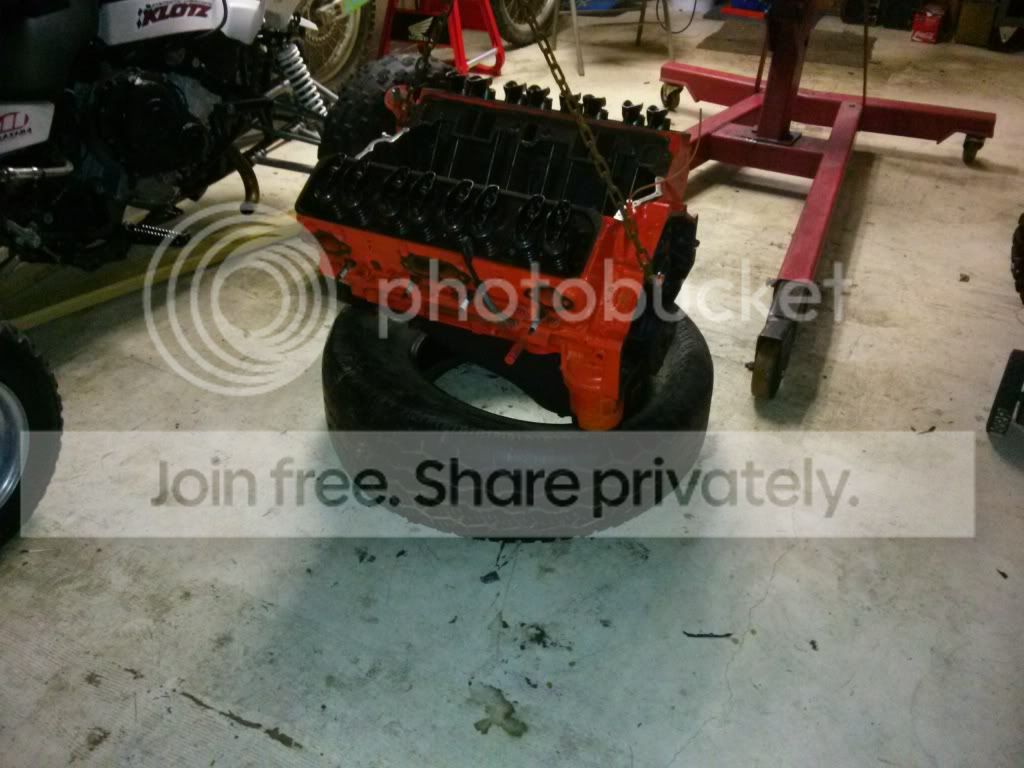

New motor. After unloading it the other night.

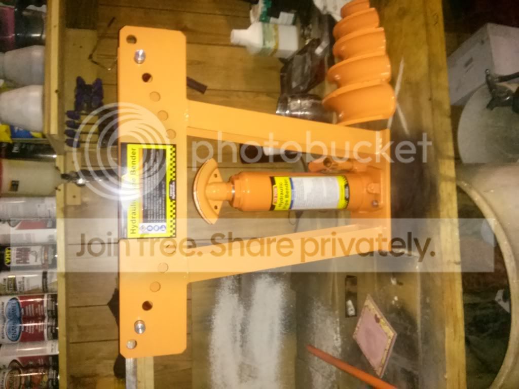

Ahh well that makes sense. The pipe i bought is 3/4", with a 1" od. (Thereabouts)
Yep. Pipe is designed to flow fluids/gas so size is determined for flow rates etc.
Tube is more structural based. Sorry I work for a plumber lol

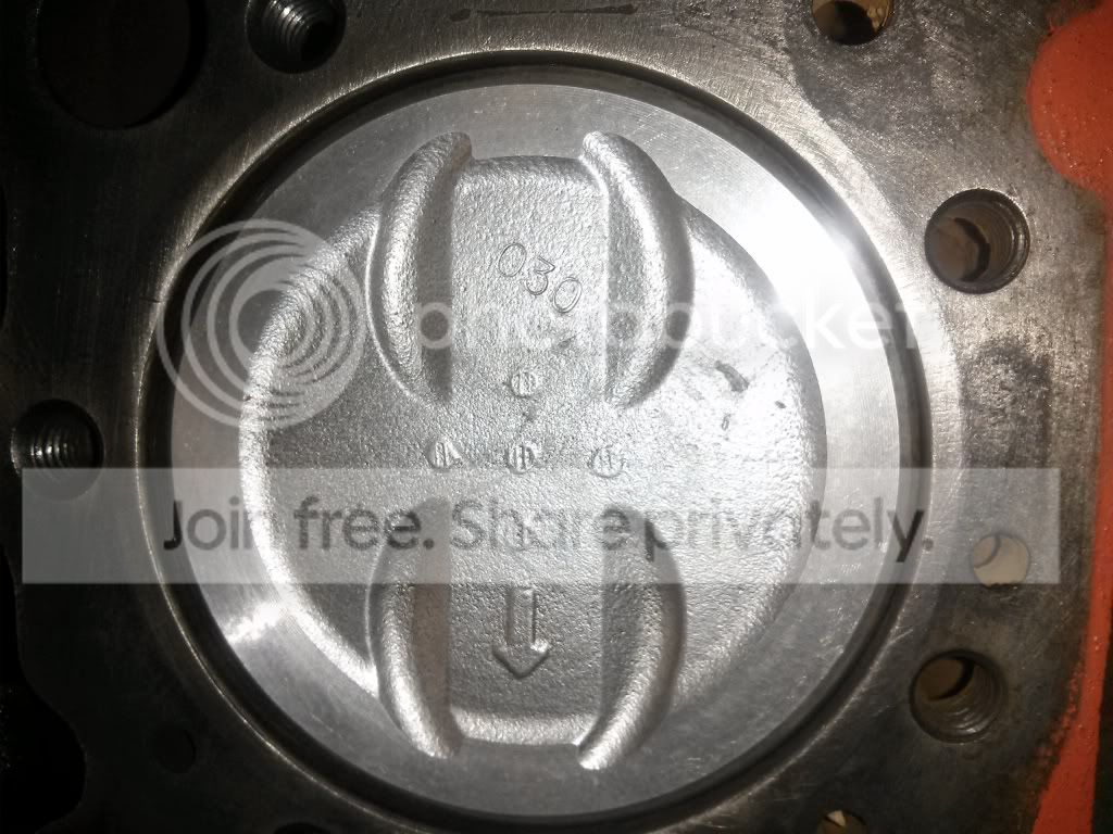

sorry if i missed it but what are the specs on the engine? .030 over 350?
Yes. Its a .030 over 350. I think that puts it at 355. Im currently in the market for a cam/lifter package. Itll be for swirl port heads (weak version of vortecs 87-95). What cam did you use? Specs? (Yours is a 400ci?)
