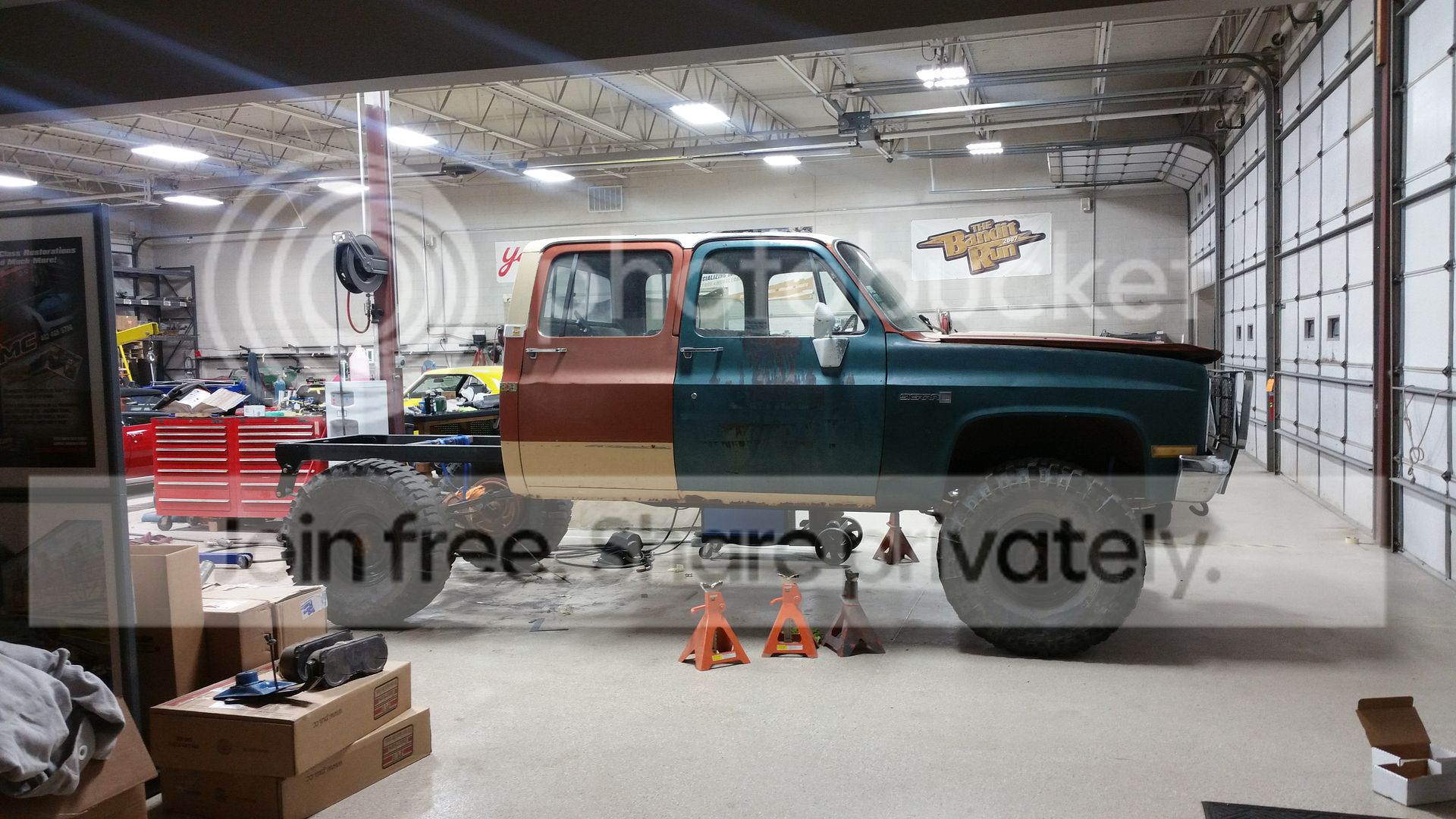

I've got the trans back in the truck now, I can throw the front driveshaft in and get a picture for you

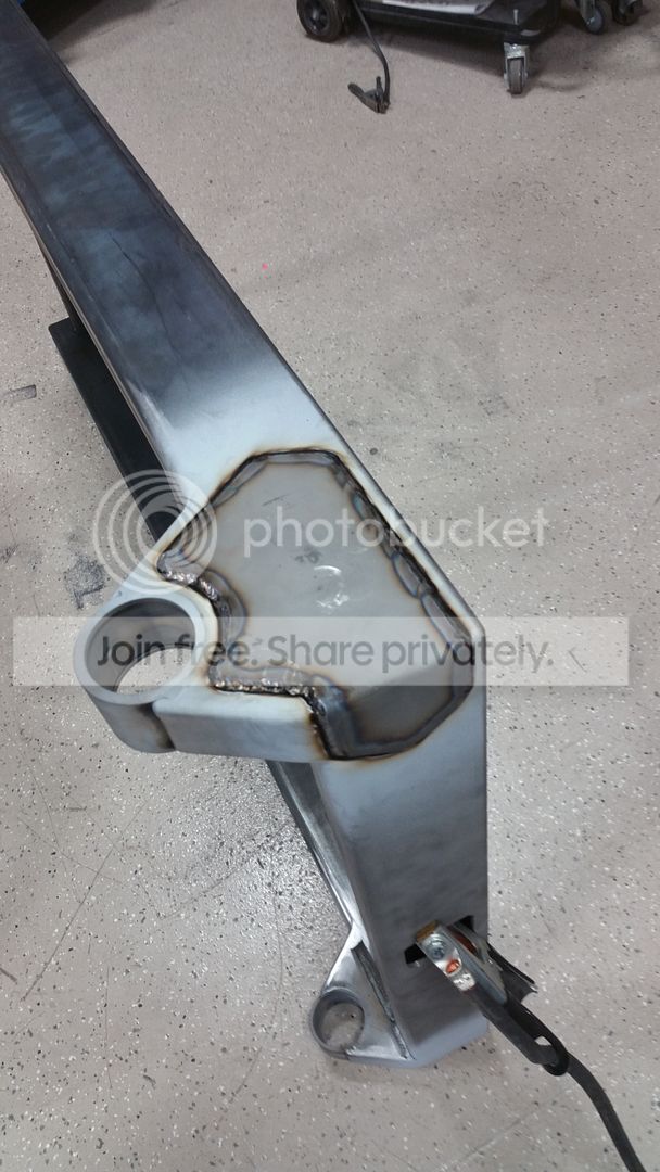

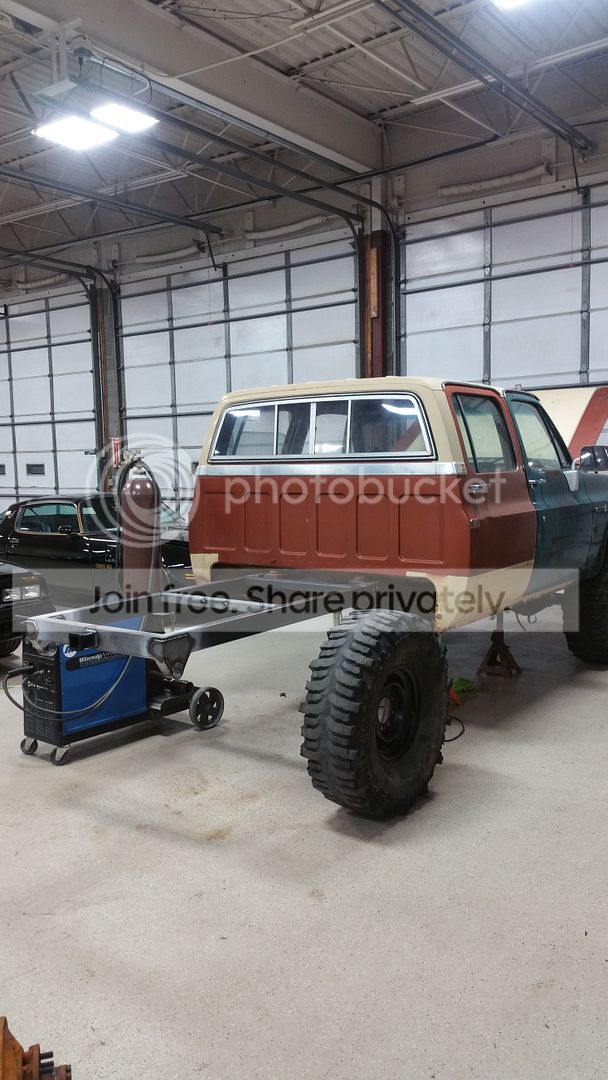

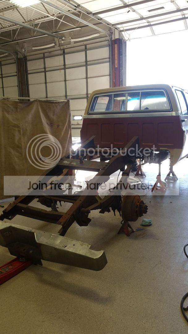

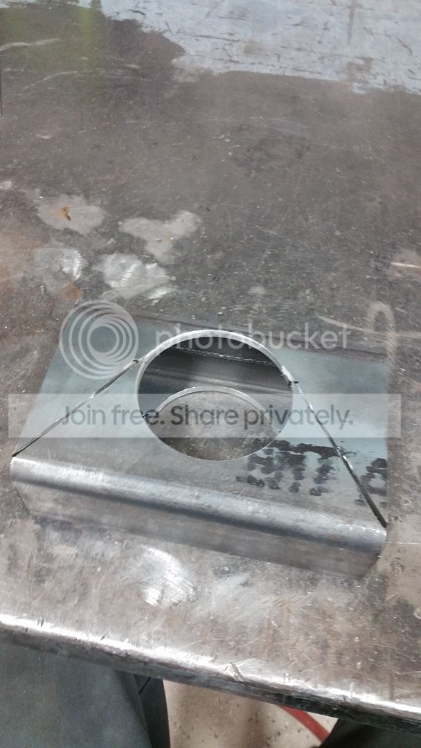

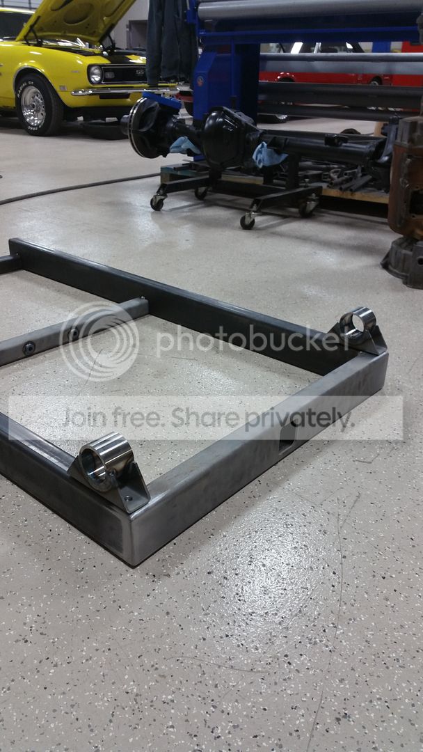

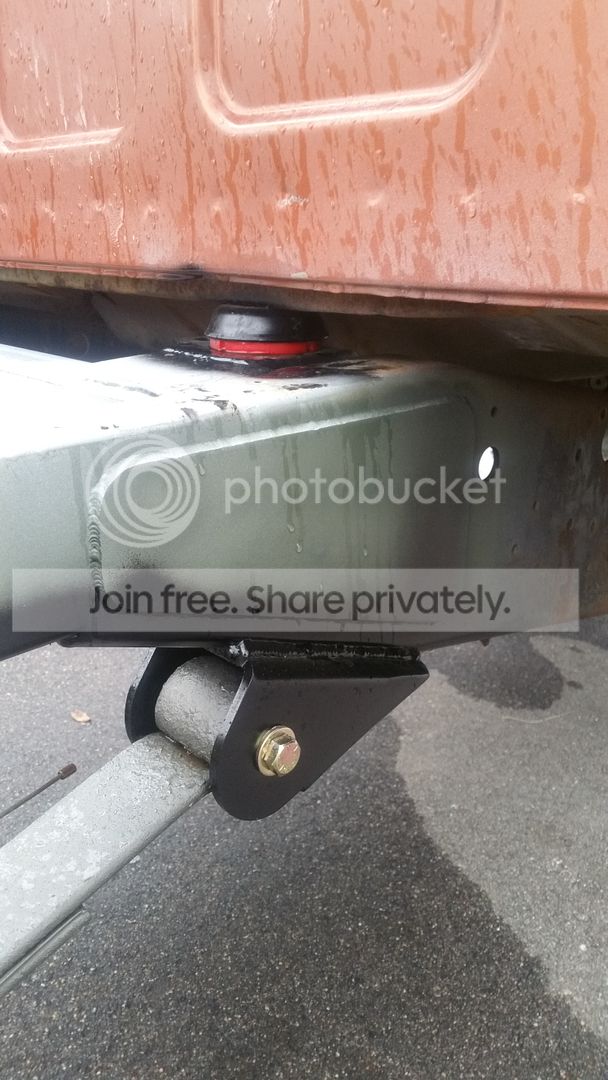

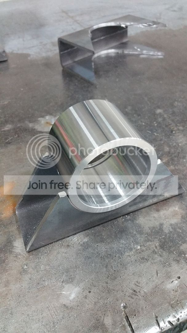

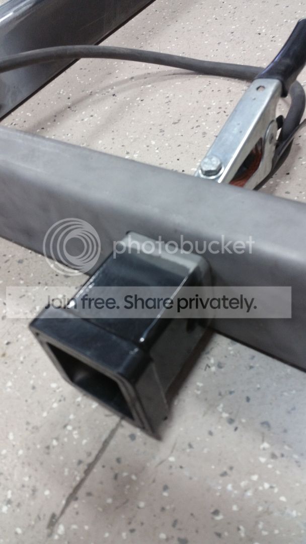

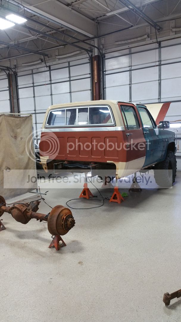

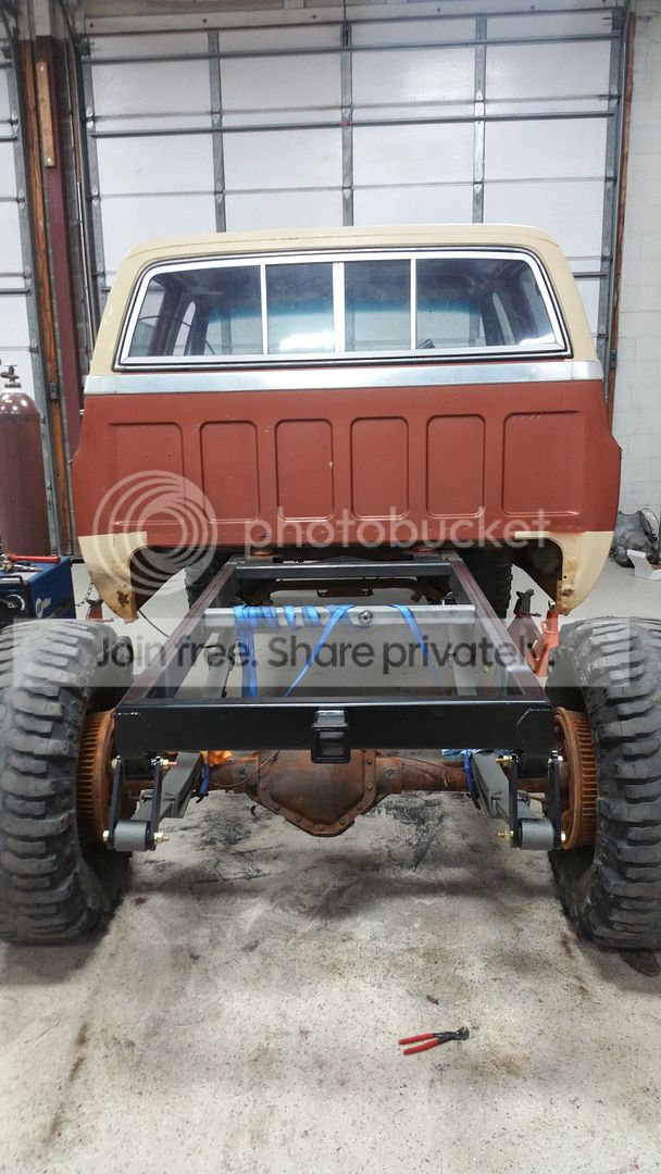

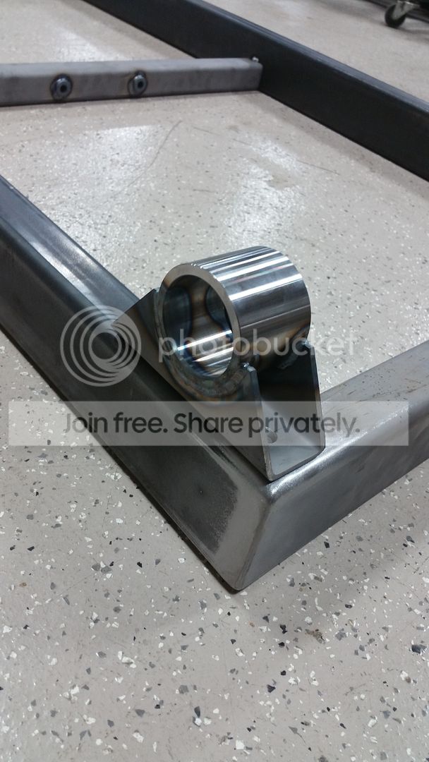

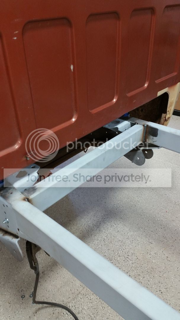

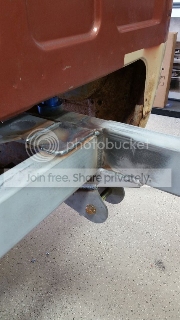

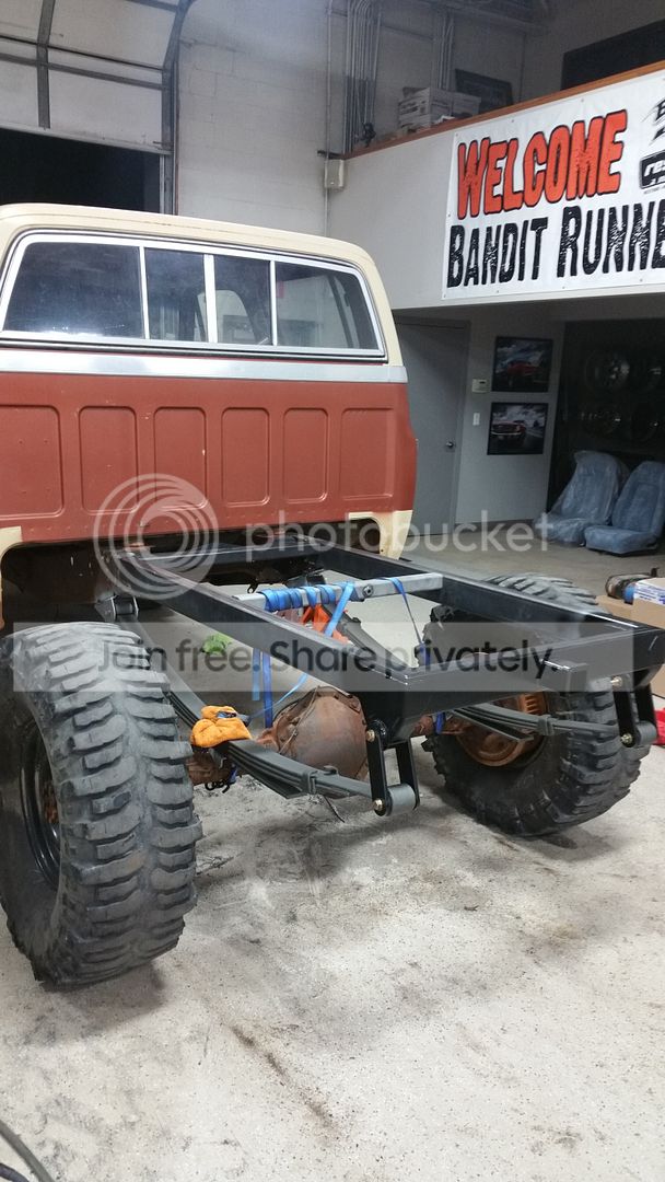

Here are a few pictures of the new rear frame. I wanted to get the wheelbase as close to a regular cab long box as I could without looking odd. The frame is 2x4 .120 tubing, I used 63in 1/2 ton springs with ballistic fabrication front spring hangers on the bottom of the frame rail and creeper joints in the rear with 6in shackles. Incorporated the inboard shock crossmember into the k5 gas tank mount. The front crossmember is tied into the body mounts. The current wheelbase is 141, but that will change when I do my 52in front swap and move the front forward.

I'm gonna ditch the frame back there too.
But I will end up being longer than you

Get those fronts working good and that thing is gonna be awesome.
I like flex joints in the rear suspension but I know a couple guys who have complained about some shifting.
Interested to see how you like em
