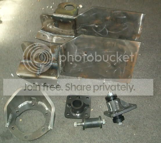

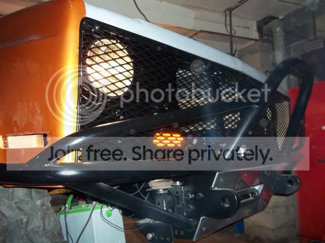

Nice I need to check out your build moreme likey.... I started out similar on mine....
I have both. I'll probably run the 52s for now. I haven't heard much about 56s up front and how the act on the streetthanks.. that was actually the K5 bumper.......
I went with a much simpler mounting on Mutt's bumper build....
