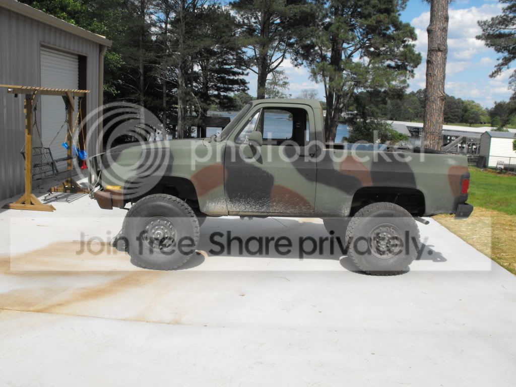

82 K5-Texas4x4rebels. Thinking about parting out the K5

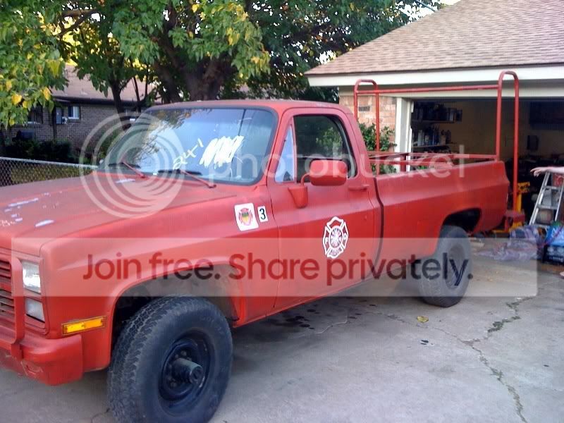

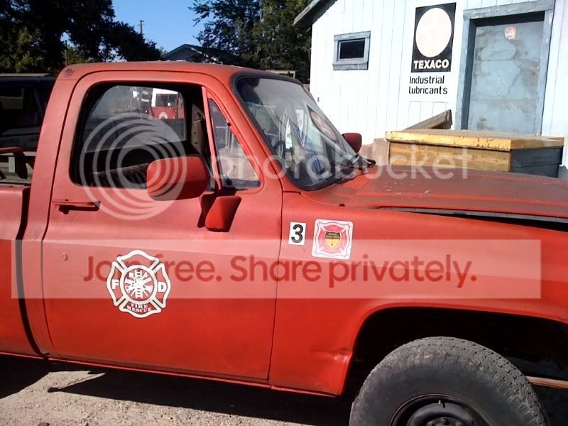

Went and picked up the m1008 today got there and found out it had been used at a fire dept in Oklahoma it runs but has no batteries or glow plug card.
So the parting out will start soon. It looks like a drunk blind guy did the paint job on it.
Nice Find. What was the cost if you don't mind me asking.
Yup 1500 was the price hope fully this week I can get the trans and transfer case out and get the motor ready to pull the Odometer reads 13XXX miles and the engine ran like a champ.

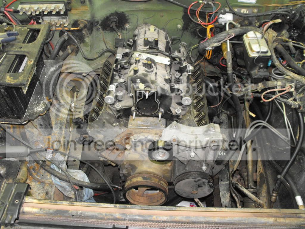

I like your K5!!! I am in the process of putting a LQ9 in my M1009. I am glad I found your thread as I was worried about the front crossmember and I didn't want to move my trans either. I am going to try and put a EFI sending unit and a 96 vortec pump in mine so we will see how that fits. How does the 5.3 do in the blazer? Here is a few pics of mine.

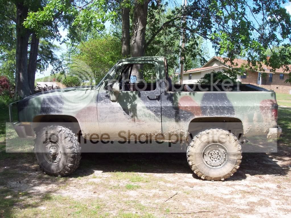

The 5.3 is great I love the fuel injection finally got the small kinks worked out and its even better then when I first got it running.
What size lift and tires are you running are you using spacers with the h1s I gonna be making some changes to my lift my springs are sagging bad on the left side about a inch or inch and a half compared to the right.
The lift is a set of 4" springs in the front with a 1" zero rate and 4" blocks and a zero rate in the back. I need to get a shackle flip for the back and do away with the 4" block soon. I have the 2" spacers front and back. The tires with the 12 bolts are the H1 MT's ( 37x12.50) and the ones on the 8 bolts are 38" TSL's.

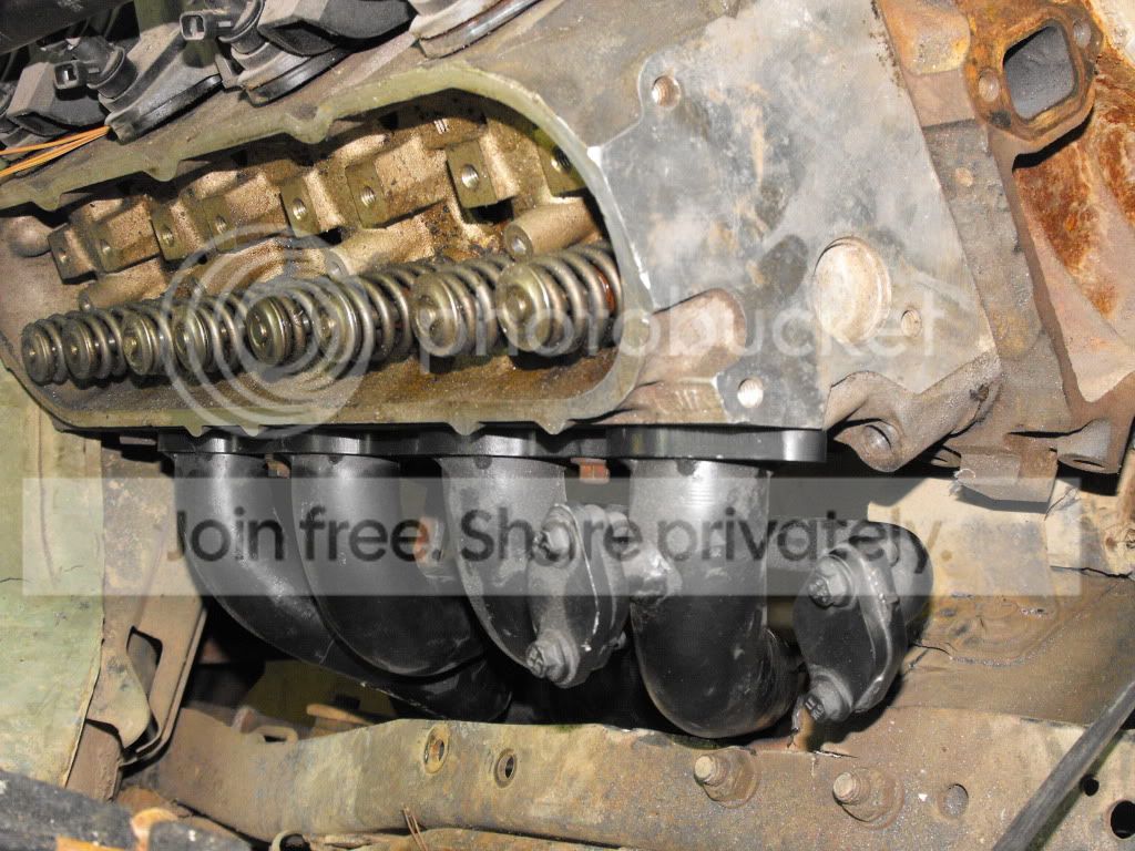

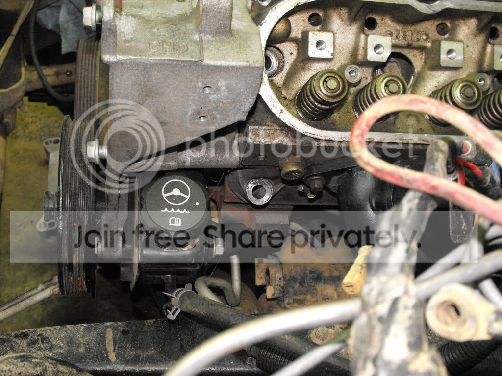

I take it your motor sit this far back? I ordered the carshop inc plates witht eh 1" setback as I heard they would work as well. It is just sitting in there right now as I am waiting on the plates.
That looks pretty close to where mine is take that accessory bracket off it will help when you finish dropping it in. What headers are those?
It is in there, I just put the acc bracket on there to see if there was any issues. I am waiting on my motor mount plates to get it set on the mounts. Those are Mac Mid's for a 98-02 fbody, they are the most universal header you can buy. The driver side went right in and the passenger side just needs a little removed from the frame and motor mount stand.
