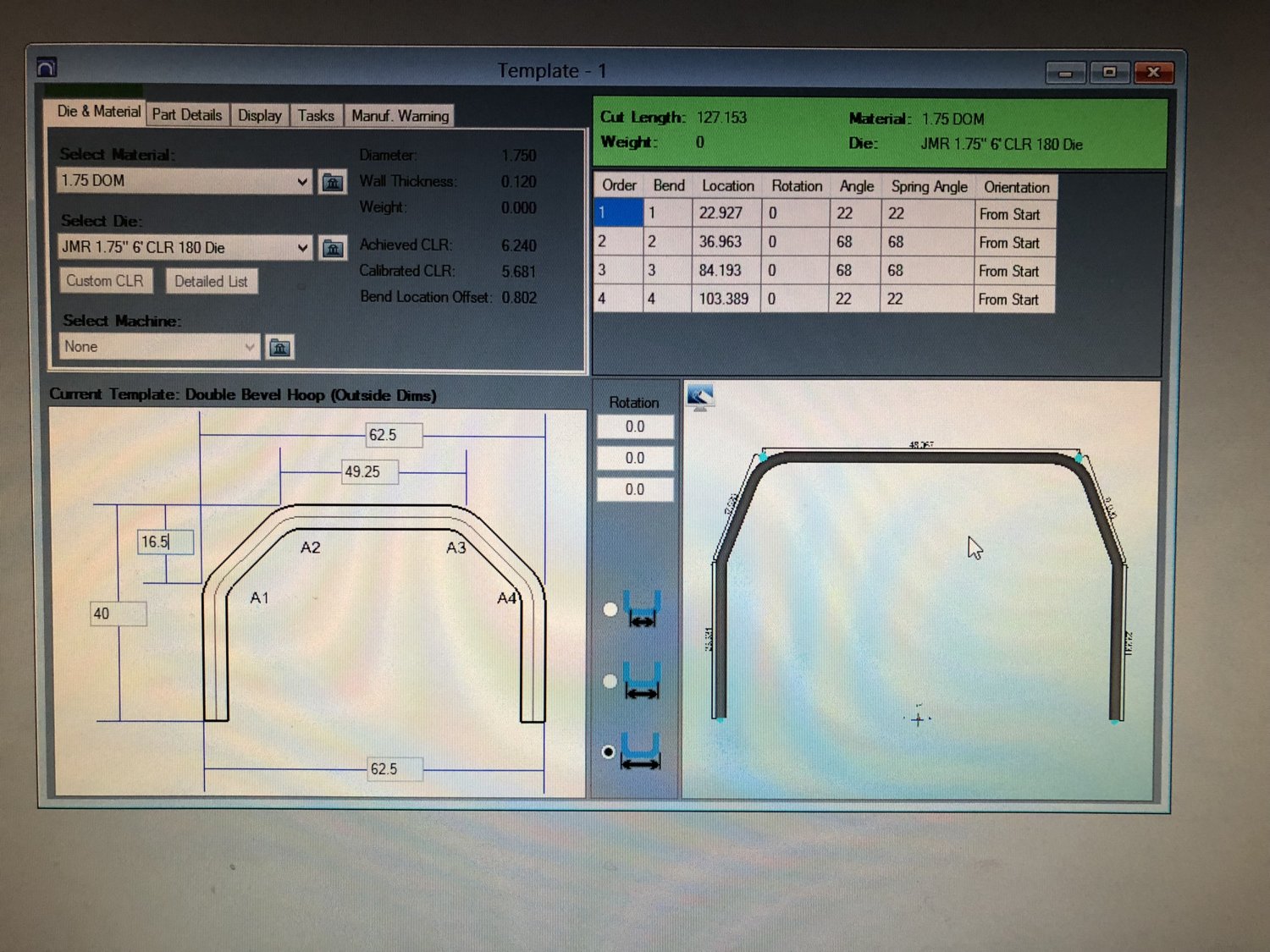

You have to keep in mind that the software is calibrated for a particular die, a different die will change the locations you bend at.
It only shoots back if I miss first right?

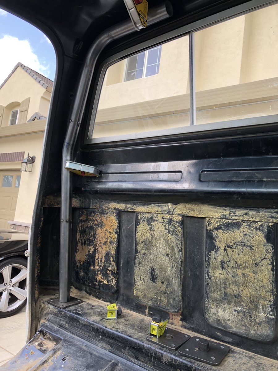

Another thing keep in mind is welding. You will likely have top punch holes through the floor to get to some of the joints. Might be able to lean them far enough forward to do it, if you built a halo you could likely lean it all forward to weld it.
I really like to get the seats in and done before starting on a cage. That way you can absolutely verify where your head is vs where the cage is.
